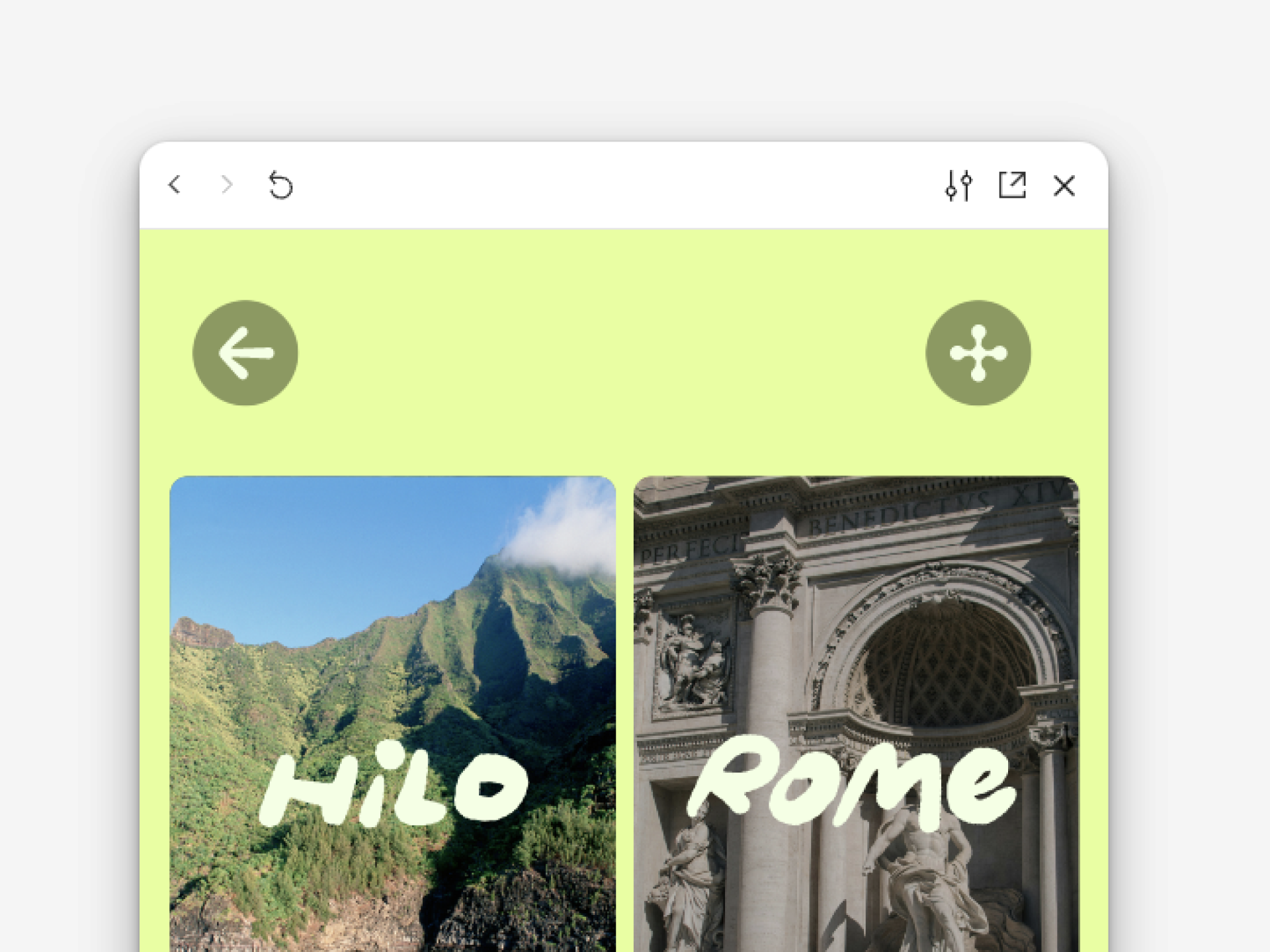

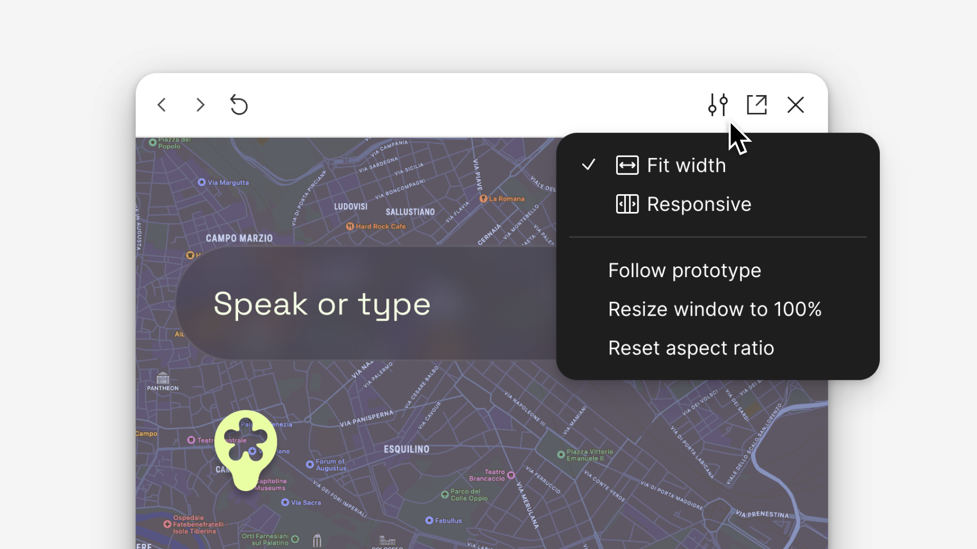

From inline preview, you can:
- Use the left and right arrows to navigate back or forward through the prototype.
 - Restart the prototype from the last selected frame on the canvas. You can also press R to restart.
 - Open the overflow menu to choose from different scaling options for your prototype.
 - Open the prototype in presentation view in a new tab.
 - Click the X to close the inline preview.
 - Resize the preview by clicking and dragging the edge of the preview window. Hold ⇧ Shift to scale it proportionally.
Overflow menu options
The overflow menu for the inline viewer contains different scaling and view options for your prototype. The options available will vary depending on whether you have a prototype device selected. Some of these options overlap.
Fit width
Scale the prototype so it fills the width of the display. Available only if the prototype device is set to No device or Presentation on the page.
Responsive
The contents of the prototype will resize and re-layout as the prototype viewer resizes according to the constraints and auto layout properties applied to the design. This allows you to view designs at different window sizes and check their responsive behavior. In order for Responsive to work, there must be constraints and auto layout settings applied to the design.
Follow prototype
The selected frame on canvas updates to mirror the current frame in inline preview. As you navigate through the prototype in preview, your canvas selection and position will follow.
Resize window/device to 100%
Resizes the viewer or device to 100% of the frame size.
Respect aspect ratio
The inline viewer window resizes to match the aspect ratio of the current frame. Available only when a prototype device is set to No device.
Show device frame
Show or hide the physical device frame. Available only when a prototype device frame is selected.

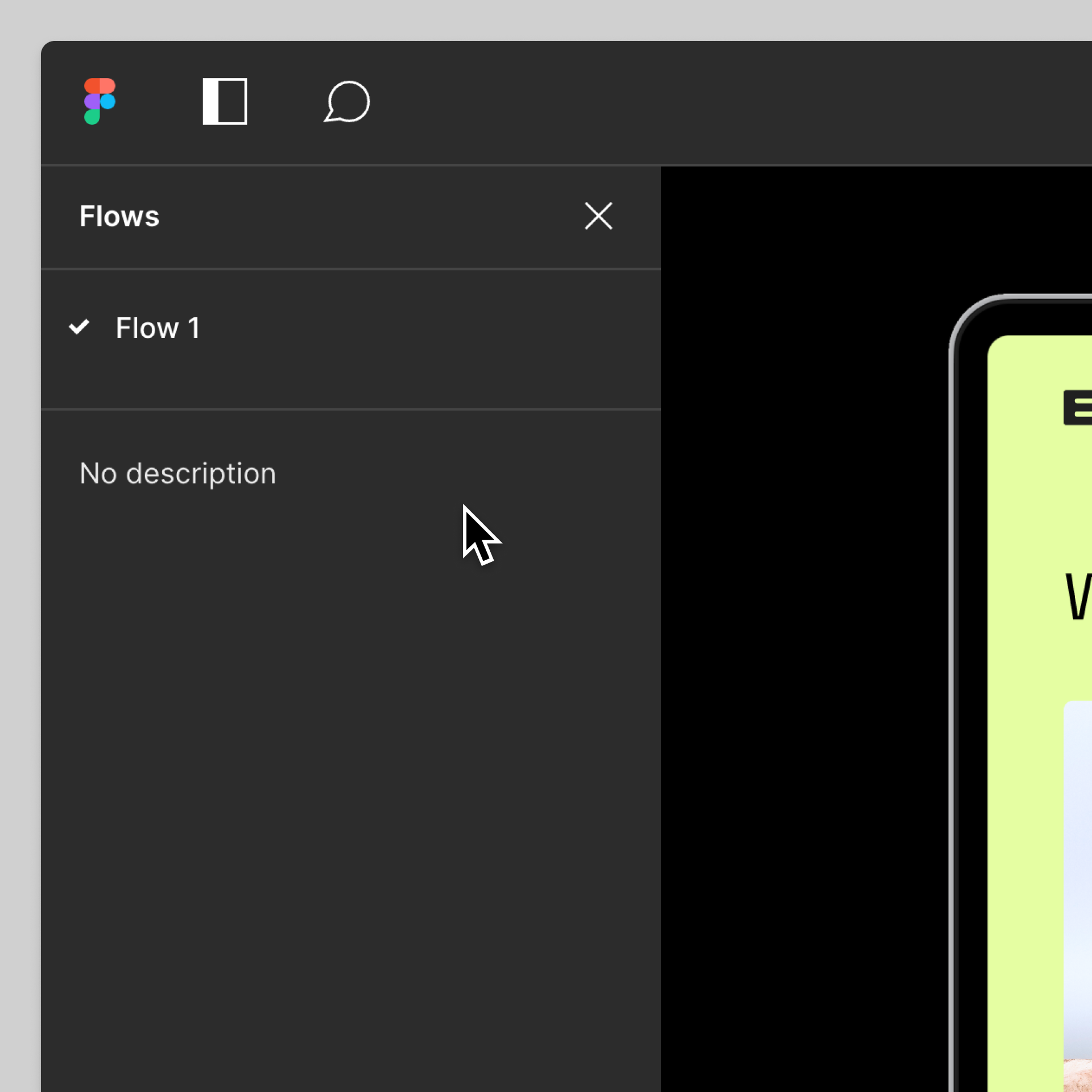

From the left side of the toolbar, you can:
- Click the Figma logo to go to the file browser
 - Click to show and hide the left sidebar, where you can select flows and view their descriptions.
 - Click to enter comment mode and add comments to the prototype.

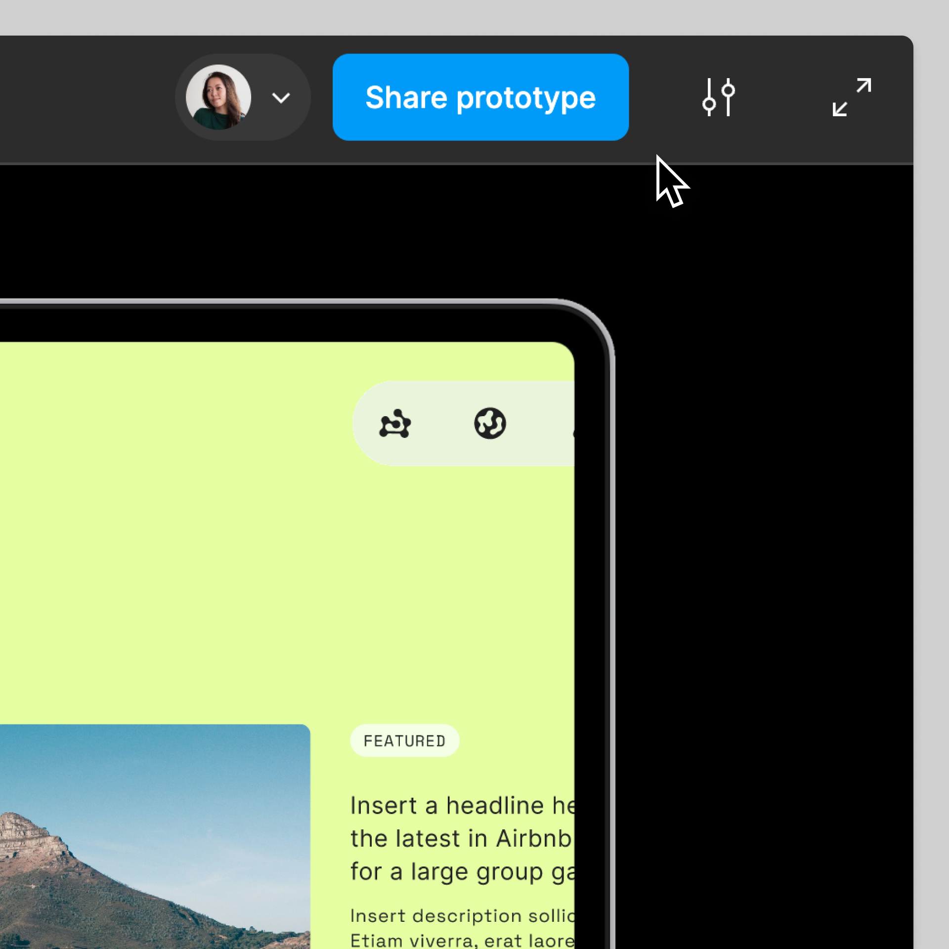

From the right side of the toolbar, you can:
- Click the arrow next to your avatar and choose to spotlight yourself or follow a presenter
 - Share the prototype
 - Open the options menu to select different settings for the prototype.
 - Click to enter fullscreen mode.

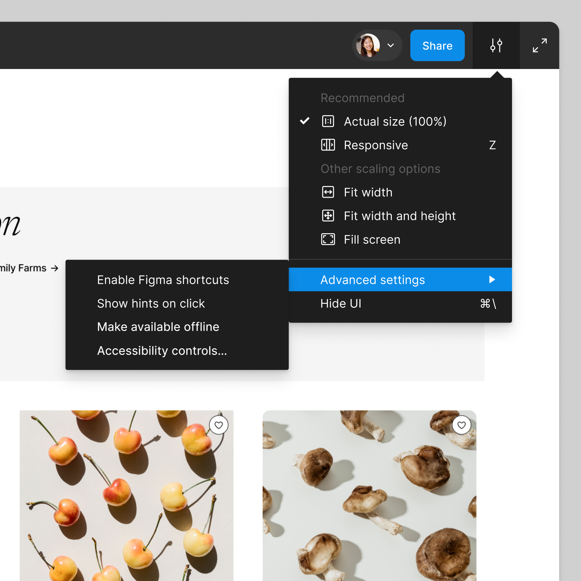

Options menu
Click to open the options menu for additional settings.
The following options are always available:
Enable Figma shortcuts
Enable Figma keyboard shortcuts, such as:
- C to open comments
 - F to enter fullscreen
When enabled, users can navigate through prototypes with keys, such as the left and right arrows on their keyboard.
When disabled, users can only navigate through prototypes by clicking through hotspots or clicking the left and right arrow icons at the bottom of the screen.
Show hints on click
Hotspot hints help guide users through a prototype. They show where the Hotspots are in the prototype. When a user clicks outside of a hotspot, Figma highlight any clickable areas with a blue bounding box.
Make available offline
Preload your prototypes so you can present them while offline.
Accessibility settings
Accessibility settings help those with disabilities access and interact with a prototype. For example, those with visual impairments can adapt a prototype for screen readers and other assistive technologies.
Hide UI
You can choose to show or hide Figma's prototype UI in presentation view. This is useful when you're testing a prototype and want to avoid any distractions.
When you hide the Figma UI in presentation View, Figma will:
- Hide the toolbar and footer on your current view.
 - Hide the flows sidebar if Show sidebar is checked in the Options menu.
 - Update the prototype URL with a
&hide-ui=1variable. - Remind you how to restore the toolbar and footer.
 - Allow you to copy the updated share link. If you share this link, Figma will hide the toolbar, footer, and sidebar for any other viewers.
Note: Adjusting some settings in the Options menu will update the URL for sharing the prototype. Make sure to copy the new URL if you make any changes.
The options menu also contains content and device scaling options to determine how your prototype or device frame displays and resizes. The types of scaling options available depends on whether you have a prototype device selected:

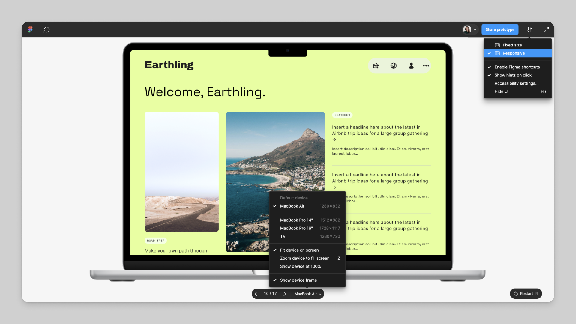

Scaling options with a device frame
With device frame, the options menu provides Responsive and Fixed size scaling options.
Responsive
Fixed size
Shows the design at 100% within the device. Depending on the frame and device size, this may result in a cropped prototype. You can control the size of the device with device scaling options.

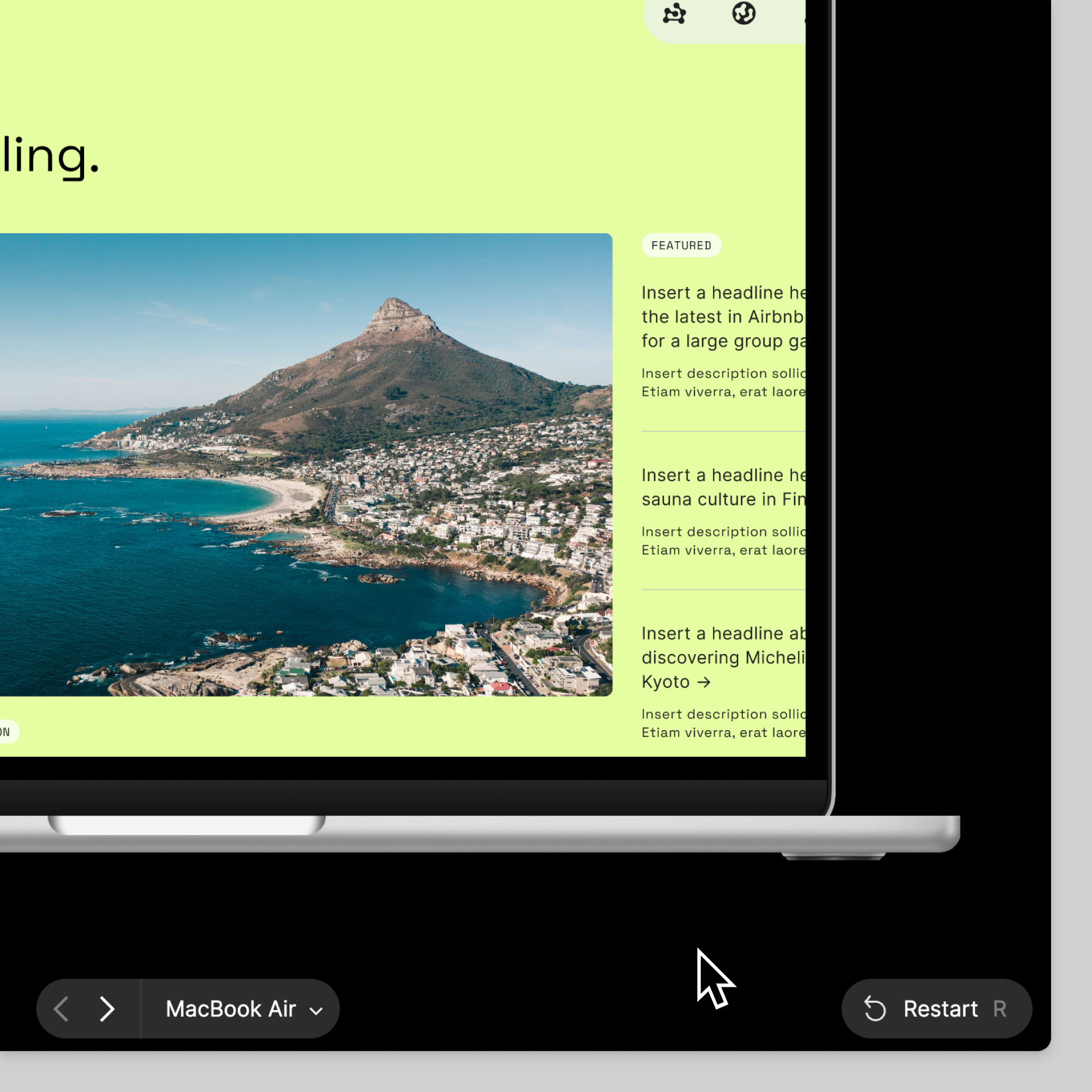

If you have a prototype device selected, the device switcher becomes available at the bottom of presentation view, which allows you to choose prototype devices similar to the current one. It also has device scaling options for you to choose from:
Fit device on screen
Shrink the device frame so that it fits within the viewer window.
Zoom device to fill screen
Scale the device so that it fills the entire display.
Show device at 100%
Display the prototype at 100% of the frame’s size. Depending on the frame and the screen size, this may result in a cropped prototype.
Show device frame
If a prototype device is selected, this option allows you to show or hide the physical device frame.
Tip: Press Z on your keyboard while in presentation view to move between scale options.
