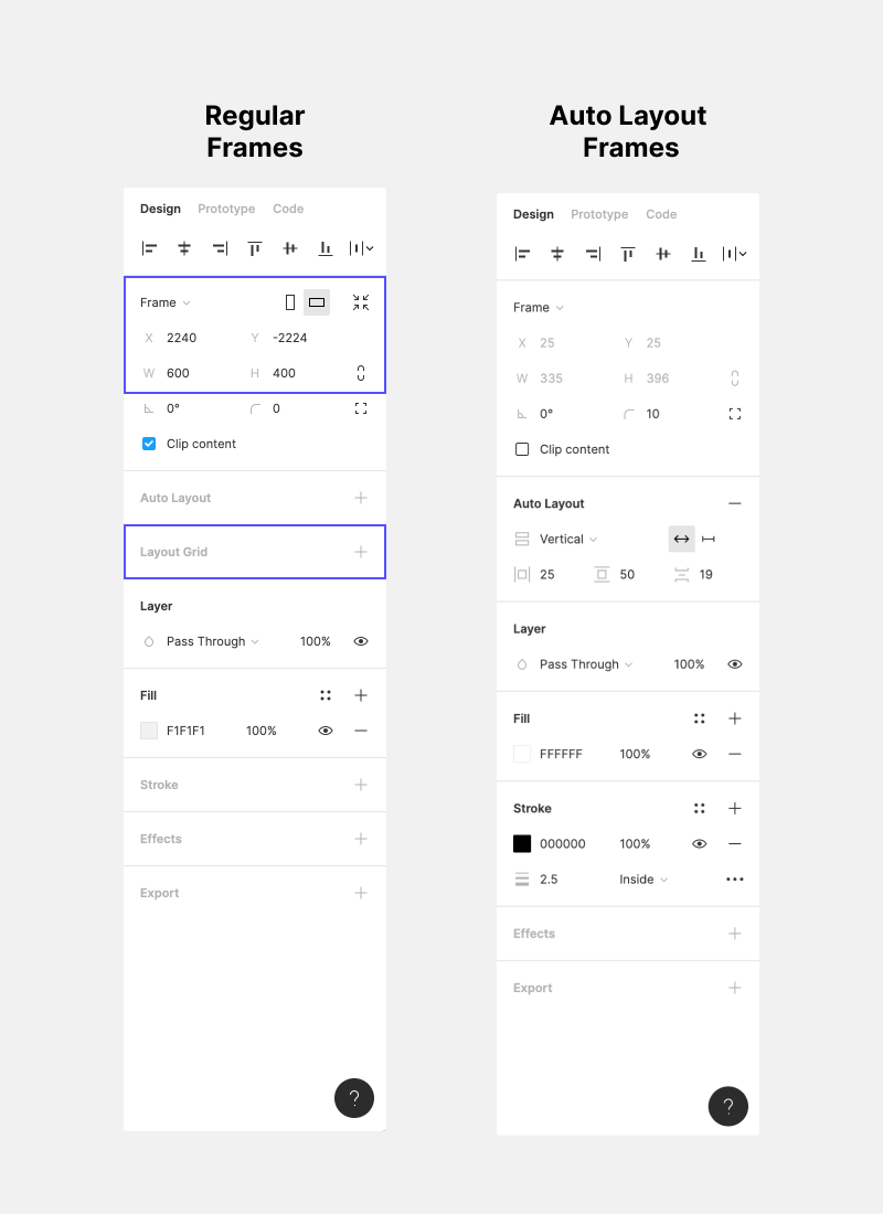

Note: Alignment, position and dimensions related to auto layout frames are different to the options we've outlined here. Learn how to adjust these properties with auto layout.

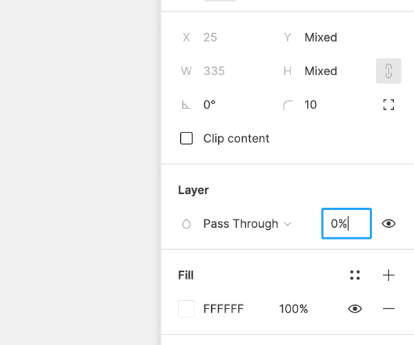

Adjust values
Equations
Some fields in Figma accept equations, this includes the position, dimension, and rotation fields.
You can use equations to resize layers by adding +
, subtracting -
, multiplying *
, or dividing /
the existing value. You can also use brackets (
within the field for more complex equations, or ^
for creating exponents.
We've added some examples below but you can use any numbers:
+ 10
to add 10 to the current value -
- 20
to remove 20 to the current value -
*2
to multiple the current value by 2 -
/4
to divide the current value by 4 -
^2
to create an exponent of the current value to the power of 2 -
(𝑥/2)+6
to divide the current value in two and add 6 (𝑥=current value) -
Mixed+100
to add 100 to two or more selected objects with different values
Equations can also be applied to a mixed selection of values. When an equation is entered into the position, dimension or rotation fields, the change will apply to all selected layers.
Note: You'll need to edit the field and add the equation to the existing number. If you only select the field and add the equation, Figma will replace the existing number instead.
Scrub fields
In addition to manually entering values, you can also "scrub" fields. Scrubbing allows you to quickly adjust a field's value by dragging your active mouse or touchpad.
You can use this for position, dimensions, and rotation fields, as well as other layer properties and settings in the right sidebar.
