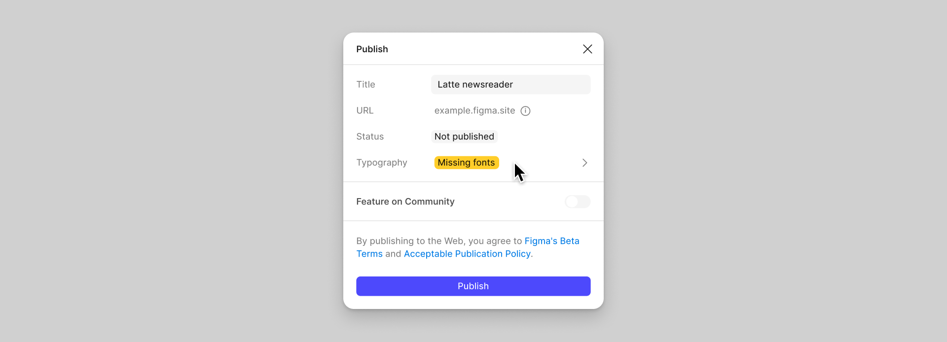

If your file includes custom fonts that require web font files, you'll see a Missing fonts warning under Typography when you try to publish.
To publish your site with a custom font, upload the corresponding .woff or .woff2 file so it displays correctly for visitors.
Tip: WOFF (Web Open Font Format) files are supported by all major browsers and are usually much smaller than desktop TTF or OTF files. Using WOFF or WOFF2 helps your app load faster and perform better.
Upload a missing web font to Figma Make
To check for missing fonts in your Figma Make file, click Publish at the top of the screen. If any fonts require web font files, you'll see a warning under Typography in the Publish modal.
You can publish without resolving this warning, but any missing fonts will fall back to the browser's default font on the live site.
