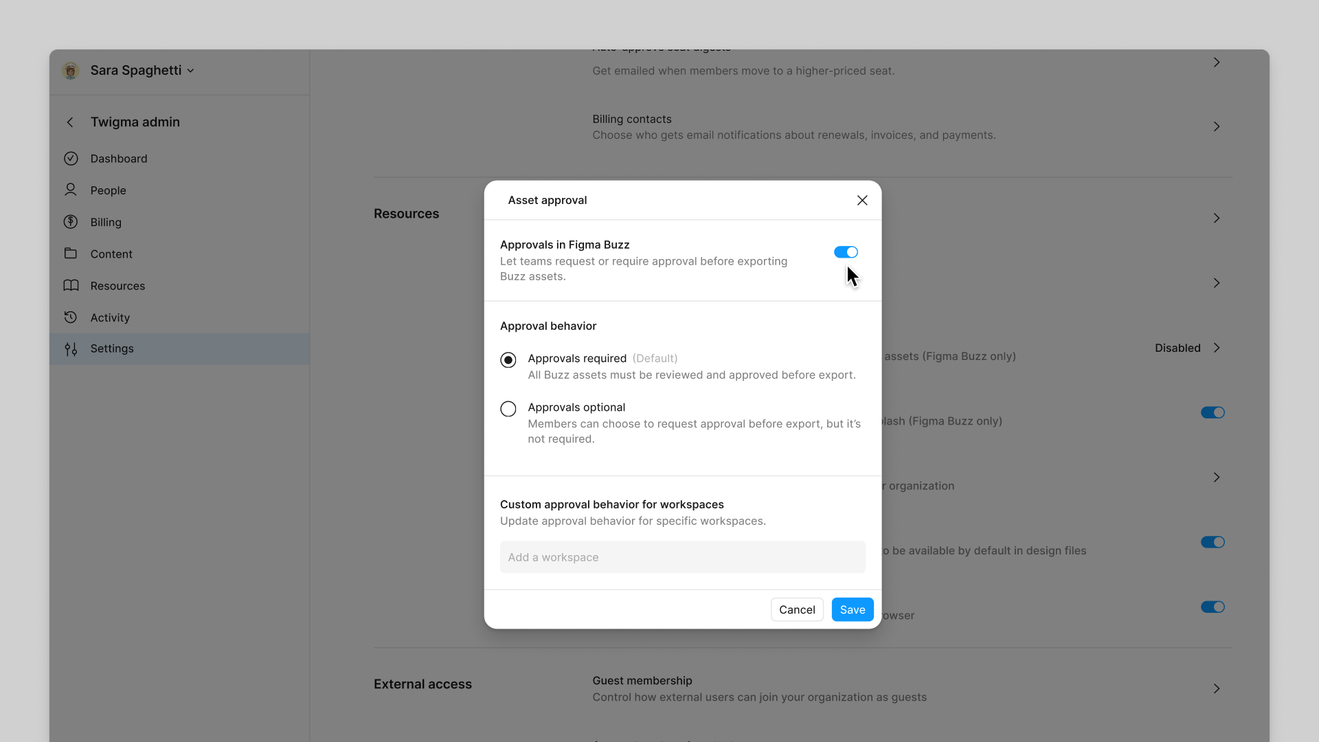

To configure approval settings for your organization:
- From the file browser, click Admin.
- Select the Settings tab.
- Find the Resources section.
- Select Asset approvals to open the approval settings modal.
By default, approvals are turned off. When approvals are off, users won’t see the option to request reviews or use approval workflows.
Toggle on approvals to enable them for your organization.
When approvals are enabled, you can choose how strictly they’re enforced:
- Approvals required: Assets must be approved before they can be exported. Users won’t be able to export assets until a review is completed.
- Approvals optional: Users can request approvals, but approval is not required to export assets.

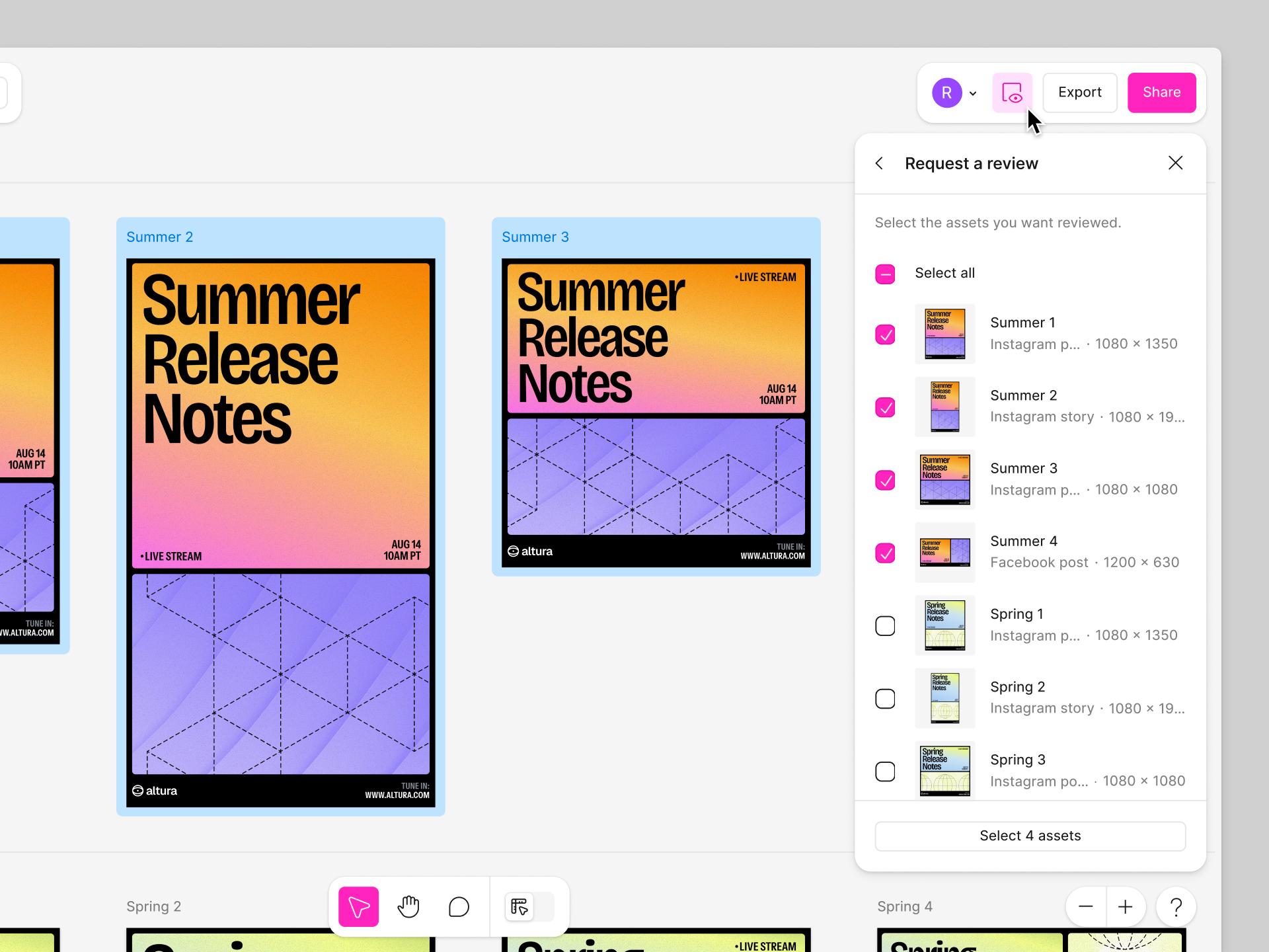

- Open your Figma Buzz file.
- Click Reviews in the top right.
- Click + New Review.
- Select the assets you want reviewed.
- Add a title, reviewers, and any additional context. You can add reviewers by name or email. Reviewers must already have access to the file.
- Click Send for review.
Figma Buzz creates a request that includes the selected assets and notifies reviewers. Reviewers receive an in-product notification and an email with a link to the request.

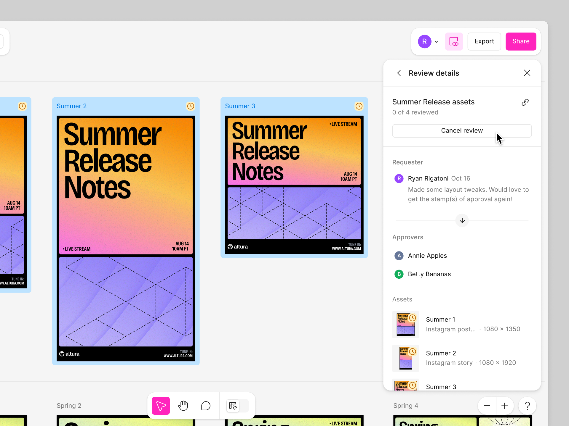

Manage your request
After sending a request, you can monitor progress and take action as reviewers respond.
Open the Reviews panel to see the current status of your request, including who has reviewed, their decisions, and any comments left on assets.
If you need to make changes to the request—such as updating the asset selection or reviewers—you’ll need to cancel the request and create a new one.
Cancel a request
Requesters can cancel a review at any time if they need to make updates or stop the review process.
To cancel a request:
- Find the relevant request and click Cancel review.
When a request is cancelled, the original notification is updated to indicate that the request was cancelled. Assets are no longer marked as In review.

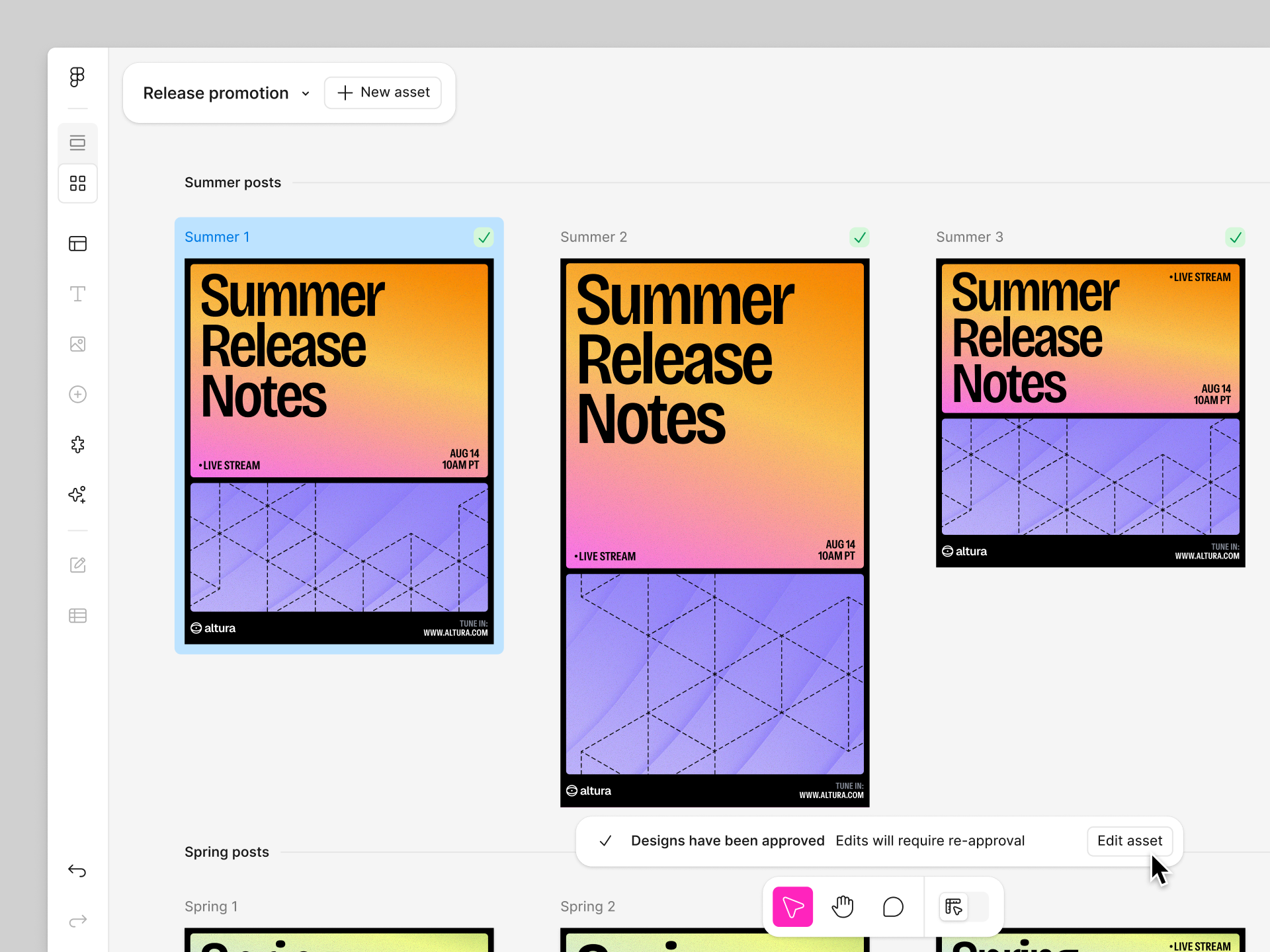

Editing approved assets
Once an asset is approved, it’s considered final and ready for use or export. Approved assets are locked and can’t be edited unless you explicitly unlock them.
If you need to make changes to an approved asset:
- Select the asset.
- In the banner at the bottom of the file, click Edit asset.
Clicking Edit asset removes its approval status and makes it editable again. You’ll need to request approval again before exporting if your organization requires it.

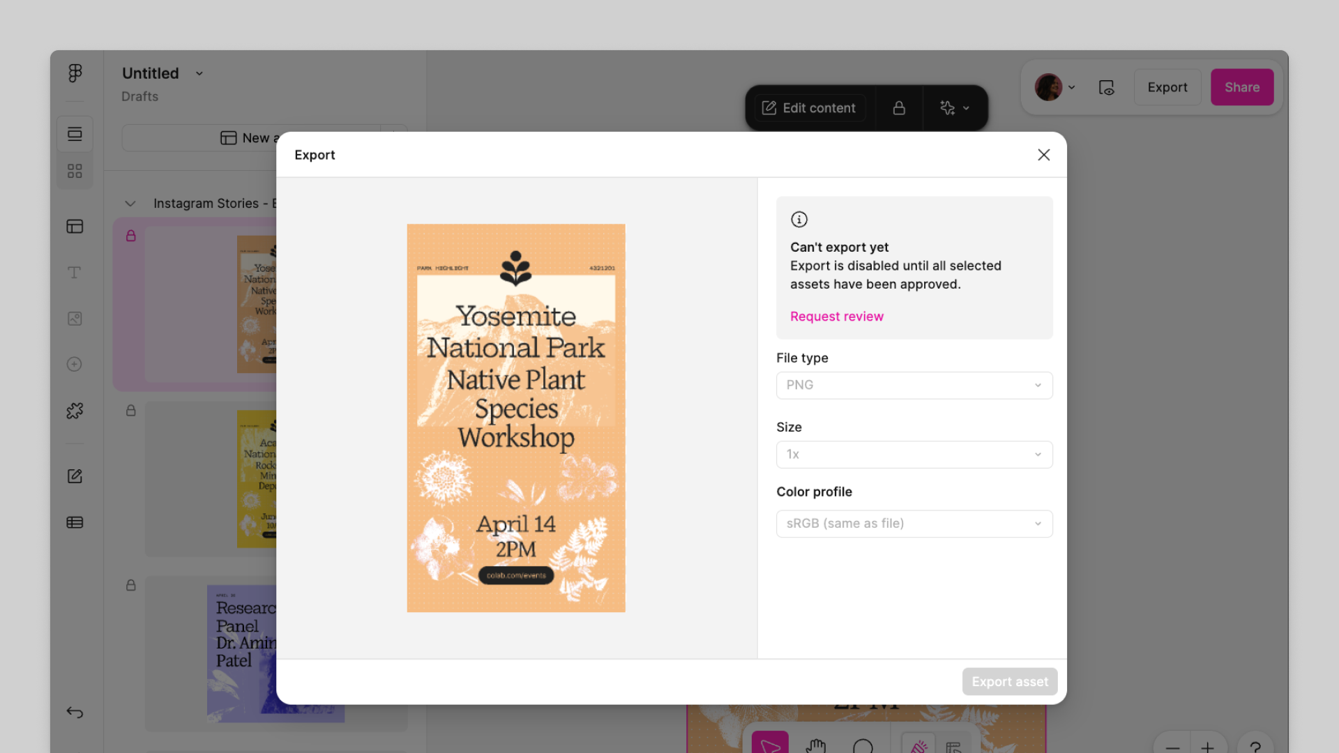

- If Approvals required is enabled, you can only export assets that have been approved. If any selected assets are not approved, you’ll be prompted to request approval before exporting.

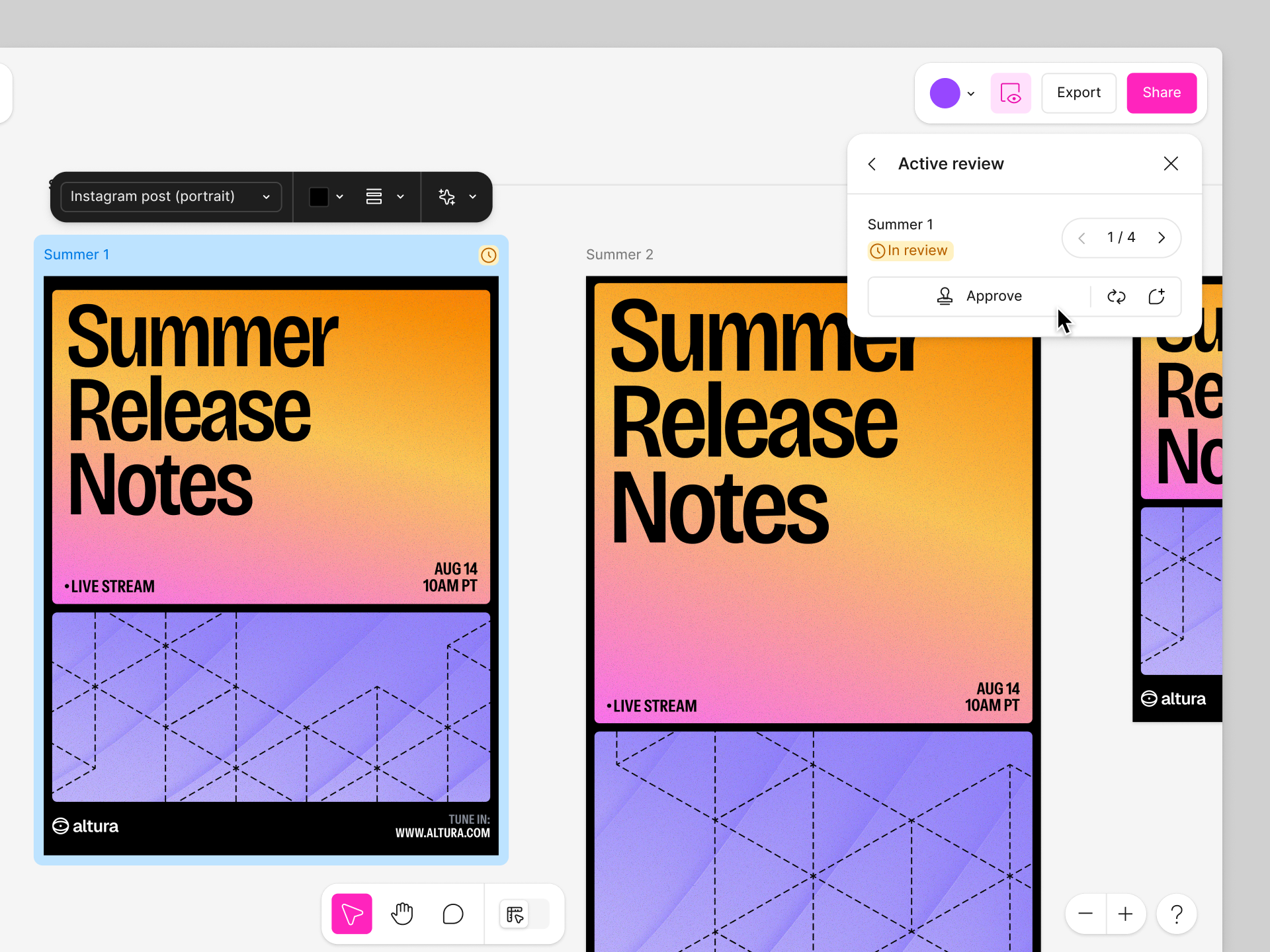

To open a review request:
- Open the Figma Buzz file.
- Click Begin review on the relevant request.
Once you begin, Figma Buzz guides you through each asset included in the request. The file will automatically pan and zoom so you can review assets one at a time.
For each asset, you’ll have the following options:
- Approve: Confirm the asset is ready to move forward
- Request changes: Indicate that updates are needed before approval
- Add a comment: Leave feedback directly on the asset. Comments behave like standard file comments, so you can reply, mention teammates, and resolve threads.
If you’ve already clicked Approve or Request changes on an asset, you can click Edit decision to update your choice.
When you’ve finished reviewing all assets, click Mark as complete.
