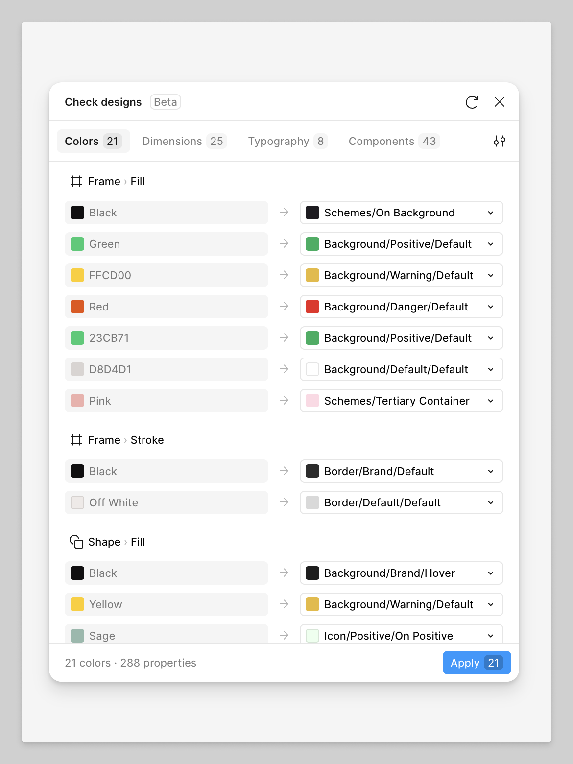

If the check results in suggestions that need to be reviewed, they will appear organized into four tabs:
- Colors: Hard-coded color values, contrast suggestions, and colors from libraries missing from the file or deselected in Settings
- Dimensions: Hard-coded values like spacing, padding, and corner radius, as well as values from libraries missing from the file or deselected in Settings
- Typography: Hard-coded font styles and sizes that can be replaced with text styles, along with values from libraries missing from the file or deselected in Settings
- Components: Components detached from their source library, and those from libraries missing from the file or deselected in Settings
Review suggestions
Check designs opens to the first tab with violations and issues. At the top, you’ll see the total number of suggestions across all categories. Suggestions are based on values similar to a variable in your design system, or labeled as a Match when the value exactly matches an existing variable.

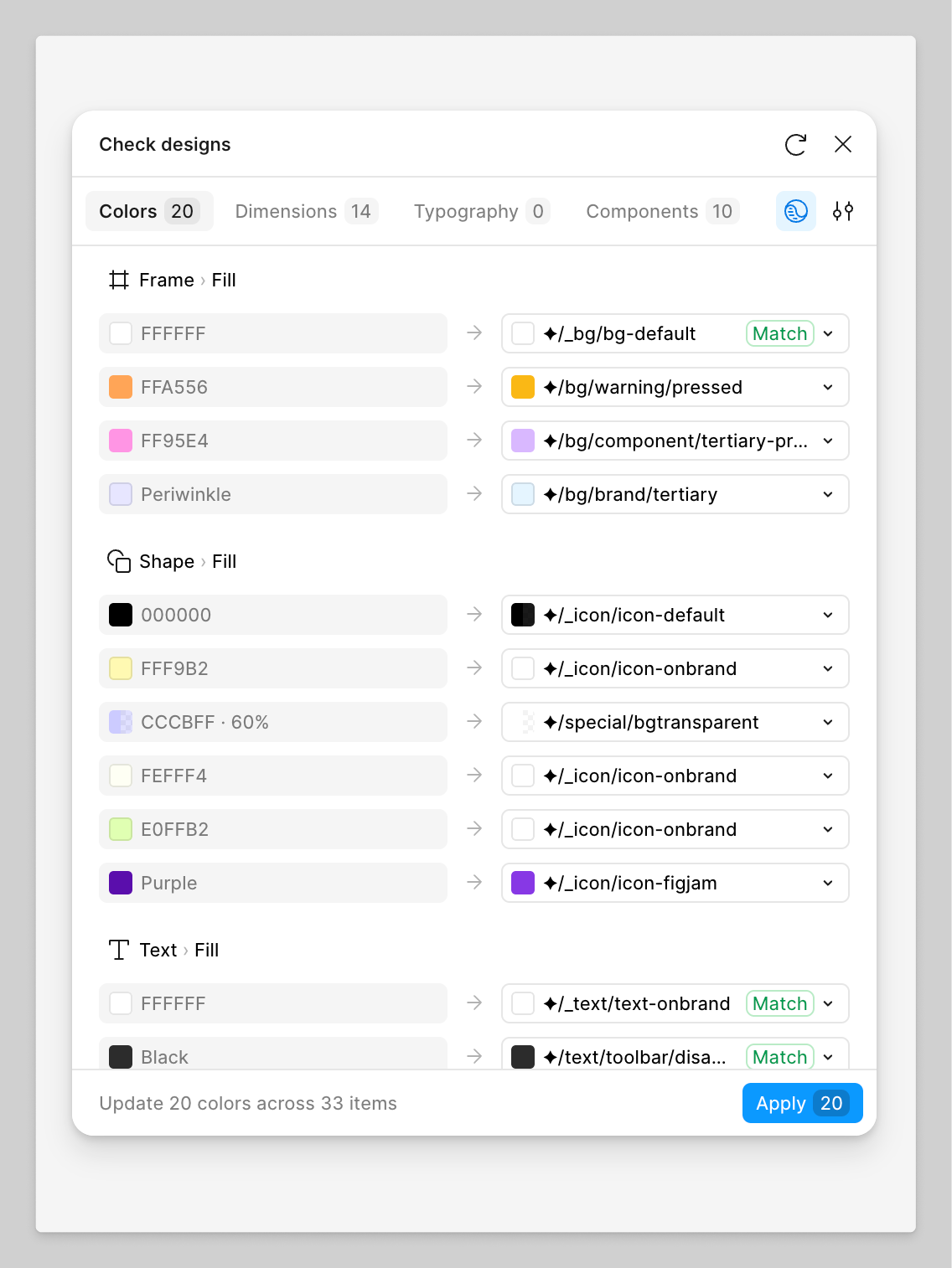

Click a row to recenter the canvas on the affected area. To preview changes on the canvas:
- Hover over a suggestion row to highlight affected layers in both the canvas and the Layers panel
- Hover over a suggested value in the right column to preview the change to the affected layer on the canvas
- Use the dropdown to select a different value
Apply changes
You can apply suggestions in a few ways:
- Apply all: Apply all suggestions in the current view by clicking Apply
- Apply a single change: Select a row and click Apply
Apply multiple changes:
- ⌘Command / Control + click to select multiple rows
- ⇧Shift + click to select a range
- Group selections by clicking the section heading.
Click Apply once you’re ready.
