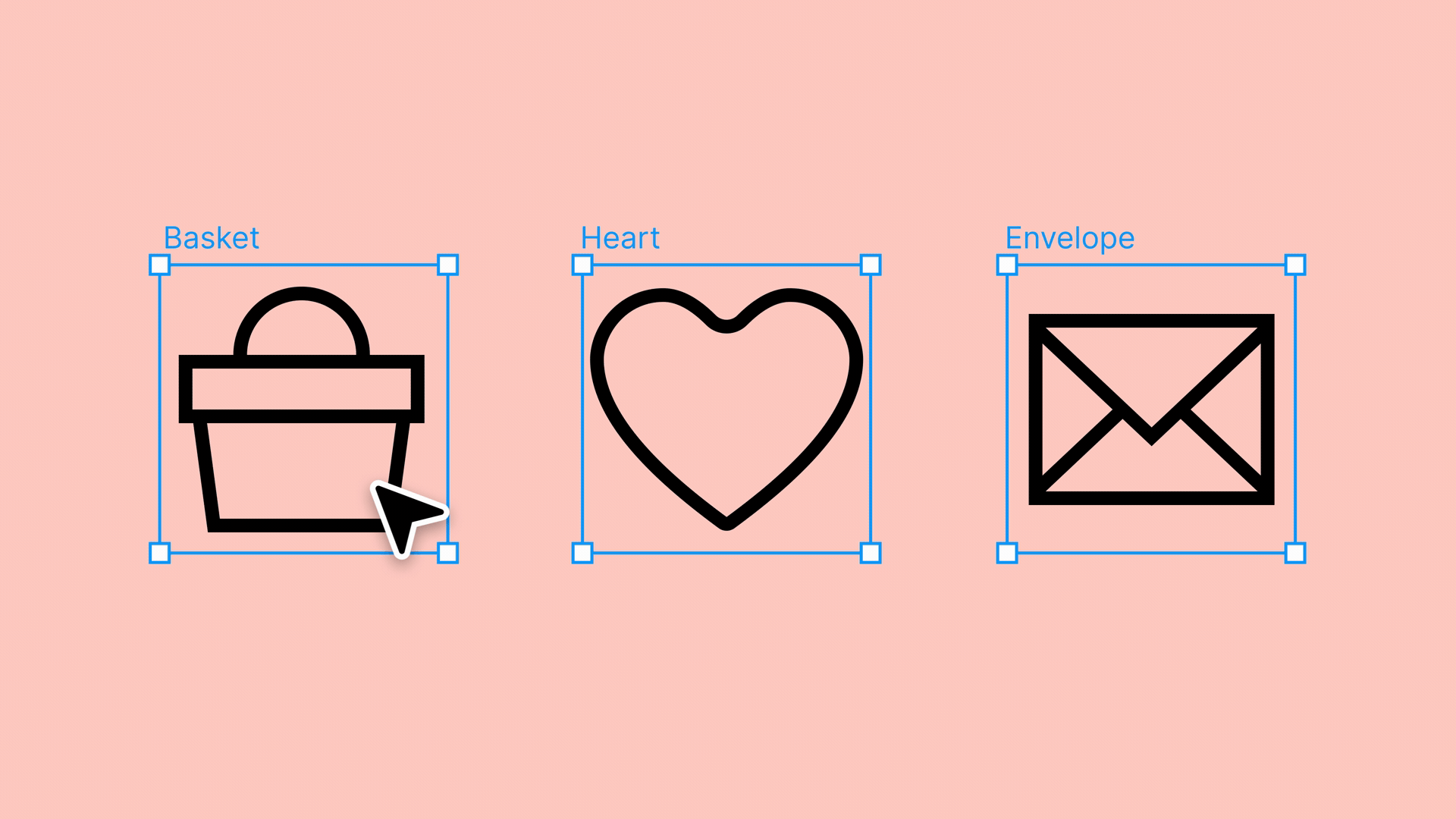

You can create main components from any collection of layers. This could be a simple element, like an icon or button; or an entire layout, like a card or menu.
To create a main component, select the layers you want to use and click Create component in the right sidebar. You can identify main components by their purple bounding box on the canvas and four diamonds icon in the layers section in the left sidebar.
