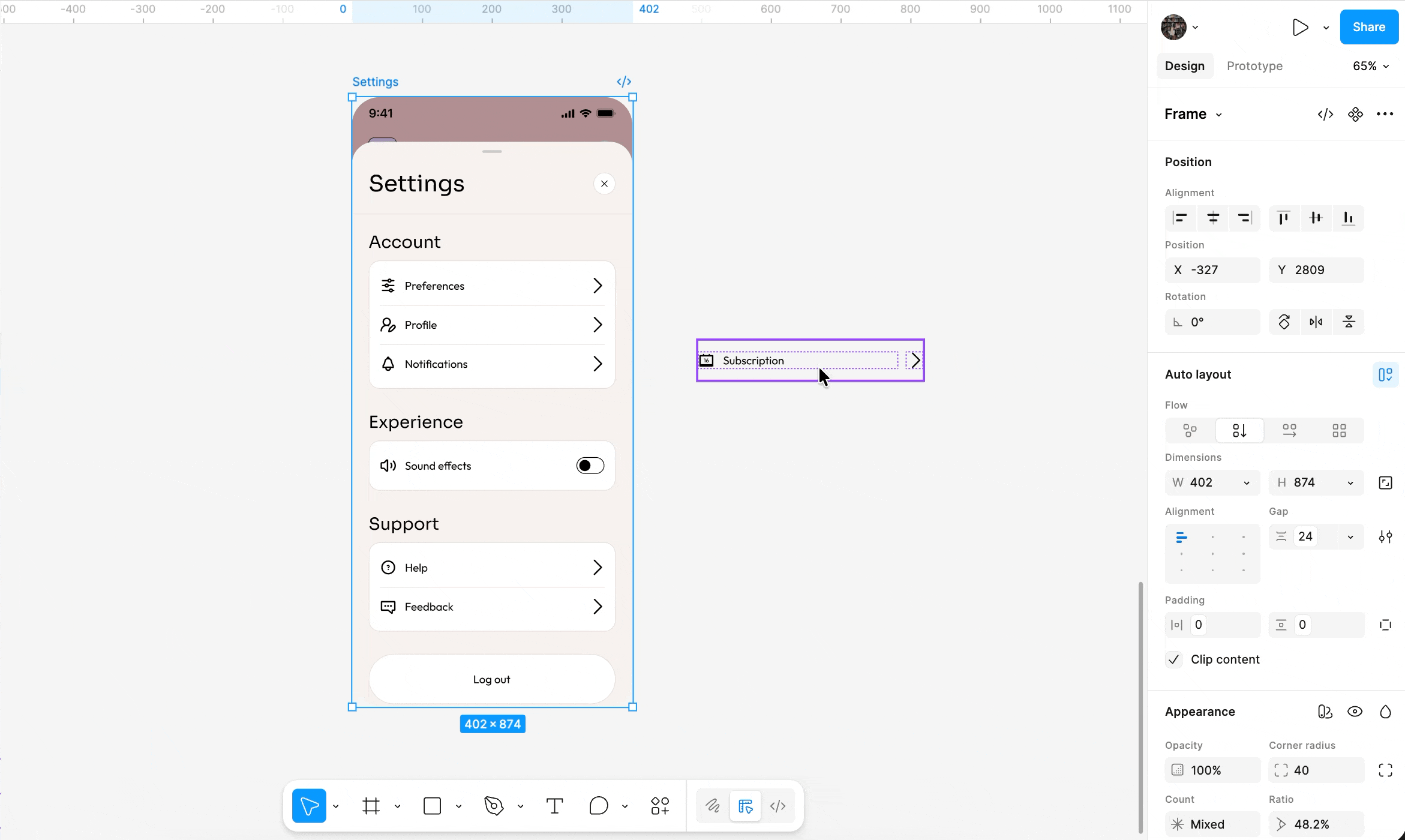

Component properties define which aspects of a component are intended to be customized. Rather than hunting through the Layers panel or clicking into instances on the canvas, users can access consolidated controls in the right sidebar that clearly indicate what’s meant to change and what isn’t.
Keep in mind, component properties don’t restrict access to other layers. They simply guide users by making the right controls easier to find.

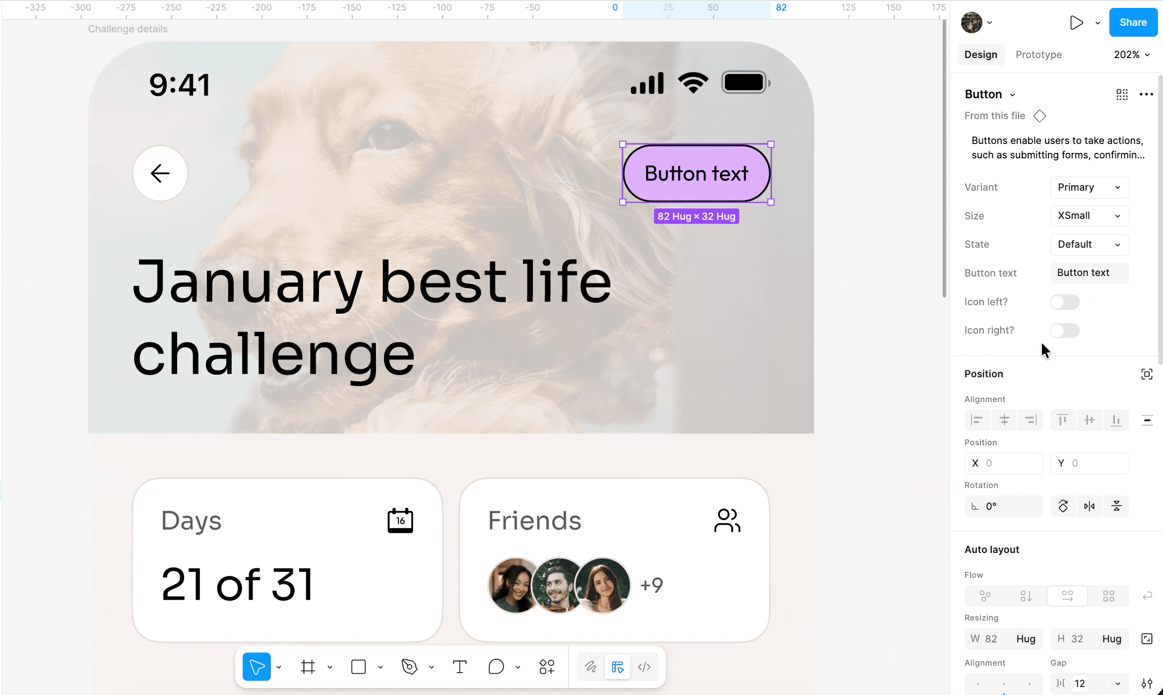

- Boolean properties: Control which layers can be shown or hidden
- Instance swap properties: Define which nested instances can be replaced with preferred alternatives
- Text properties: Indicate which text content can be changed

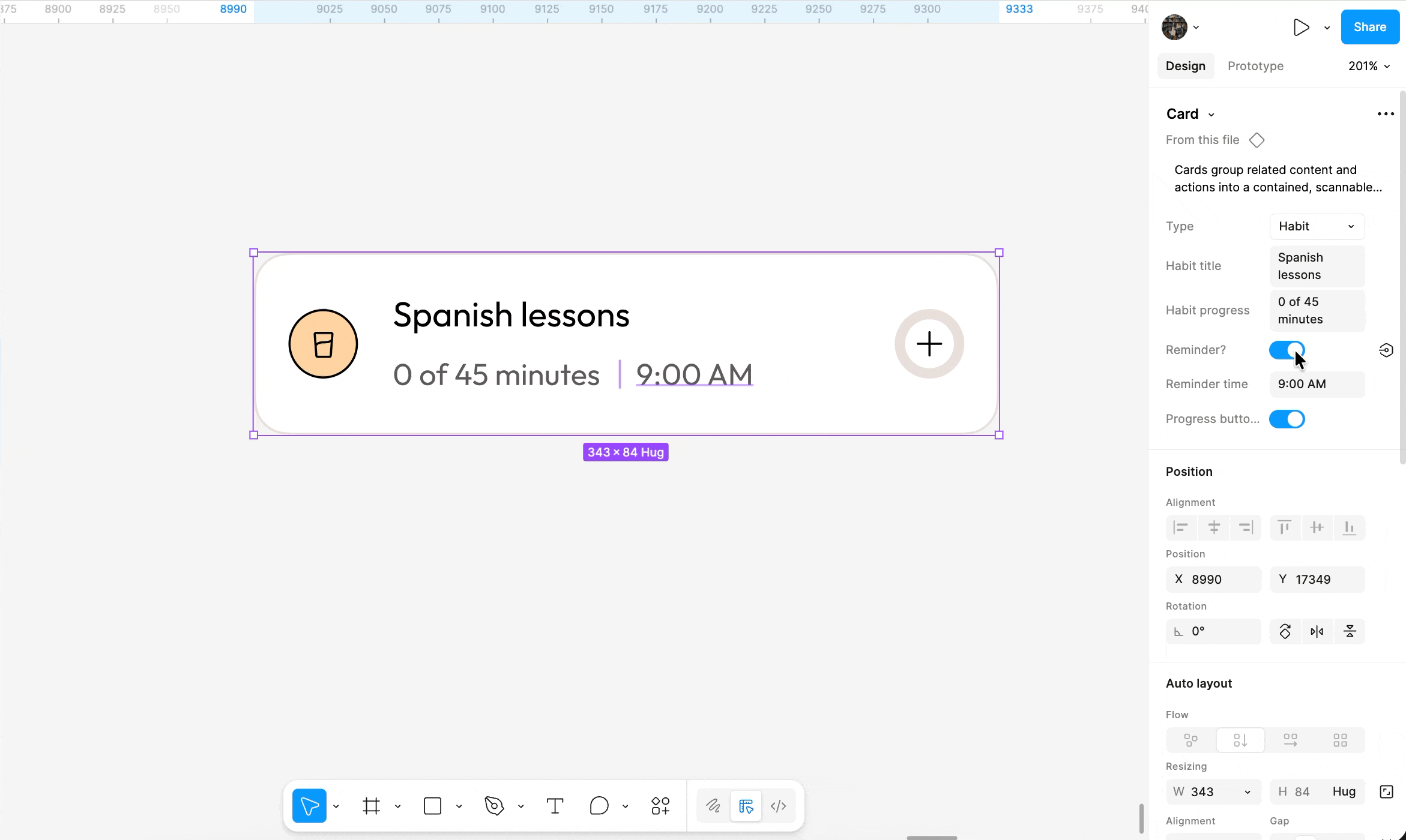

Boolean property
Boolean properties use true/false values to control layer visibility within instances, where true shows the layer and false hides it.
Boolean properties can make your components more modular. For example, imagine designing a card component that includes optional elements like an icon, status indicator, or button. Without boolean properties, you’d need separate components for every possible combination of optional elements, which could quickly become unmanageable as options multiply. Instead, you can use boolean properties to create a flexible component where users can toggle optional elements on or off as needed, directly from the right sidebar.

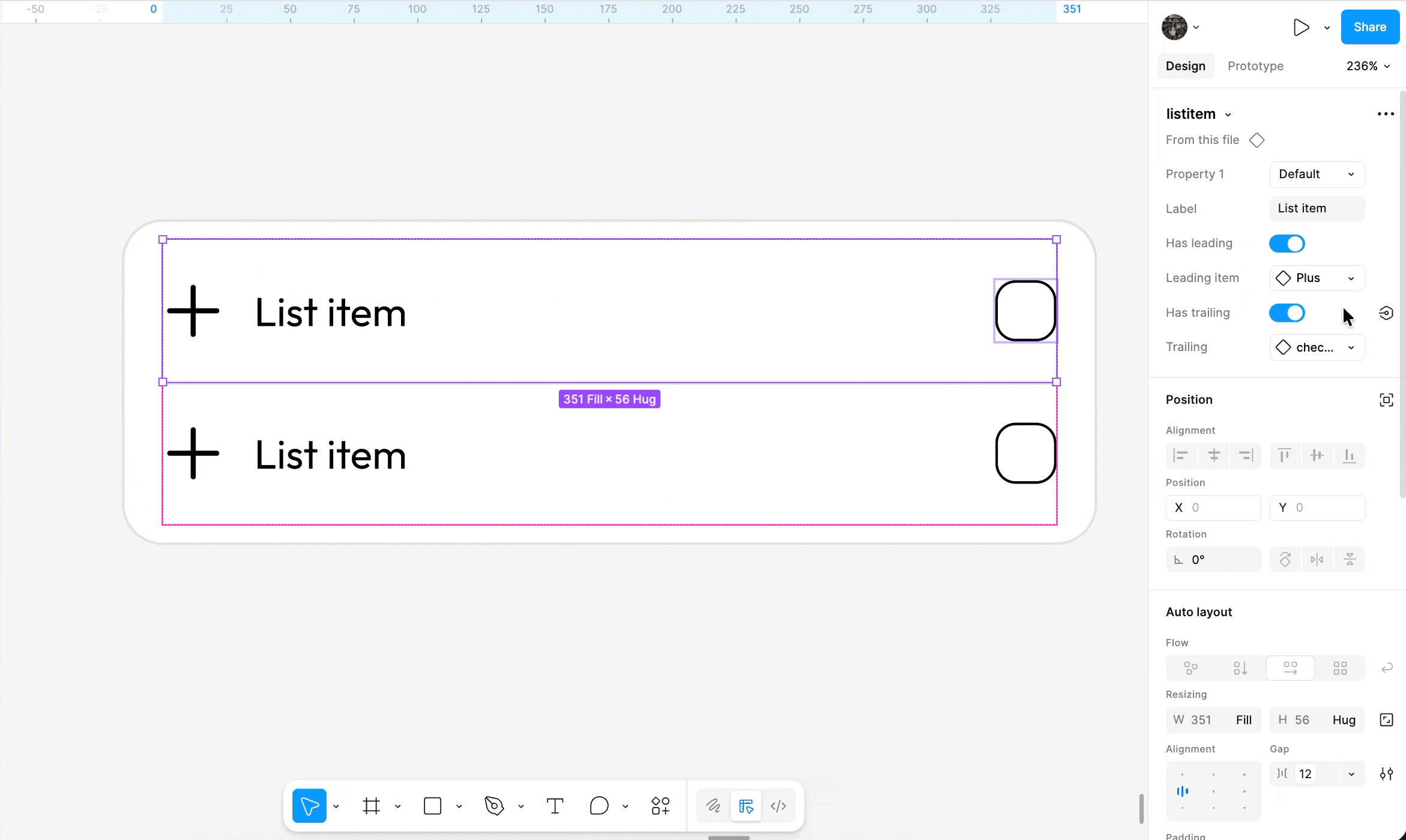

Instance swap property
Instance swap properties let you indicate which nested instances can be replaced and curate a list of suitable alternatives. For example, when designing a list item that includes an icon, you can apply an instance swap property to the icon and specify preferred icon alternatives. Users can then change icons directly from the right sidebar without clicking into the instance on the canvas.

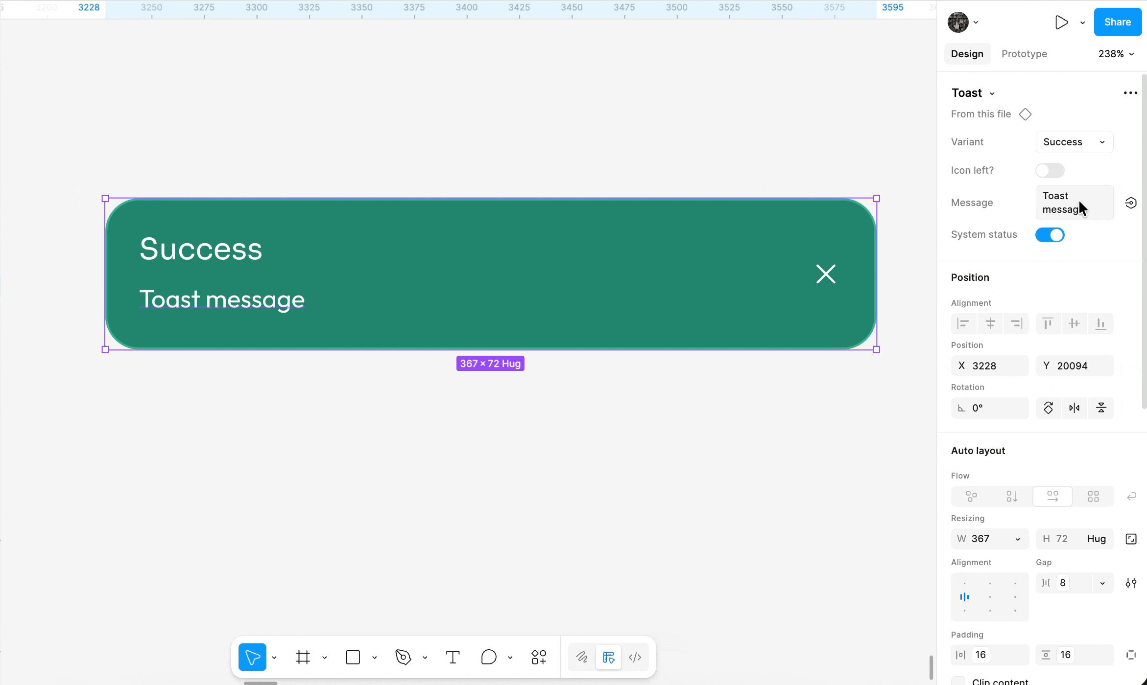

Text property
Text properties let you specify which text layers can be edited and give users a direct way to update content from the right sidebar.
Text properties help eliminate confusion about which text layers are meant to be edited, and which should stay fixed. For example, in a toast notification, you might keep the heading fixed (such as “Success” or “Error”) while allowing the message text to be customized for different situations.
