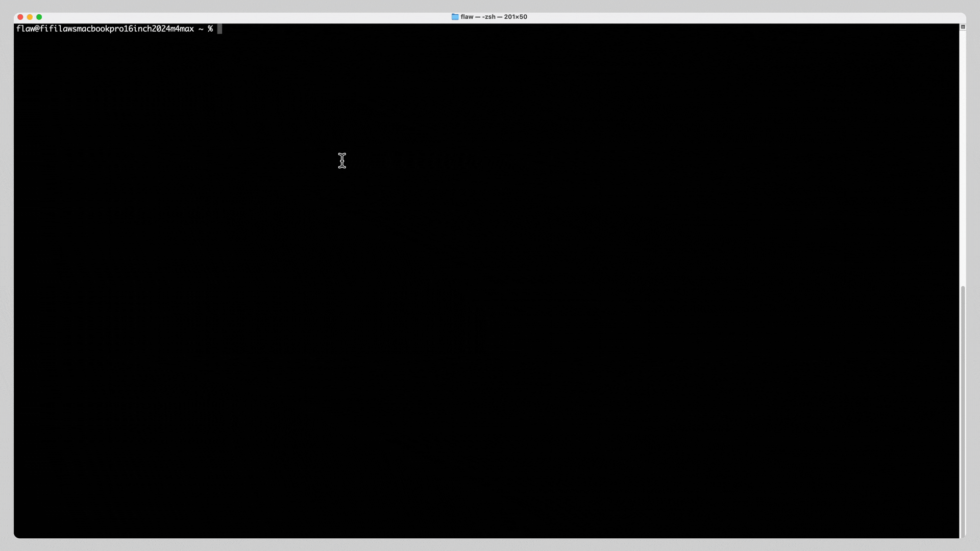

In your terminal, run:
claude plugin install figma@claude-plugins-official
