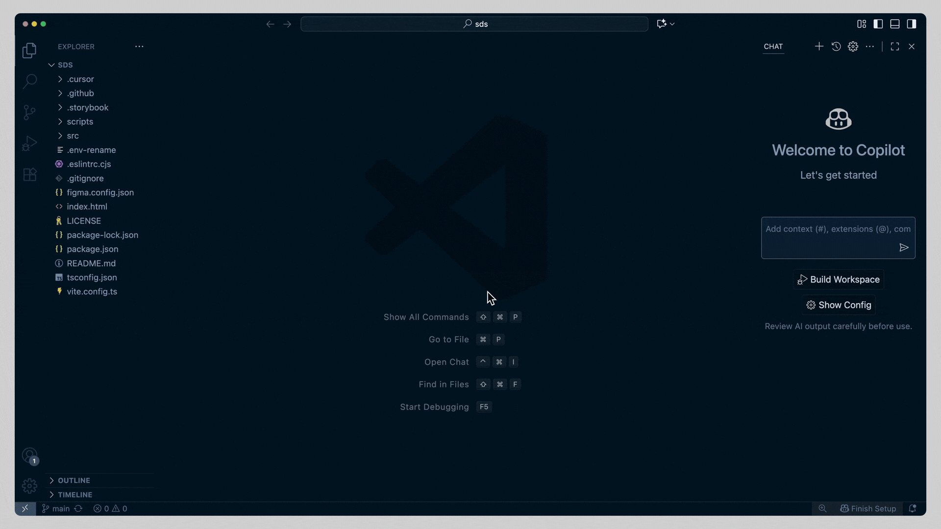

The quickest way is to install the Figma MCP server in VS Code with one click, then follow the prompts to sign in. To set it up yourself instead:
- Open the command palette:
- Mac: Cmd Shift P
- Windows: Ctrl Shift P
Search for and select one of these:
- MCP: Open User Configuration to use the Figma MCP server in all your projects
- MCP: Open Workspace Folder Configuration to use it only in your current workspace
If you don't have an
mcp.jsonfile yet, VS Code asks you to create one. -
In the
mcp.jsonfile, paste this code:{ "inputs": [], "servers": { "figma": { "url": "https://mcp.figma.com/mcp", "type": "http" } } } - Save the file:
- Mac: Cmd S
- Windows: Ctrl S
- Above the Figma server name in the file, click Start.
- When prompted, click Allow access to let VS Code access your Figma account.
Note: On Organization and Enterprise plans, your organization may require admin approval before VS Code can access its Figma resources. If prompted, click Request access. After approval, open the approval notification and finish authorizing the connection. If requests aren’t available, contact your Figma organization admin.
The Figma MCP server is now running in VS Code, and you're ready to start prompting. To see what you can do, check out Tools and example prompts.
