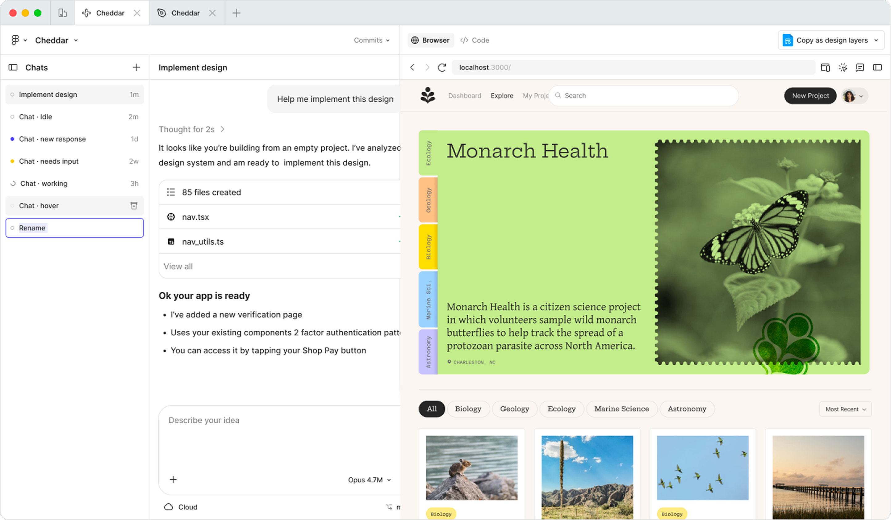

Work with Make in your local codebase
Here's a quick overview of how to use the Figma Beta desktop app version of Make in your local codebase:
Work directly with real code
Connect a local repository or clone one from GitHub. Your app opens inside Make with real data, exactly as your users see it.
Manage branches right in Figma Make
Create, switch, and work on branches directly from Make. Your changes stay on your local machine until you push.
Commit to your codebase
Each prompt that changes code is saved as a local commit, so you can step back through your work. When you're ready, open a pull request for your engineering team to review.
Annotate your UI to prompt
Drop annotations directly on the rendered UI to describe what you want changed. Stack several annotations across the screen and submit them together as a single prompt.
Point to edit your interface
Select any element in your live app and adjust its properties in the editing panel. Change layouts, colors, fonts, and spacing without writing a prompt.
Run multiple prompts at once
You can run more than one chat at the same time in a single Make file, so you can start a new change while another chat is still working. You don't have to wait for one response to finish before moving on to the next thing you want to do.
