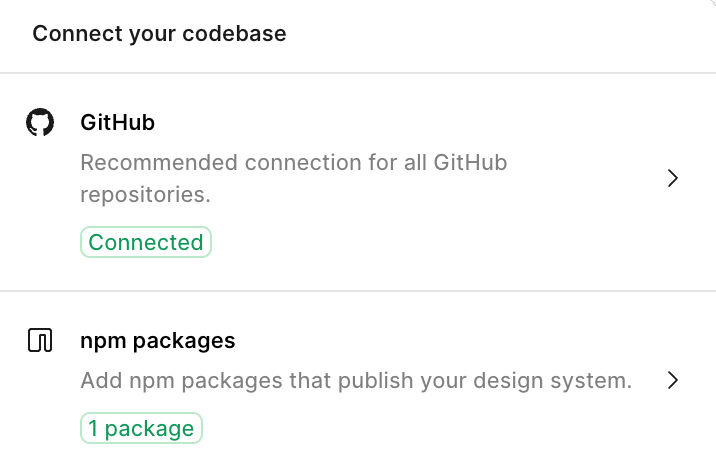

- The components in your design library are connected to your codebase using Code Connect. Learn more about Code Connect
- The library file needs to be connected to the GitHub repository containing the components. We currently only support GitHub as code hosting provider. Learn more about connecting to GitHub

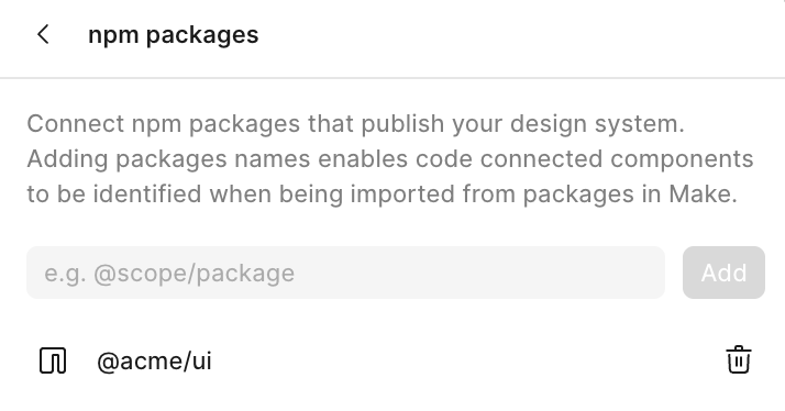

If the code in Figma Make is consuming components from an npm package (e.g.
import { Button } from "@acme/ui";), the name of the npm package needs to be specified in the Code Connect settings of the design library.

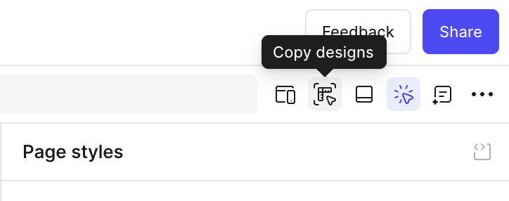

- In the upper-right corner of Figma Make, click Copy design.
- Choose whether to copy to a Figma Design file or to your clipboard.
- If you choose to copy to your clipboard, paste onto the canvas in a Figma Design file.
The code components are pasted as instances of the corresponding design components.

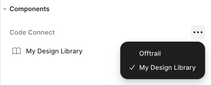

First, make sure that the design library your components are defined in is added to your Make. You can do that by selecting it from the Components section in Make's editing panel.

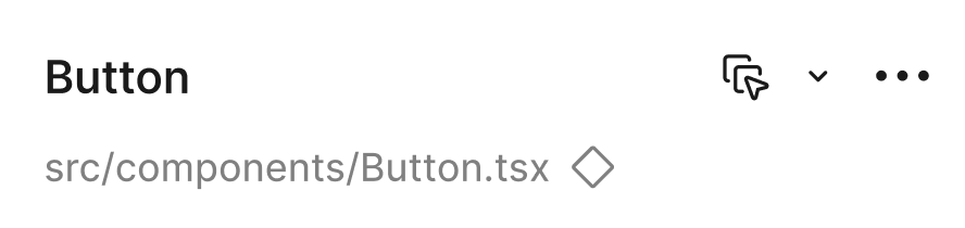

Next, select the code component that is not detected correctly and check its provenance, displayed below the component name:
- The file path of the component shown here should match the one you have set up in Code Connect (e.g.
src/components/Button.tsx) - If the component comes from an npm package, you should see the package name here. This should match the name of the package you added in the Code Connect settings.
