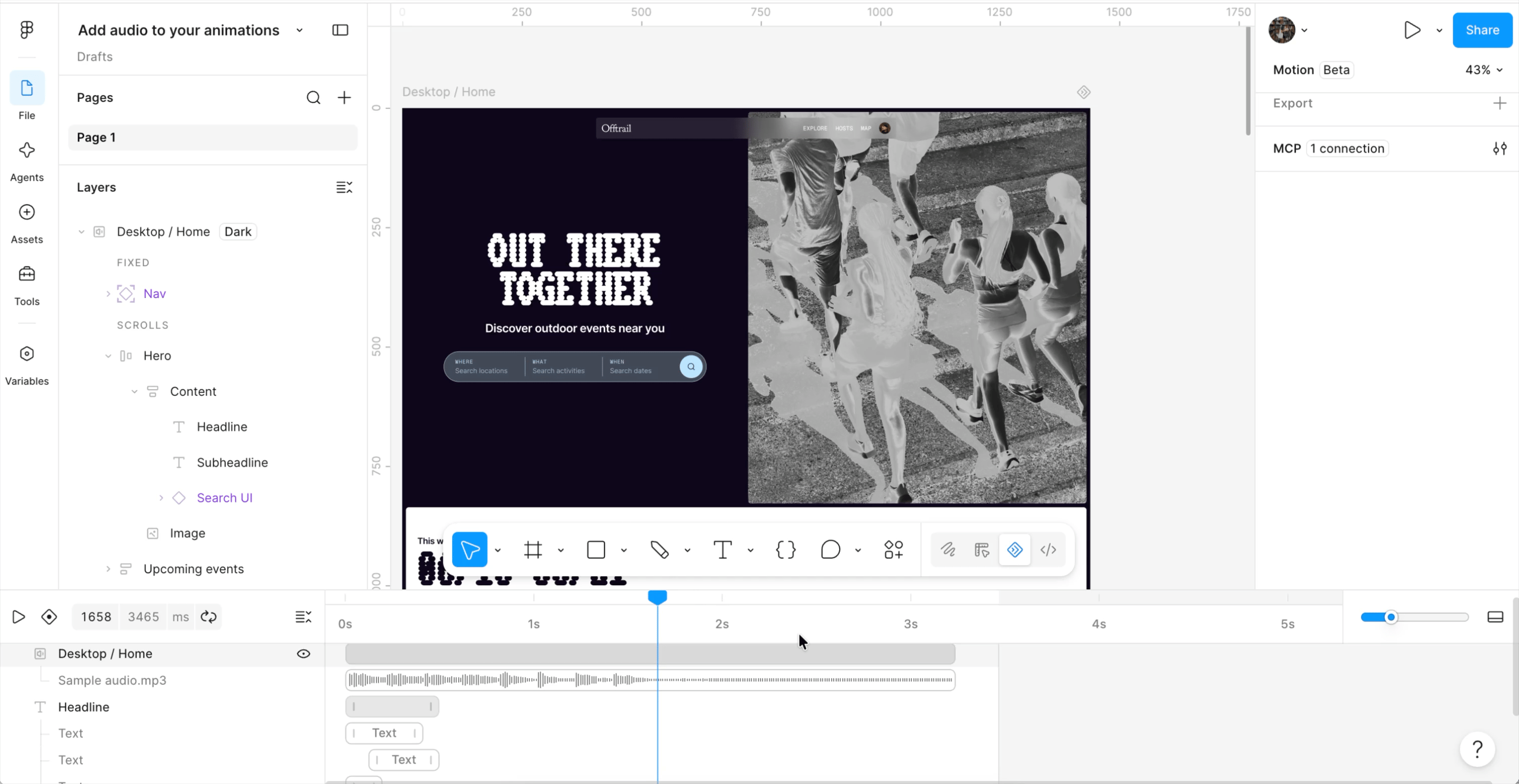

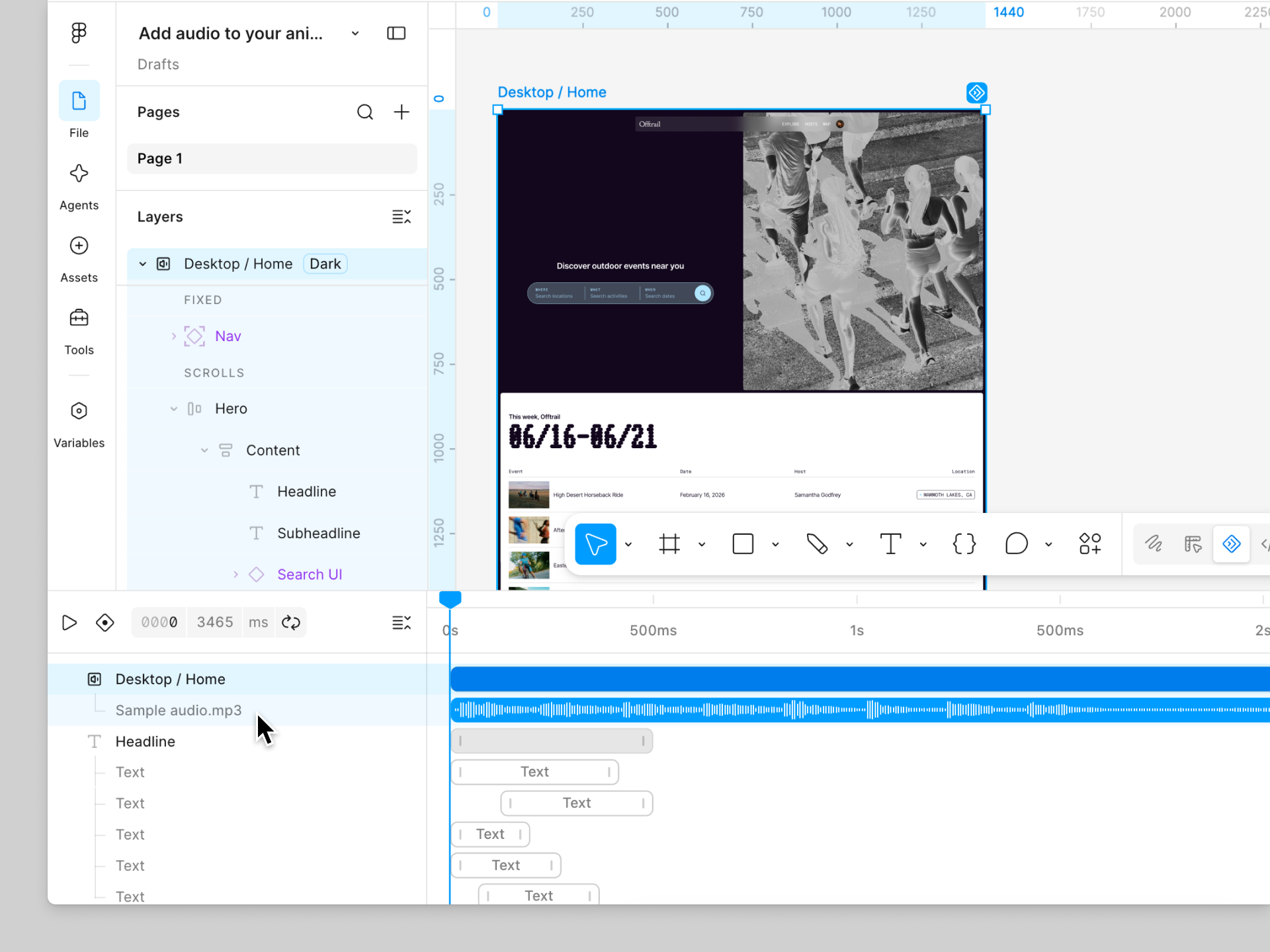

Add an audio track to the timeline
- Locate the file on your computer.
- Drag and drop the file onto a frame or the Figma Motion timeline.
- Click and drag the audio track left or right to reposition it in time.

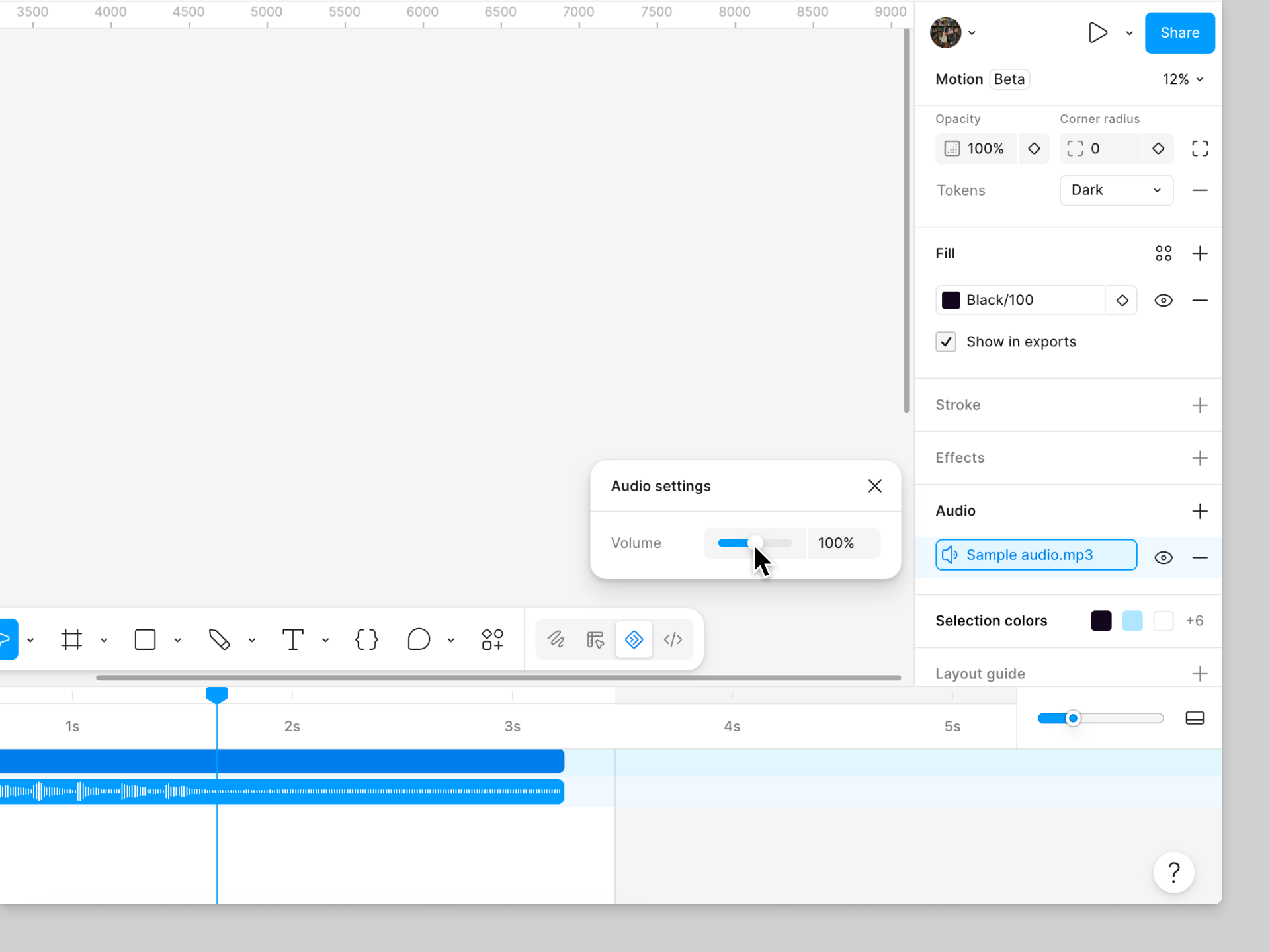

Change the volume of an audio track
You can control the playback volume of an audio track using the slider in the Audio section of the right sidebar. You can also mute a region entirely by right-clicking on the layer and selecting Mute audio or by clicking the eye icon next to the layer name on the timeline.
