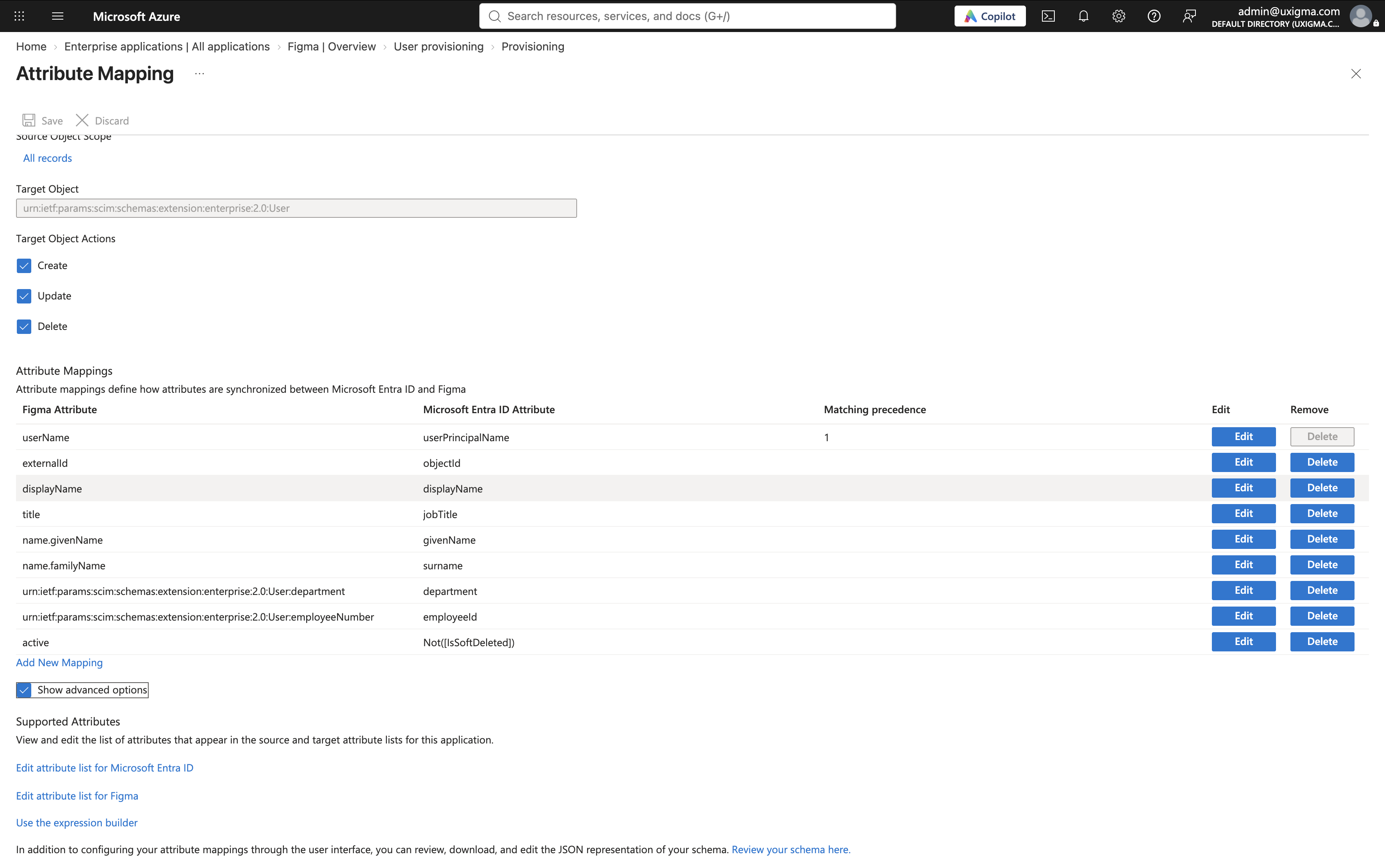

- Open Provisioning → Attribute Mapping.
- Select Provision Microsoft Entra ID Users.
- Select Show advanced options.

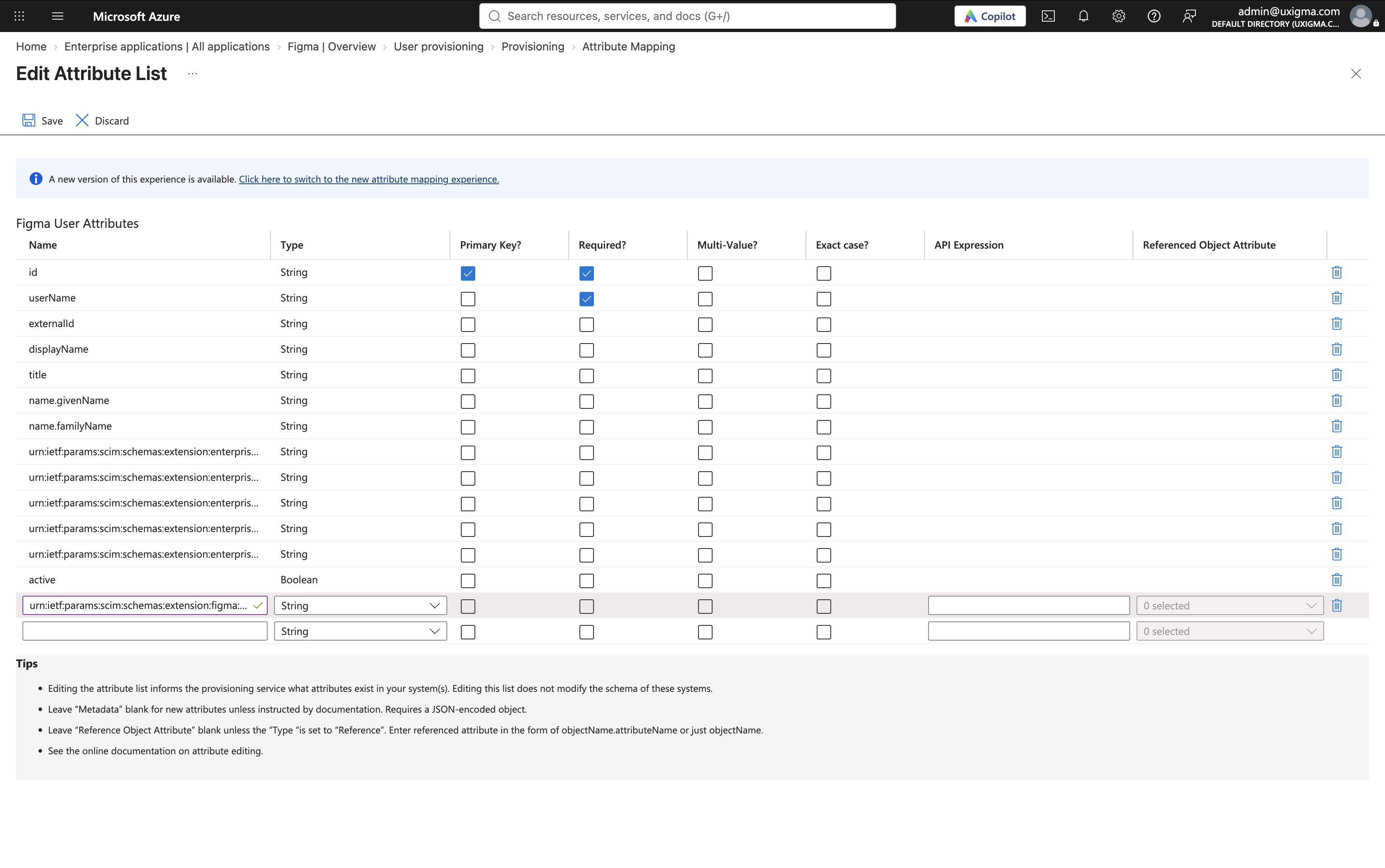

- Select Edit attribute list for Figma.
- Add the following target attribute.
| Setting | Value |
| Name | urn:ietf:params:scim:schemas:extension:figma:enterprise:2.0:User:aiCreditLimit |
| Type | String |
| Multi-Value? | No — leave unchecked |
- Select Save.
Learn more about adding custom attributes to a SCIM application.

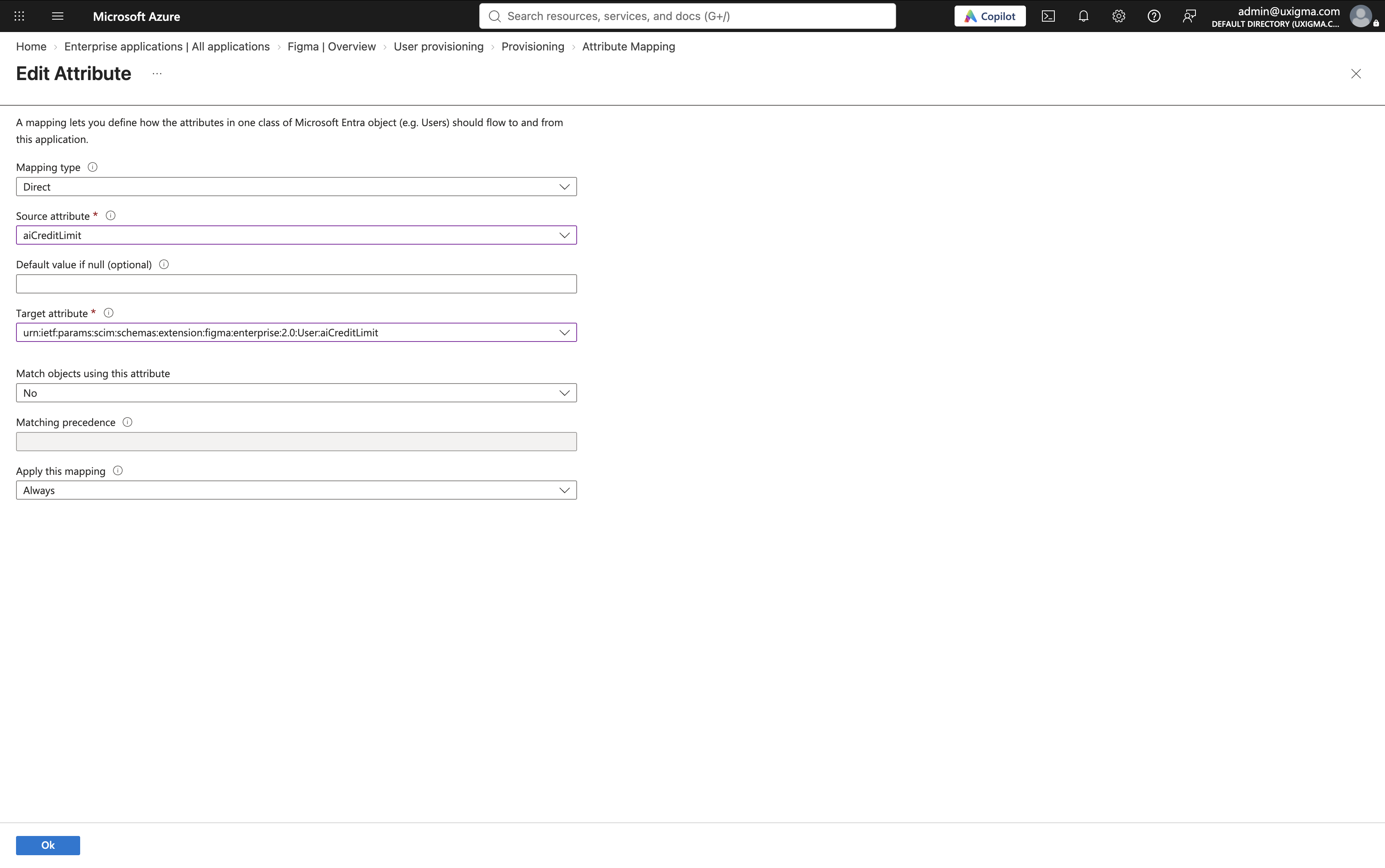

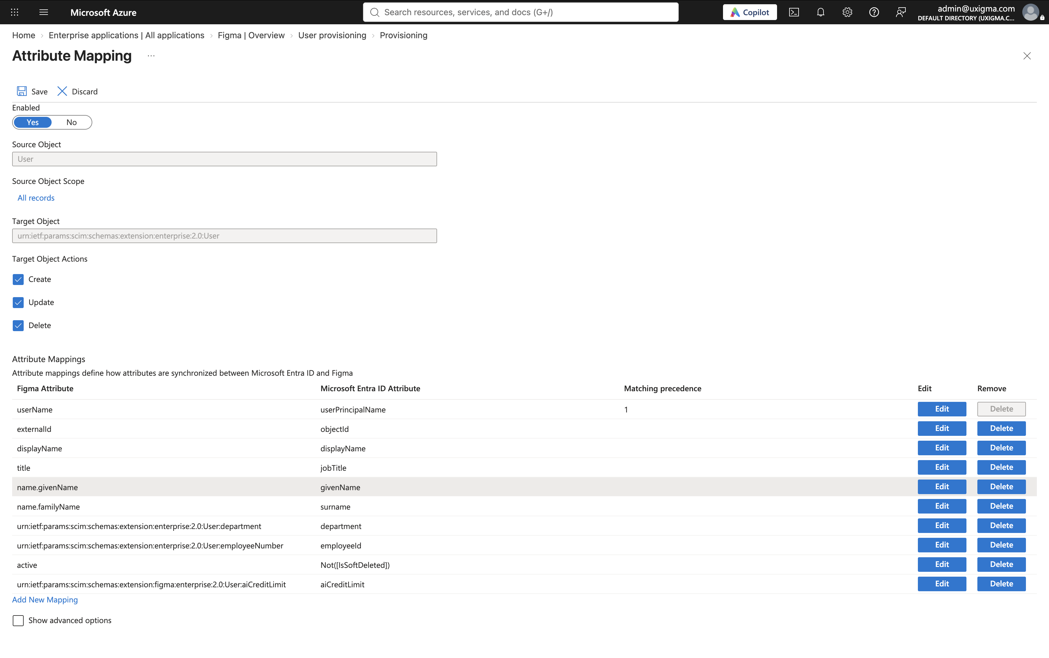

3. Map the attributes
In the Figma application’s user attribute mappings:
- Select Add New Mapping.
- Configure the mapping using the following settings.
| Setting | Value |
| Mapping type | Direct |
| Source attribute | The single-value user attribute prepared in step 2 |
| Target attribute | urn:ietf:params:scim:schemas:extension:figma:enterprise:2.0:User:aiCreditLimit |
| Match objects using this attribute | No |
| Apply this mapping | Always |
- Select OK.
- Select Save on the Attribute Mapping page.
Learn more about mapping attributes.
