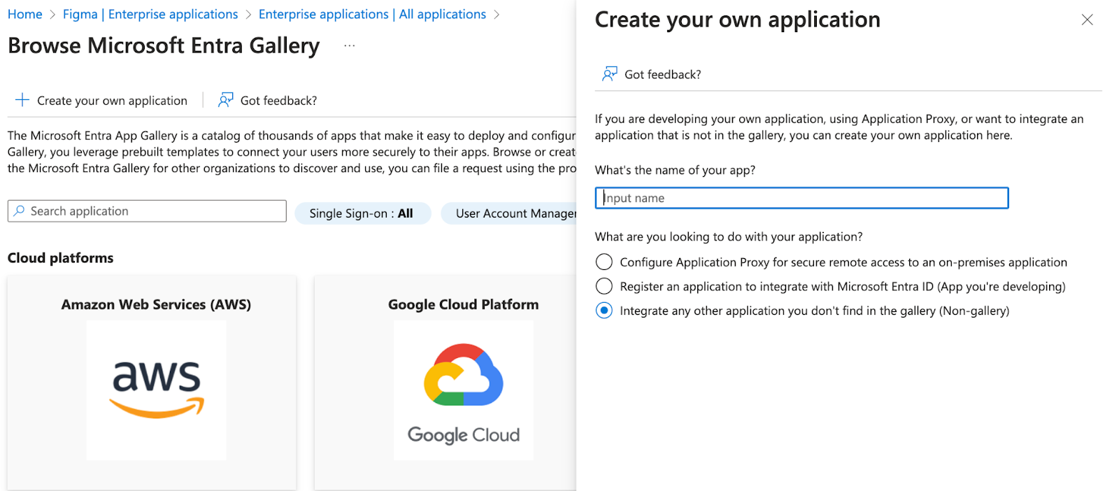

Add a Custom Application to Entra ID
- Open Entra ID in the overview page.
- Select Enterprise applications.
- Go to the All applications section.
Click + New application.
- Click + Create your own application.
- Enter a name for your application, such as "Figma Custom App", select the Integrate any other application you don't find in the gallery (Non-gallery) option, and click Create.

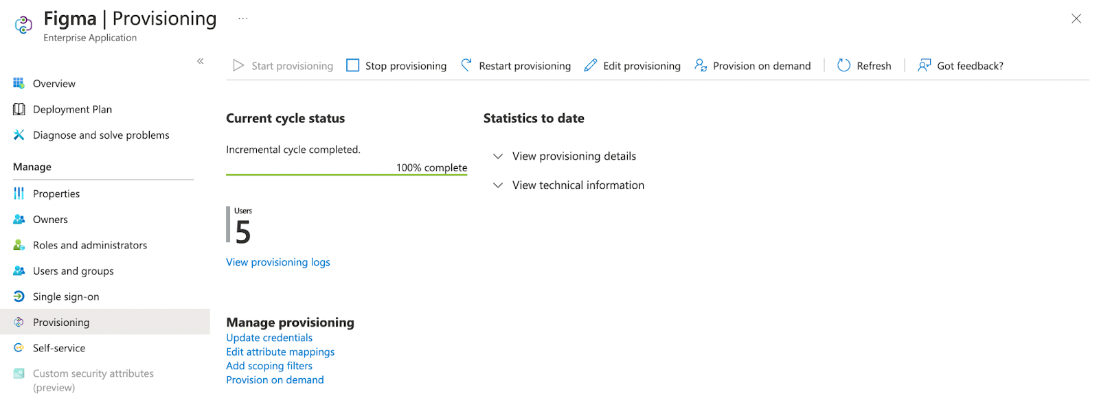

- Under Settings, toggle the Provisioning Status to on.
Define which users and/or groups you would like to provision to Figma. Choose
from:
- Sync all users and groups
- Sync only assigned users and groups
- Click Save to apply your provisioning settings.

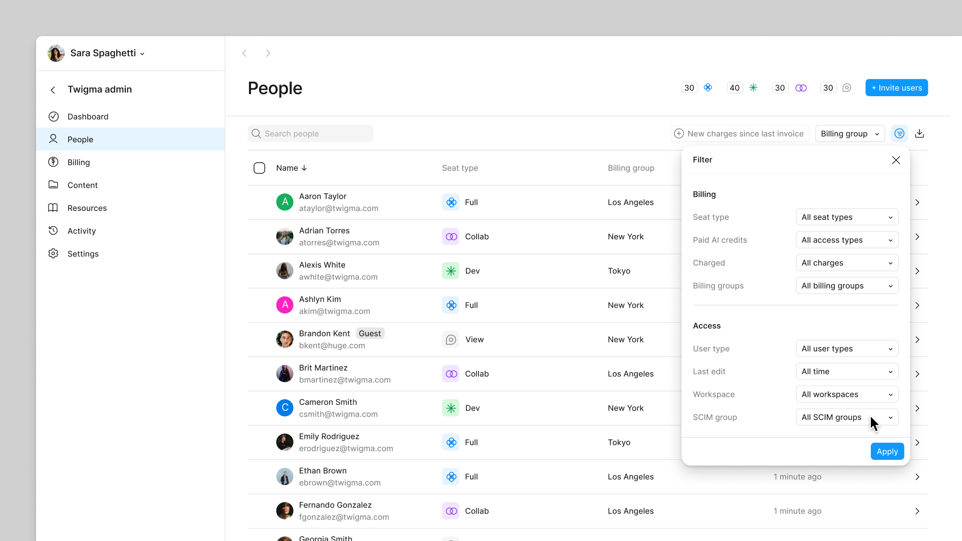

View SCIM groups in Figma
You can view the members of any SCIM group you’ve created in Figma.
- From the file browser, click Admin in the left sidebar.
- Select the People tab.
- Select People table filters to select and view members by SCIM group.

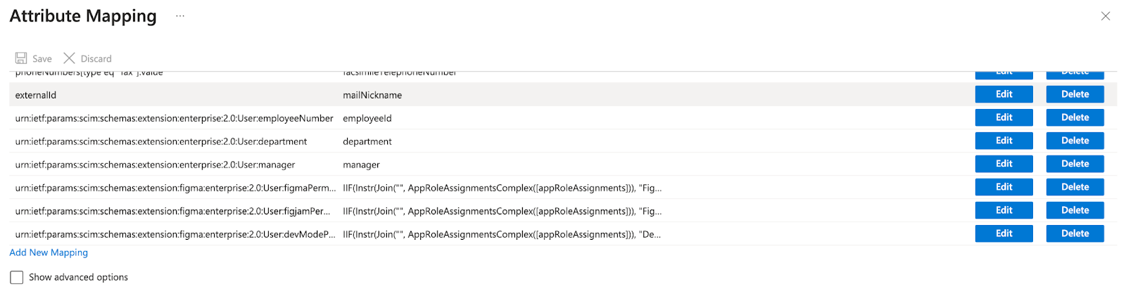

Configure the member role for Figma
- Open the Figma Enterprise App.
Navigate to the Provisioning section.
- Click Edit attribute mappings.
Expand Mappings and select
Provision Microsoft Entra ID Users.
Click Edit for the
urn:ietf:params:scim:schemas:extension:figma:enterprise:2.0:User:figmaPermissionattribute. -
Set its expression to:
IIF(Instr(Join("", AppRoleAssignmentsComplex([appRoleAssignments])), "FigmaFull", , )>"0", "", IIF(Instr(Join("", AppRoleAssignmentsComplex([appRoleAssignments])), "FigmaViewerRestricted", , )>"0", "viewerRestricted", "full")) - Click OK to save
Click Edit for the
urn:ietf:params:scim:schemas:extension:figma:enterprise:2.0:User:figjamPermissionattribute. -
IIF(Instr(Join("", AppRoleAssignmentsComplex([appRoleAssignments])), "FigJamFull", , )>"0", "full", IIF(Instr(Join("", AppRoleAssignmentsComplex([appRoleAssignments])), "FigJamViewerRestricted", , )>"0", "viewerRestricted", "")) -
Click Edit for the
urn:ietf:params:scim:schemas:extension:figma:enterprise:2.0:User:devModePermissionattribute. -
IIF(Instr(Join("", AppRoleAssignmentsComplex([appRoleAssignments])), "DevModeFull", , )>"0", "full", IIF(Instr(Join("", AppRoleAssignmentsComplex([appRoleAssignments])), "DevModeViewerRestricted", , )>"0", "viewerRestricted", "")) - Click OK to save.

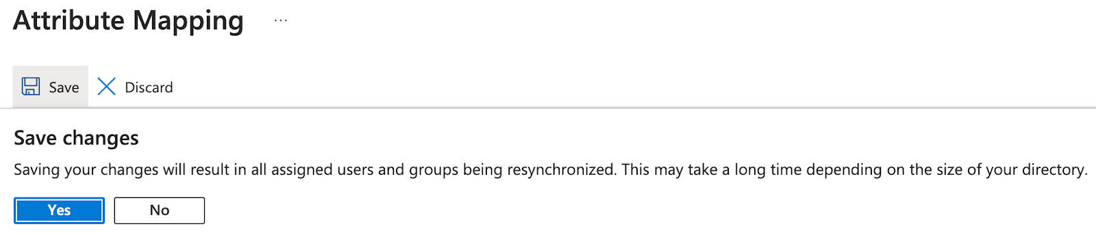

Back on the Attribute Mapping page, click
Save to confirm your changes.
