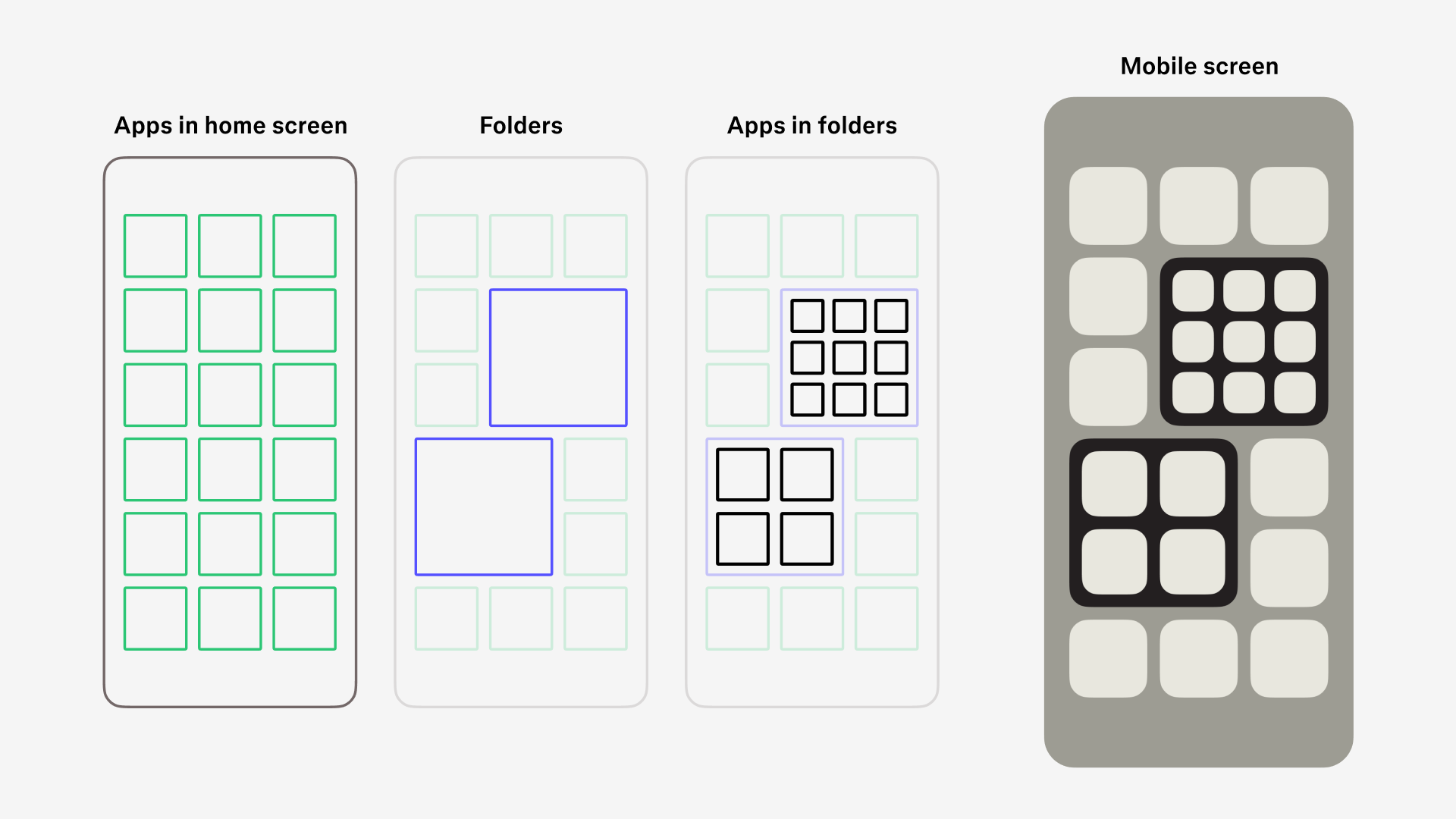

In the mobile home screen example below, there are three levels of auto layout:
- Apps in home screen: The apps on the home screen live in a top-level auto layout frame that uses a grid flow with three columns and six rows (3x6).
- Folders: The folders are auto layout frames that uses a grid flow. Each frame spans across four grid cells.
- Apps in folder: Within the folder frames, one uses a 3x3 auto layout grid, and the other uses a 2x2 auto layout grid.
