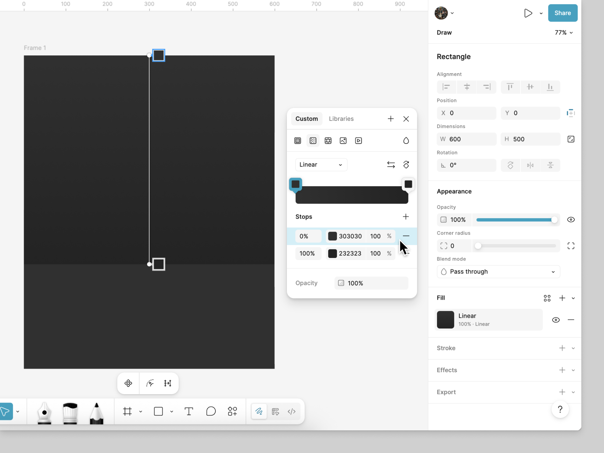

- Select the Frame tool in the toolbar, then add a 600 X 750 frame to the canvas.
- Change the frame’s fill to
#303030. - Use the Rectangle tool to add a 600 X 500 rectangle to the frame.
- Set the rectangle’s fill to a Linear gradient with two stops in the following positions:
- 0% with a fill of
#303030at100%opacity - 100% with a fill of
#232323at100%opacity
- 0% with a fill of
- In the left sidebar, click the Lock icon next to the rectangle layer to lock it. This prevents the layer from being accidentally moved while we continue working inside the frame.

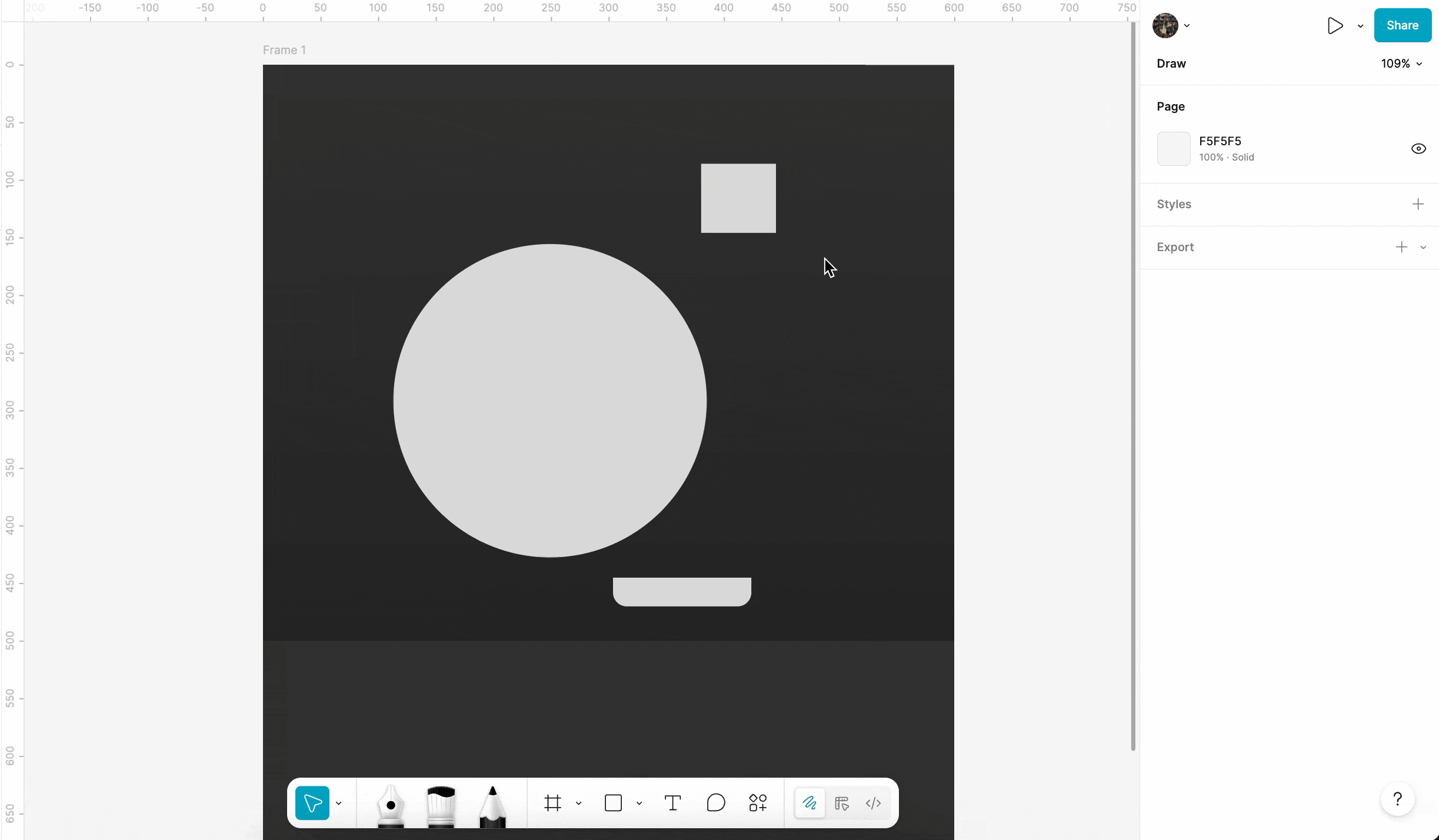

- Use the Ellipse tool to add a 272 X 272 circle to the canvas.

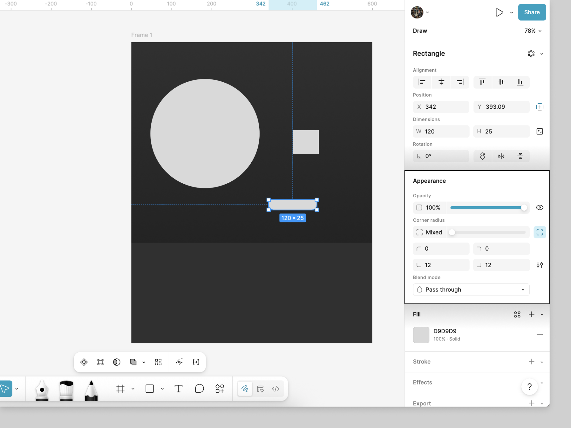

- Use the Rectangle tool to add a 65 X 65 rectangle and a 120 X 25 rectangle to the canvas.
- Select the 120 X 25 rectangle, then click Individual corners in the Corner radius setting. Change the radius of the bottom two corners to
12.

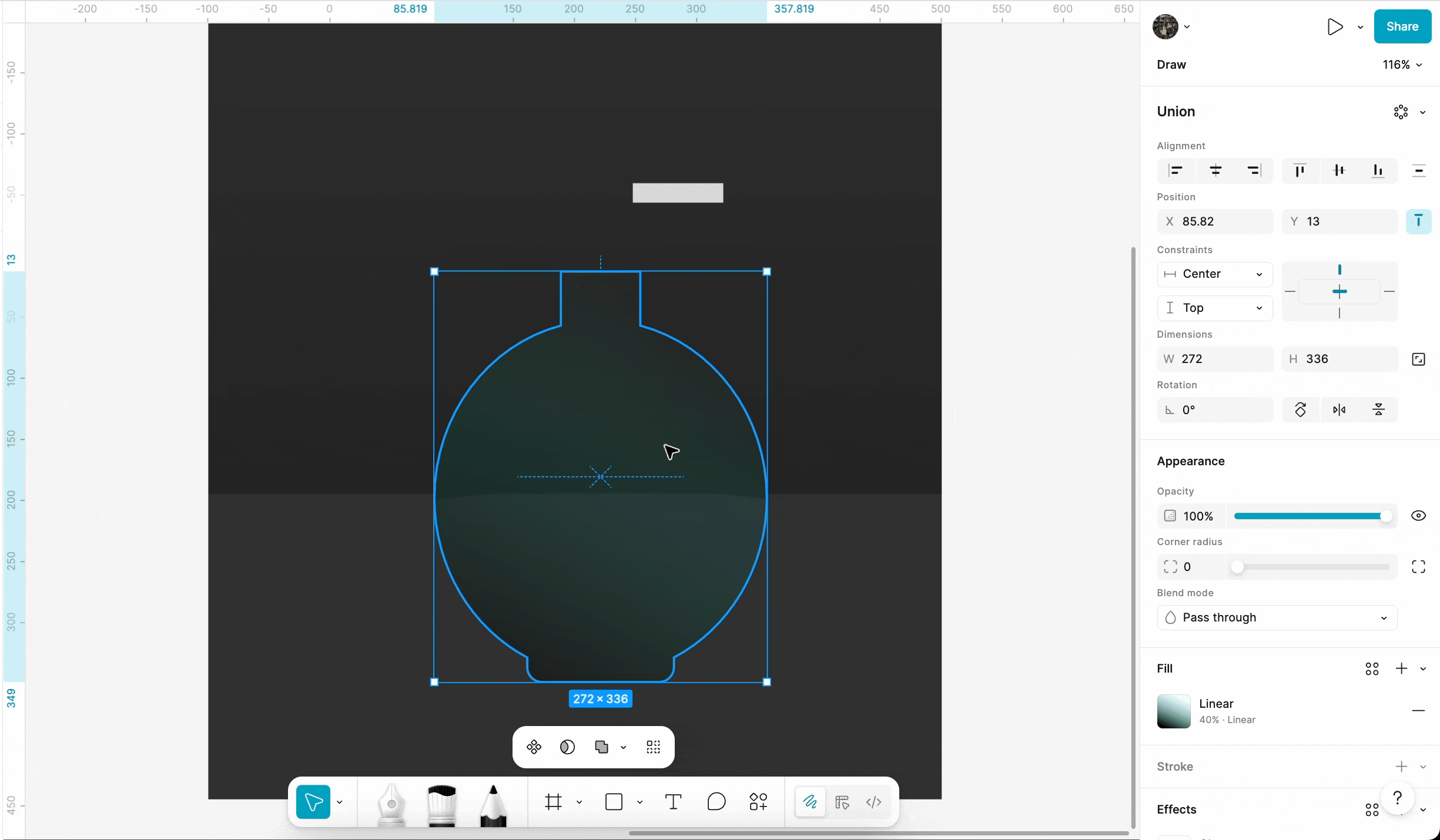

- Center the larger rectangle at the top of the circle and the smaller rectangle at the bottom, ensuring that the shapes overlap slightly. Use the red guidelines to help you align the shapes.
- Hold
Shiftand select all three shapes, then use the Union boolean operation to combine them. - Use the Position settings to move the vase to the following coordinates:

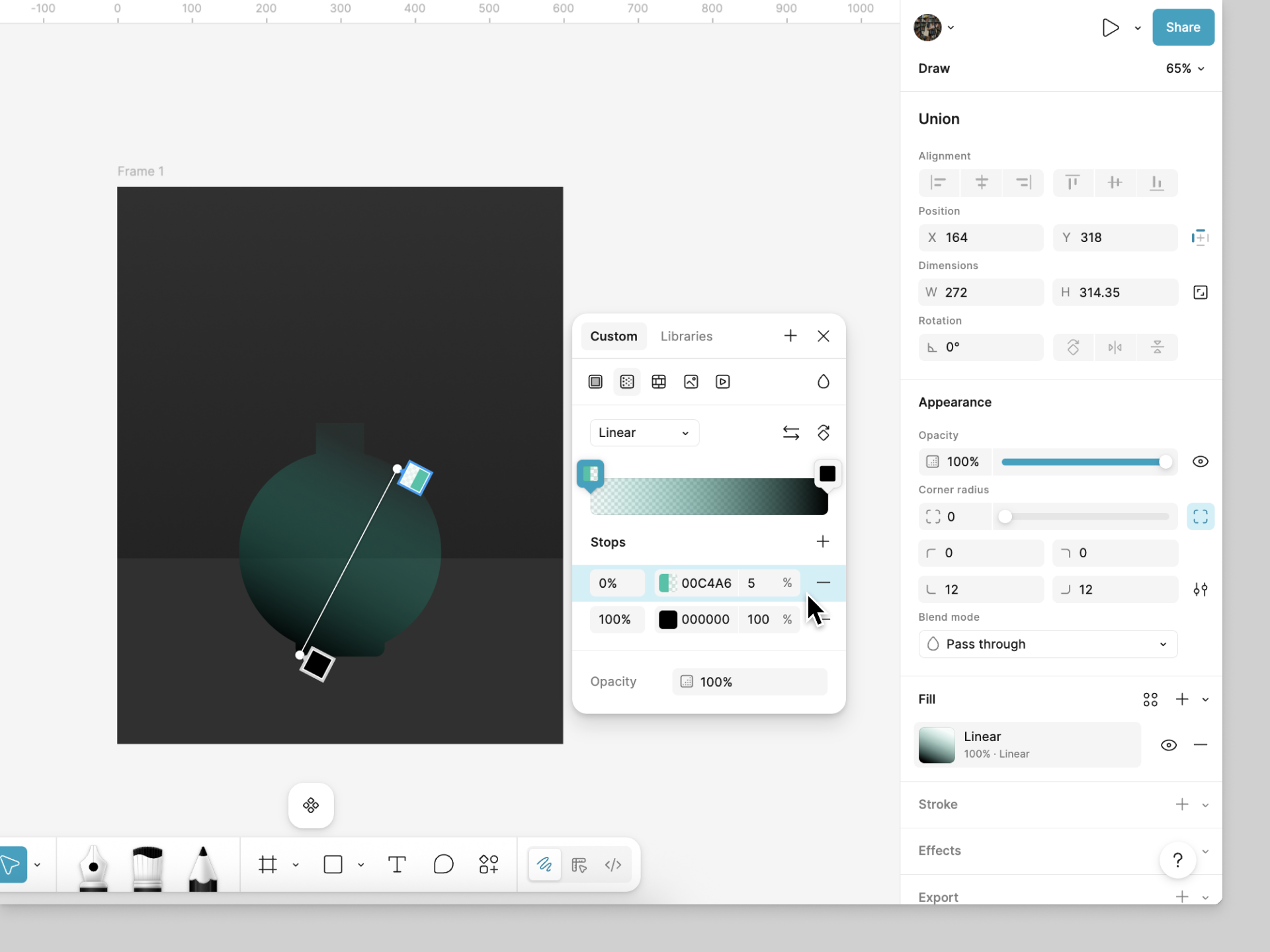

First, we’ll change the vase’s fill:
- Select the vase layer and change its fill to a Linear gradient with two stops in the following positions:
- 0% with a fill of
#00C4A6at5%opacity - 100% with a fill of
#000000at100%opacity
- 0% with a fill of
- Drag the darker stop to the bottom-left and the lighter stop to the top-right corners of the vase.

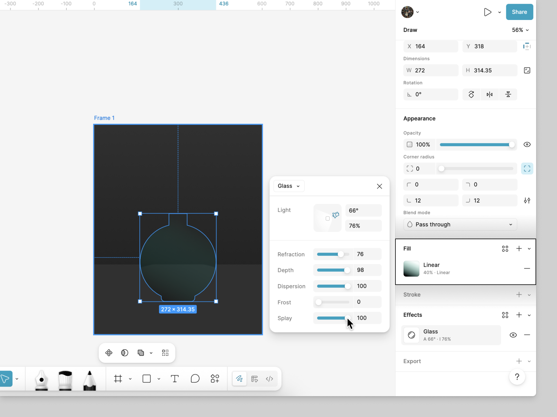

Next, we’ll add a glass effect to the vase for that translucent look:
- Select the vase layer, then open the dropdown menu in the Effects section of the right sidebar and select Glass.
- Change the Glass settings to the following:
Light angle:
66° -
Light intensity:
60% -
Refraction:
76 -
Depth:
98 -
Dispersion:
100 -
Frost:
0 -
Splay:
100
Light angle:
- Applying a glass effect to a layer automatically changes the layer’s fill opacity to
20%. Let’s use the Fill section in the right sidebar to bump up the fill opacity to40%. Learn more about using the glass effect.

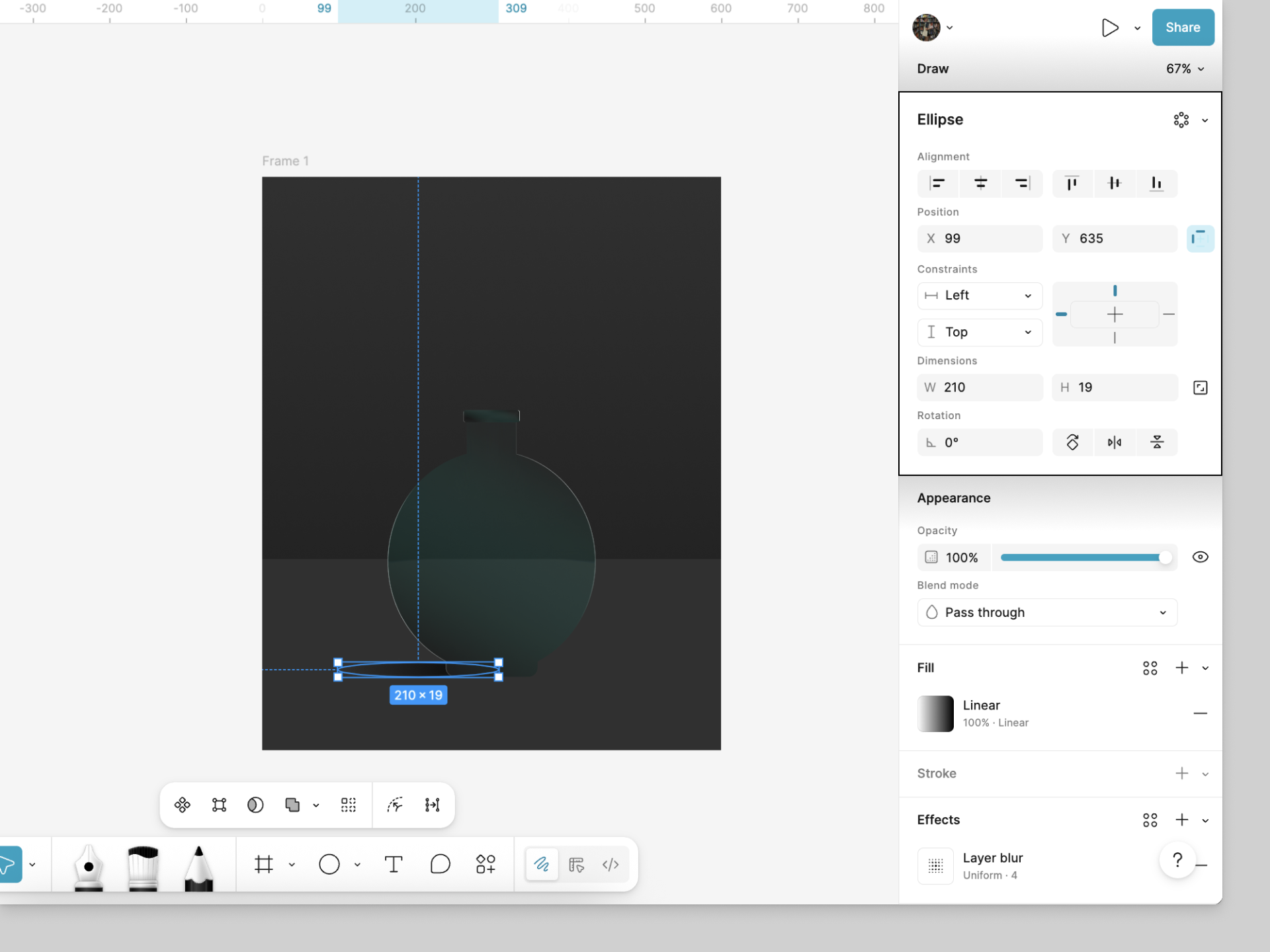

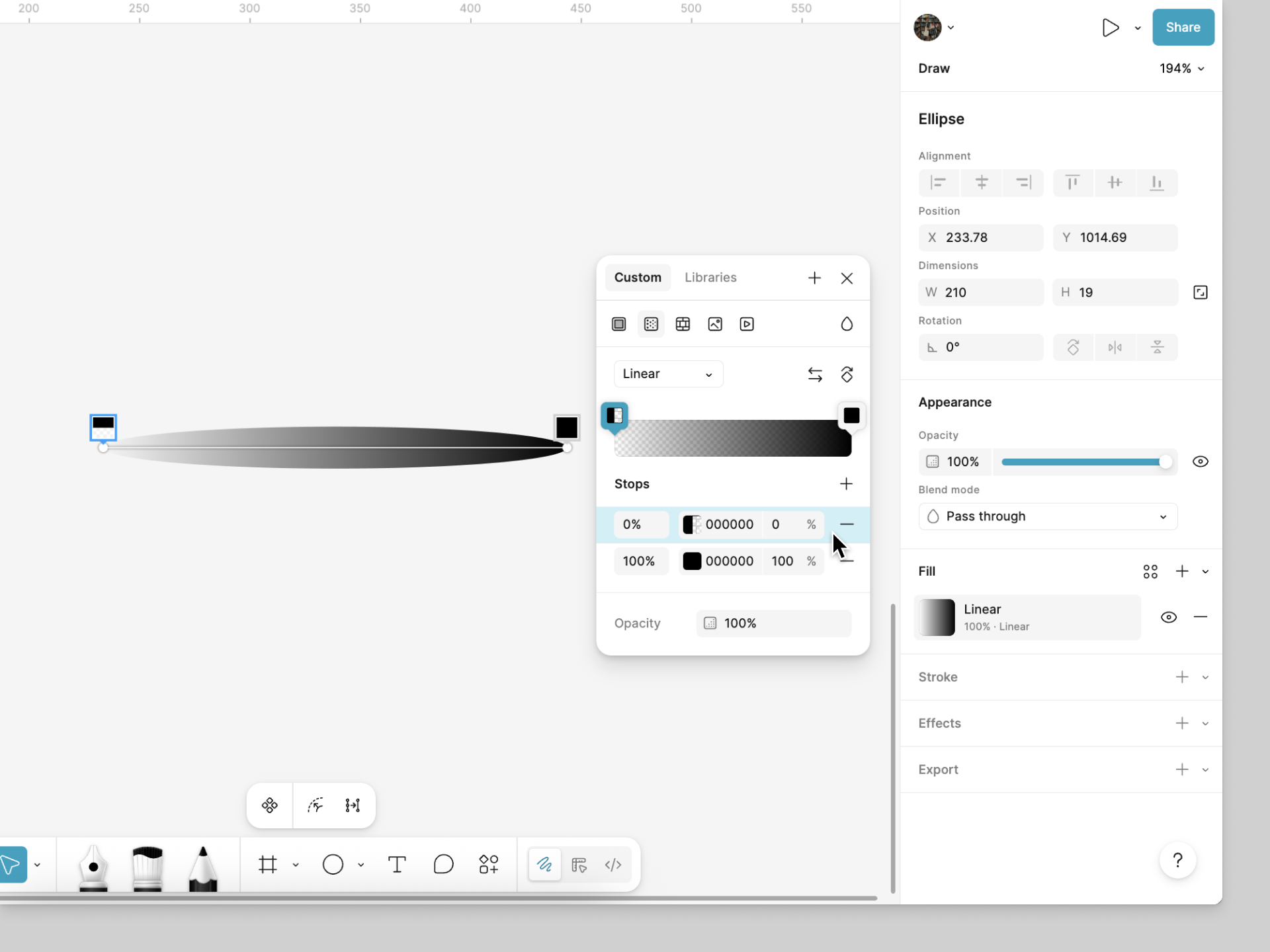

- Add a 210 X 19 ellipse to the canvas.
- Set the ellipse’s fill to a linear gradient with two stops in the following positions:
- 0% with a fill of
#000000at0%opacity - 100% with a fill of
- 0% with a fill of

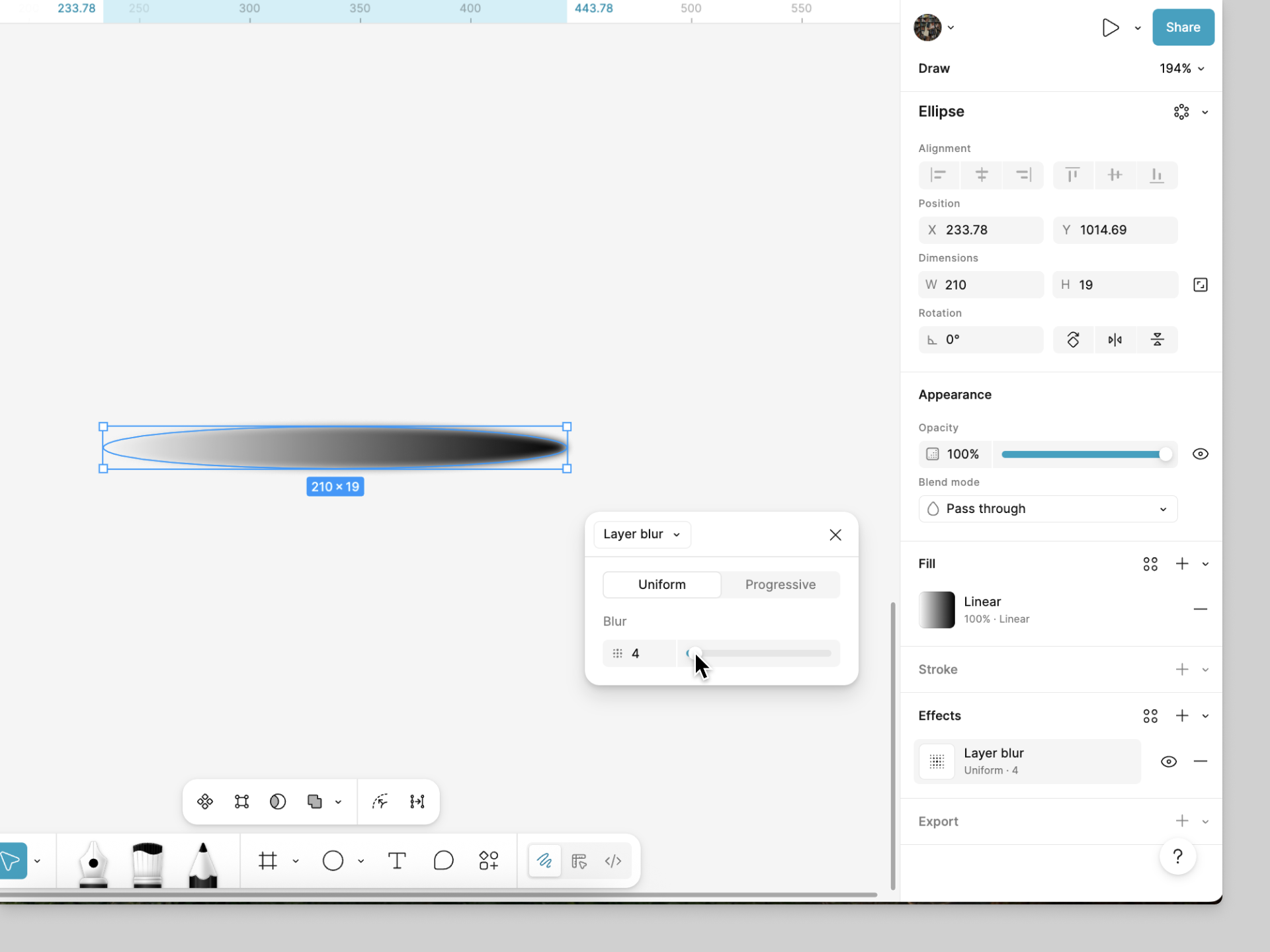

- Use the dropdown in the Effects settings to apply a Layer blur effect to the ellipse.
- Set the Blur amount to
4.
- In the left sidebar, reorder the ellipse layer so that it is below the other vase shapes.
- Use the Position settings to move the shadow to the following coordinates:
X-position:
99 -
Y-position:
635

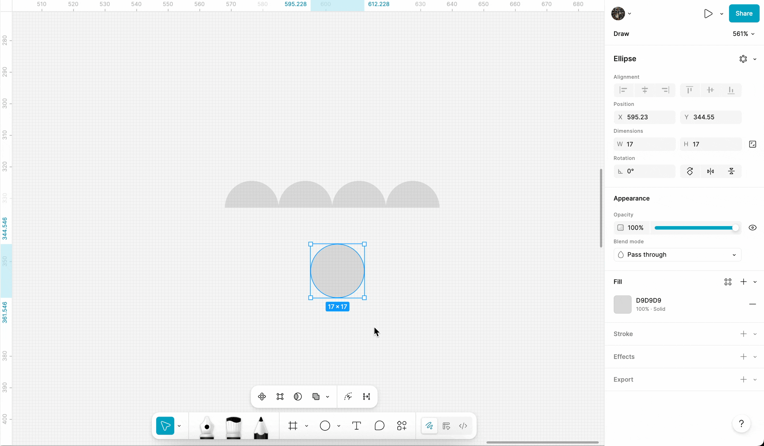

- Add a 17 X 17 ellipse to the canvas.
- Hover your cursor over the ellipse, then click and drag the arc tool handle to change the sweep to
-50%. - With the ellipse layer selected, select Linear repeat from the Additional transform modifiers menu in the right sidebar.
- Select the Repeat transform you just added to open the Transform settings, then change the Count to
4and the Gap to1 unit.

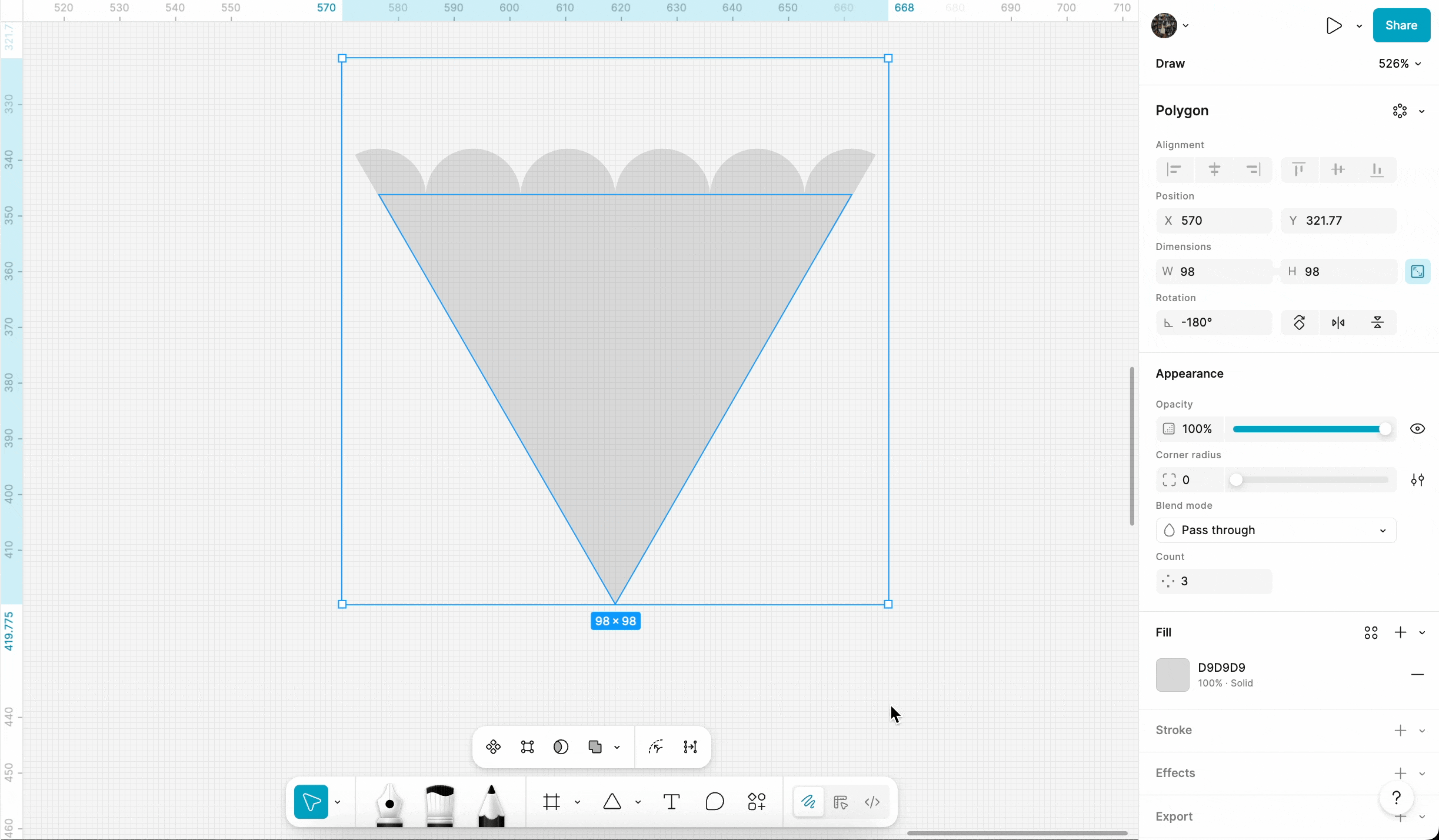

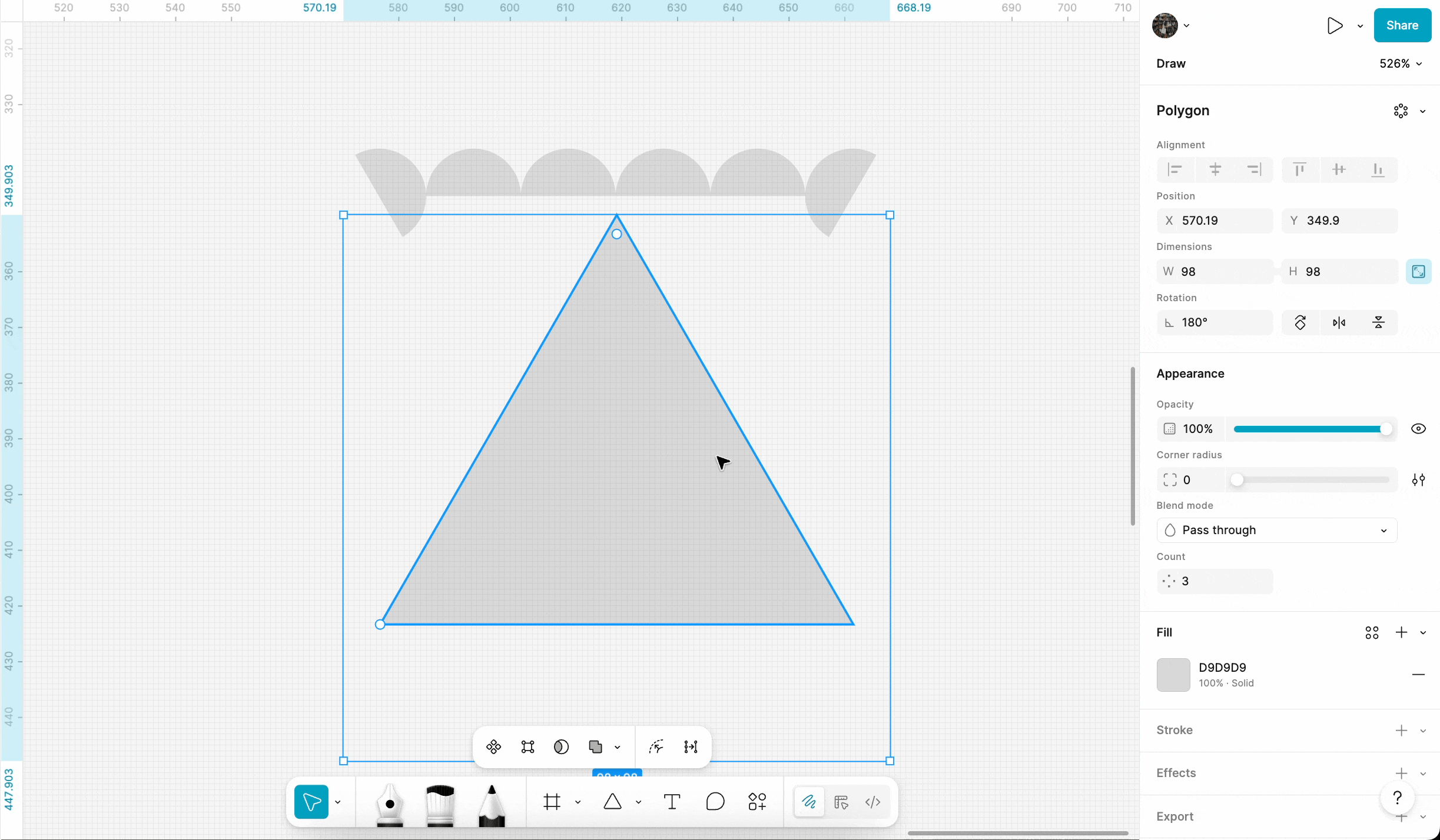

- Use the Polygon tool to add a 98 X 98 triangle to the canvas.
- Right-click on the triangle and select Flip vertical or use the shortcut Shift V.
- Align the triangle to the bottom edge of the linear repeat group.
- Select the triangle and press Enter to open vector edit mode.
- Select the bottom point of the triangle and set its Corner radius to
30. - Press Enter again to close vector edit mode, then select all of the shapes and use the Union boolean operation to combine them.

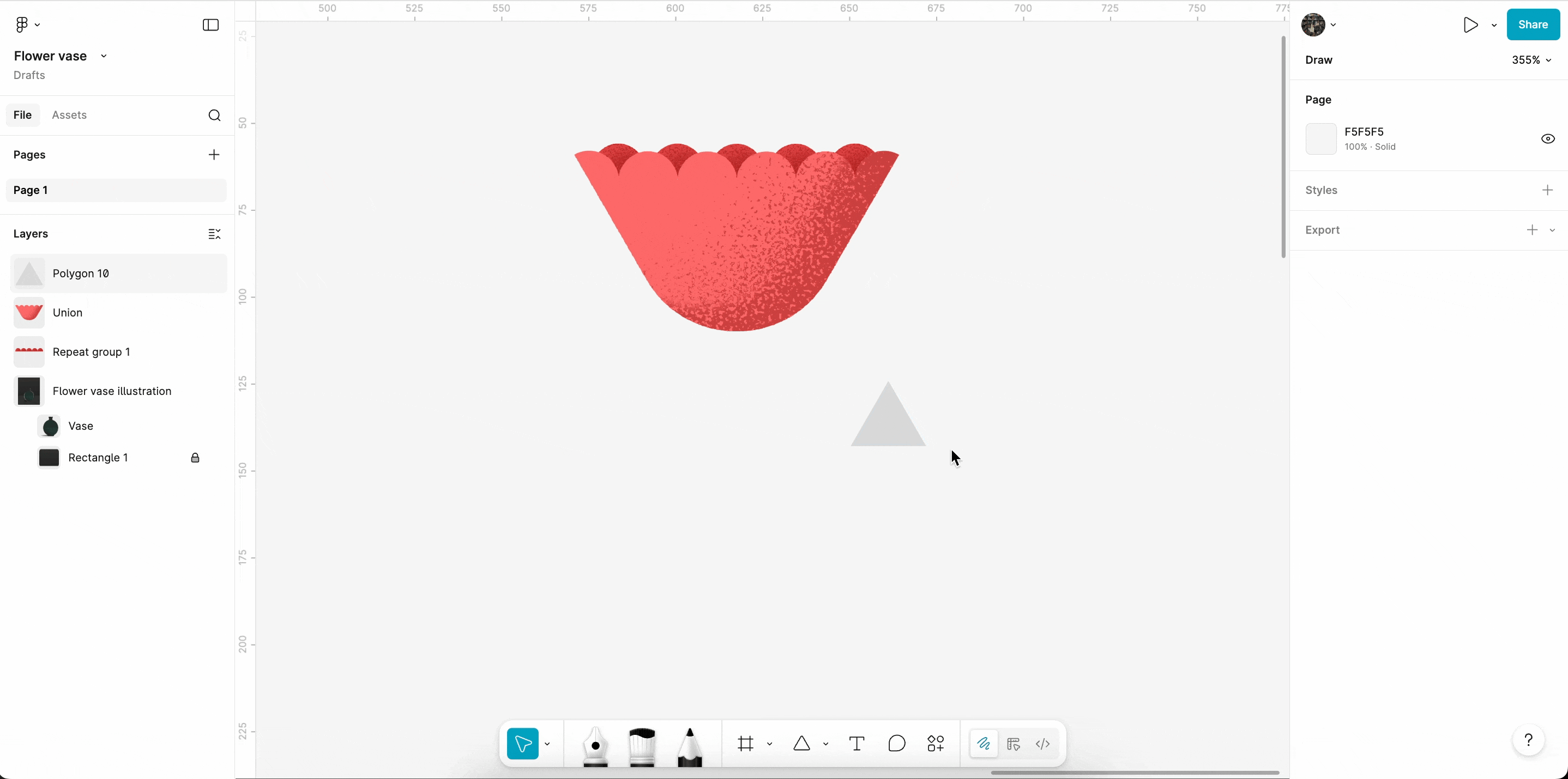

- Select the flower and use the Fill section in the right sidebar to change its fill to
#FF6868. - Use the Effects section to apply an Inner shadow effect and change the settings to the following:

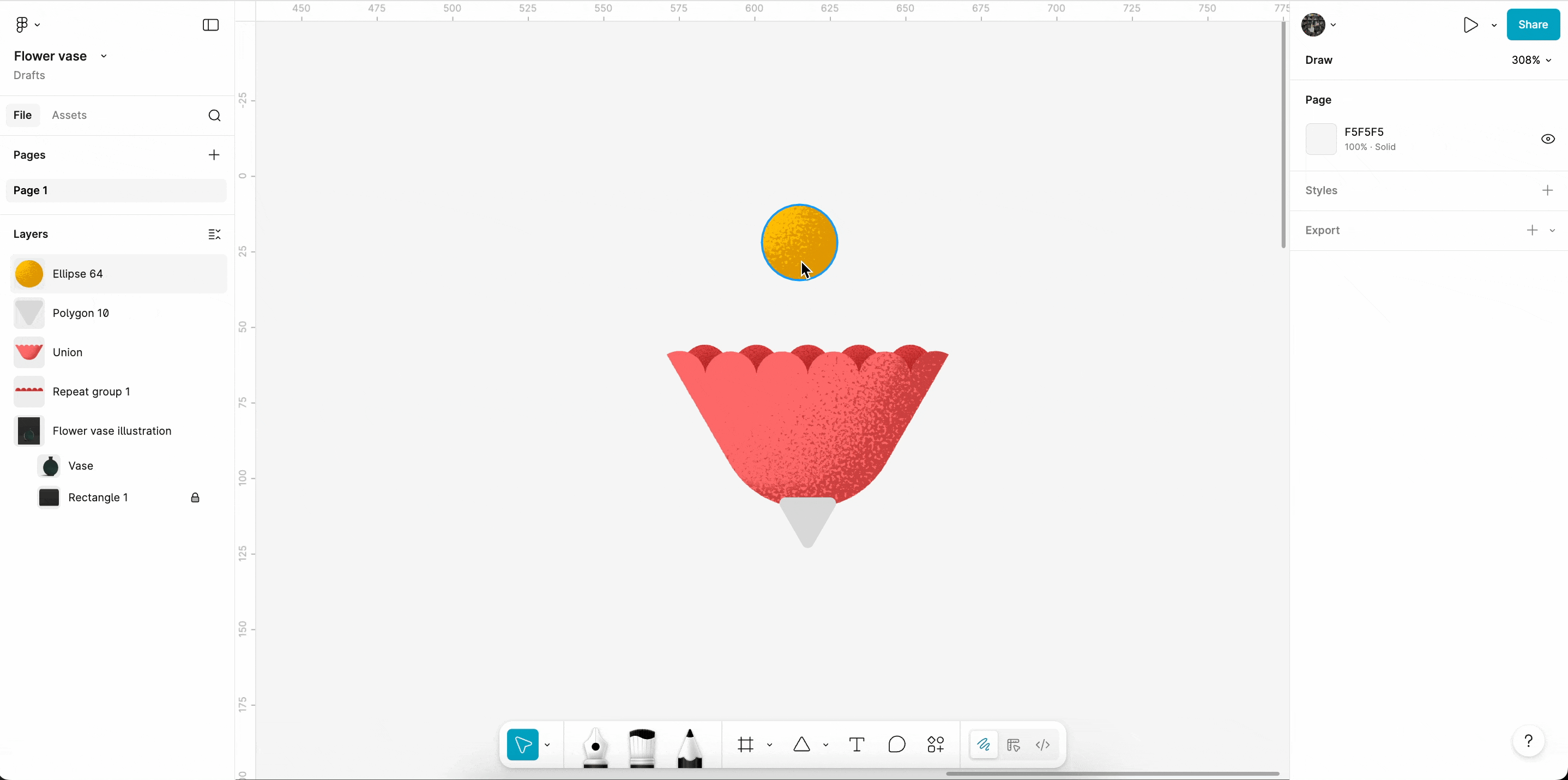

- Add a 25 X 25 ellipse to the canvas and change its fill to
#FFBF00. - Apply an Inner shadow effect with the following settings:
X position:
-11 -
Y position:
-10 -
Blur:
3 -
Color:
#DF9705at100%opacity
X position:
- Apply a Texture effect and change the settings to the following:
Size:
1 -
Radius:
18 -
Clip to shape:
Enabled
Size:
- Position the yellow circle at the horizontal center of the flower with the top just slightly above the petals, then reorder its layer position so that it is between both sets of petals.
- Select all four layers of the flower and add them to a frame.
- Rename the frame to
Flower.

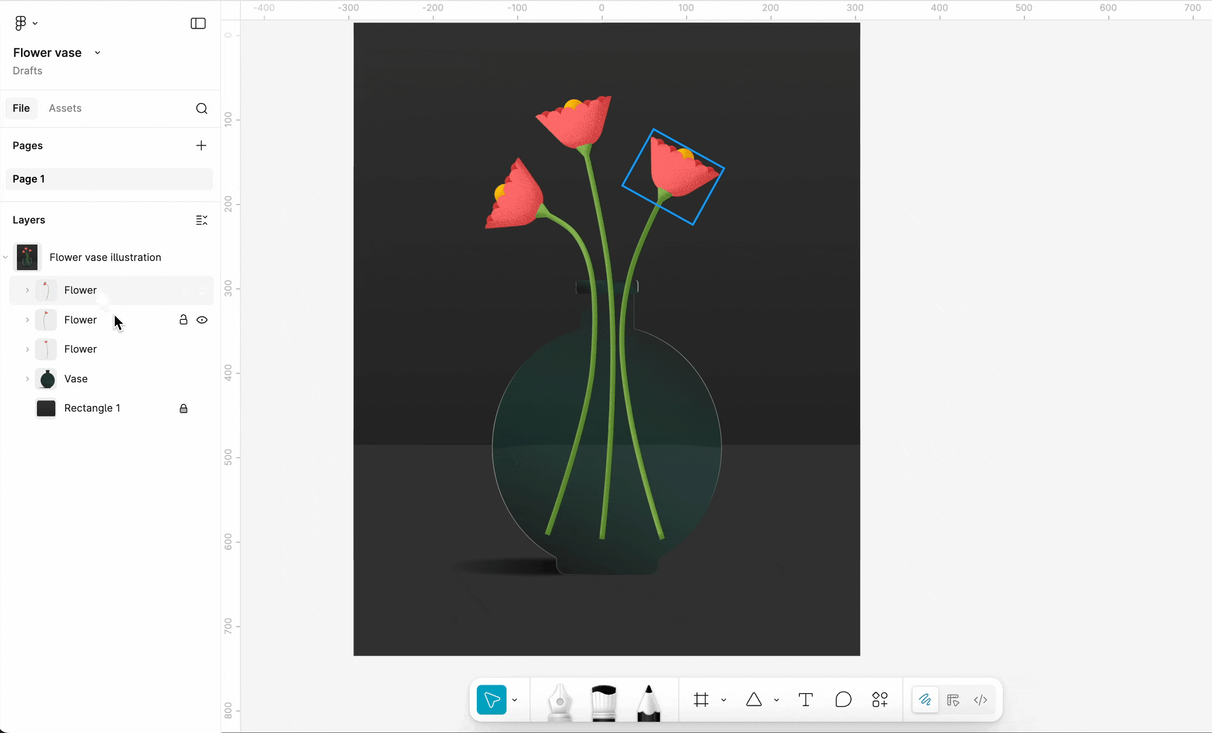

- Select the flower frame and duplicate it twice using the shortcut:
- Mac: Command D
- Windows: Control D
- Arrange the three flowers around the vase. Exact placement is not important so feel free to play around with different positions and rotations.

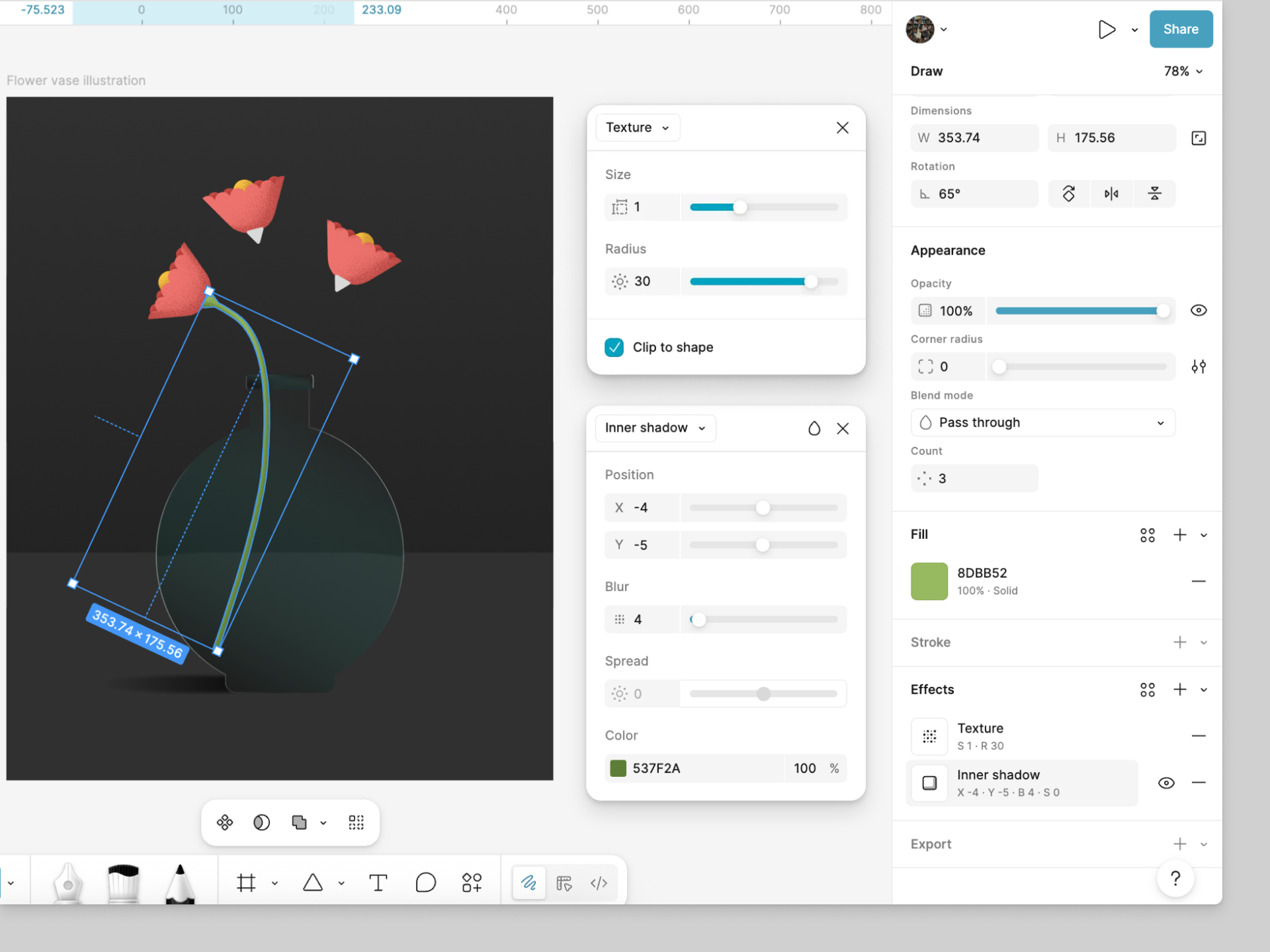

- Select the Pen tool in the toolbar.
- Set the Stroke weight to
6, then click inside one of the stem bases you added in the previous section to add your first point. - Continue to reposition the Pen tool and clicking to add additional points until you reach the bottom of the vase.
- Enable the Bend tool and click on each point to curve the path for a more natural looking stem. You can then use the Move tool to adjust the bézier handles and change the length and slope of the curve.
Add colors and effects
- Select the stem base and the stem, then use the Union boolean operation to combine them.
- Set the Fill to
#8DBB52. - Apply an Inner shadow effect with the following settings:
X position:
-4 -
Y position:
-5 -
Blur:
4 -
Color:
#537F2Aat100%opacity
X position:
Size:
1 -
Radius:
30 -
Clip to shape:
Enabled
Size:
- Create the other two stems. Remember that you can copy and paste properties between layers to save time!

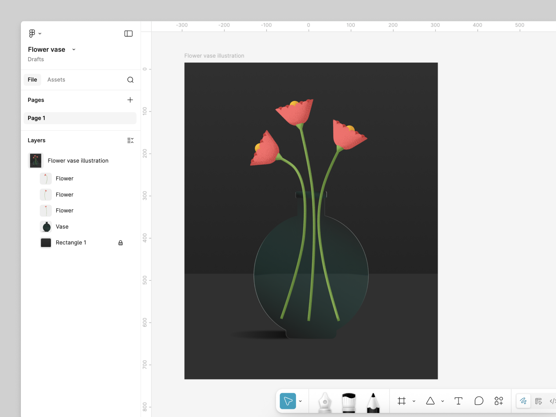

Place the flowers in the vase
Once you’re happy with your flower arrangement, it’s time to place them inside the vase.
- Select all three Flower layers in the left sidebar.
- Click and drag them below the Vase layer in the layer order.

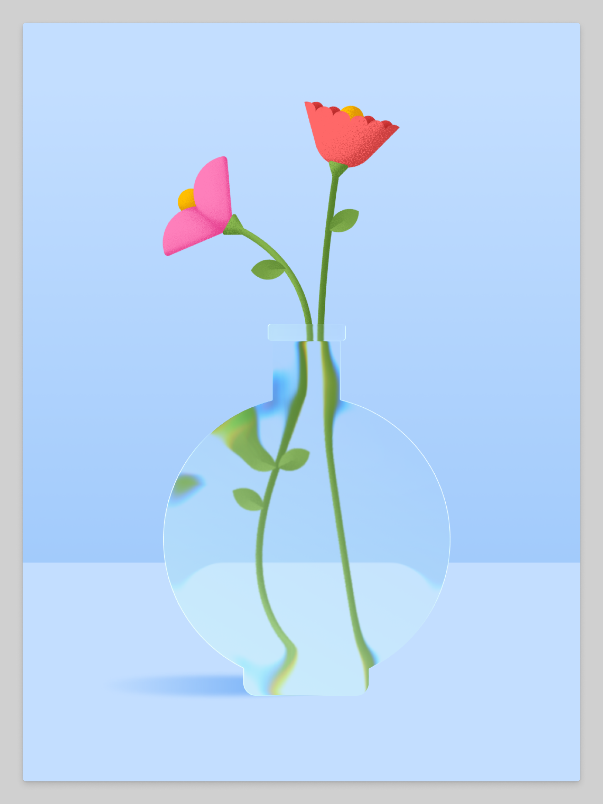

Notice how the glass effect distorts and bends the layers beneath it, creating a realistic illusion that our flower stems are submerged in a glass vase filled with water!
