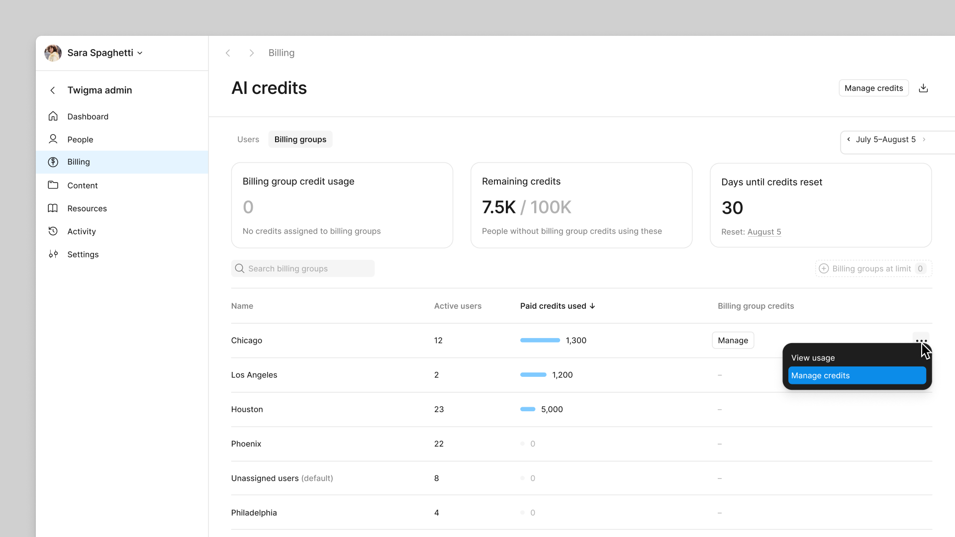

To set aside credits for a billing group:
- Open the file browser by logging in to your account at figma.com. If you’re in a file, click the Figma menu > Back to files.
- Click Admin.
- In the AI credits section, click Manage.
- Select the Billing groups tab.
- Hover over a billing group row and select More > Manage credits.
- In the modal, use the slider to to set a number of credits aside for the billing group.
- Click Assign credits to confirm.
After confirming, the updated credit amount will appear in the Billing group credits column of your AI credits dashboard.
To change the amount of credits for a billing group, repeat the steps above and enter a new value. To remove credits for a billing group, set the value to 0.

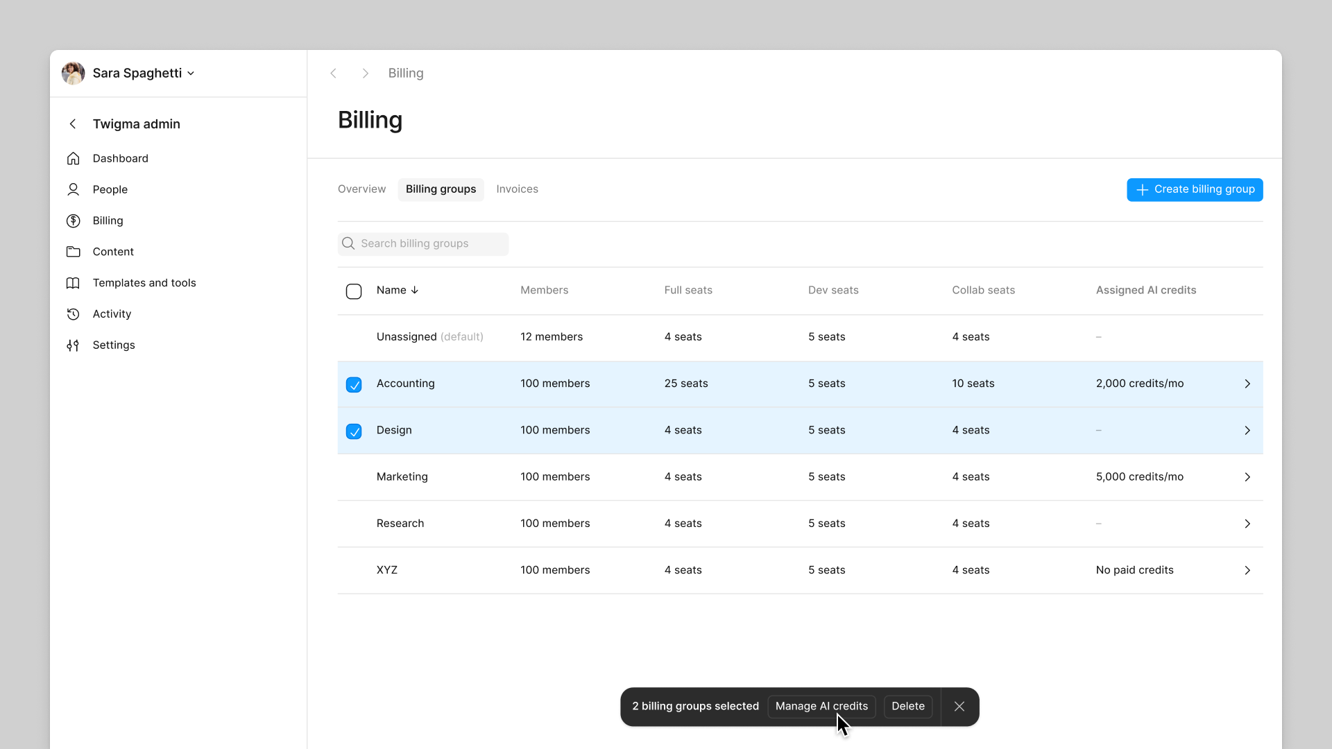

Organization admins can also view and manage billing group AI credits from Admin > Billing > Billing groups. From this page, you can bulk assign AI credits by selecting multiple billing groups and choosing Manage AI credits from the bulk actions toolbar.
Understand the AI credit dashboard
To track how each billing group is using AI credits:
- Click Admin.
Each row represents a billing group, with a summary of its usage and available credits.
If you have set aside any billing group credits, the top of the Billing groups tab shows:
- Billing group credit usage: The total number of billing group AI credits used and set aside across all billing groups.
- Remaining credits: Credits that haven’t been set aside for a billing group. Billing groups without credits set aside will use these.
- Days until credit reset: The number of days until credits reset for the next billing cycle.
