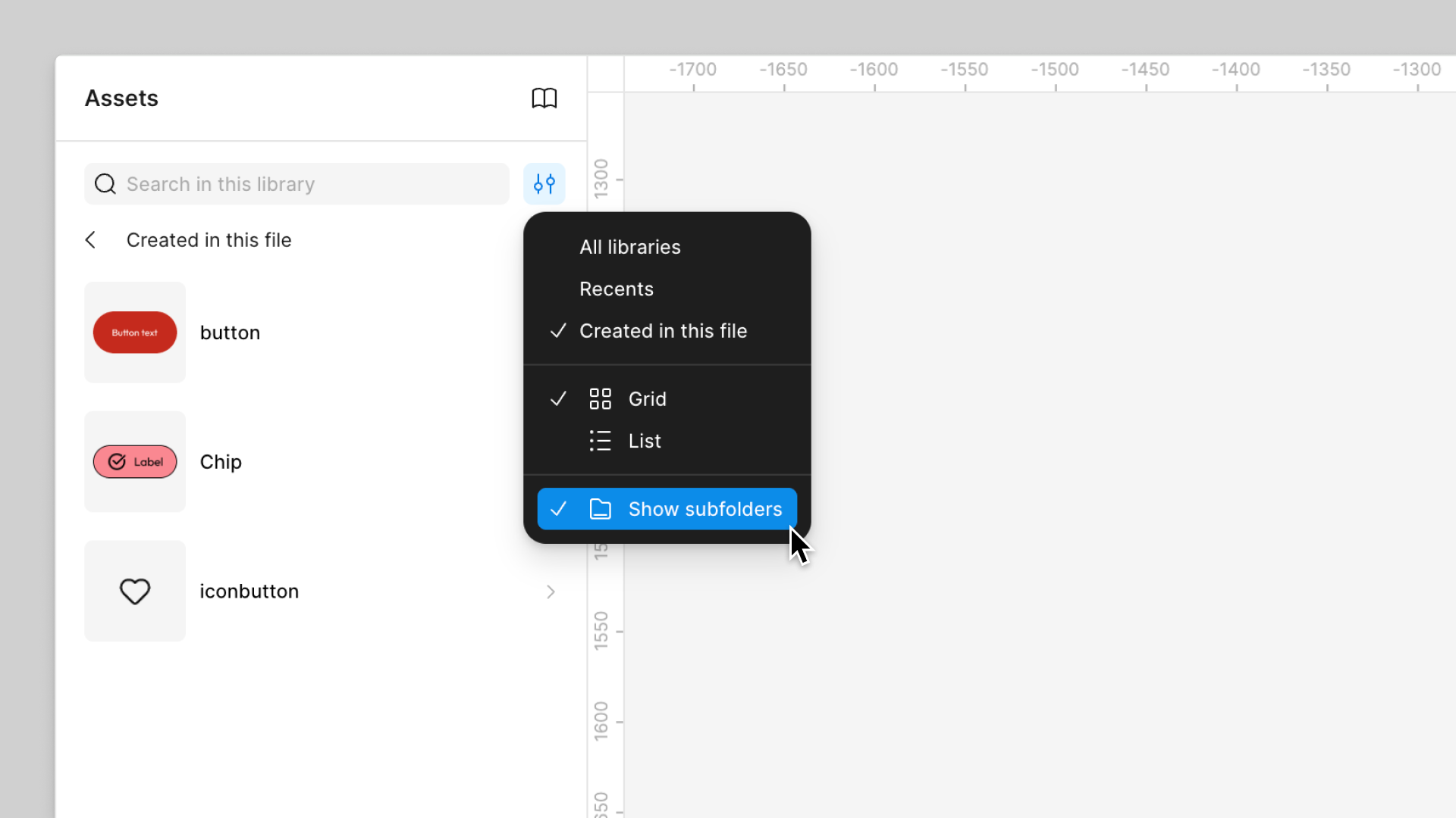

Figma uses the slash-separated naming convention to organize components in a file. Each slash ( / ) in a component’s name creates another level of hierarchy. Using the slash-separated convention also groups related components together in the Assets tab and Instance menu and makes it immediately clear where a component lives in the broader design system.
For example:
button/primary/defaultbutton/primary/hoverbutton/secondary/defaultbutton/secondary/hover
Note: When you have slash-separated component names, you can enable the Show subfolders setting to display components in a nested folder structure that mirrors your naming hierarchy. This is a helpful way to navigate large design libraries.

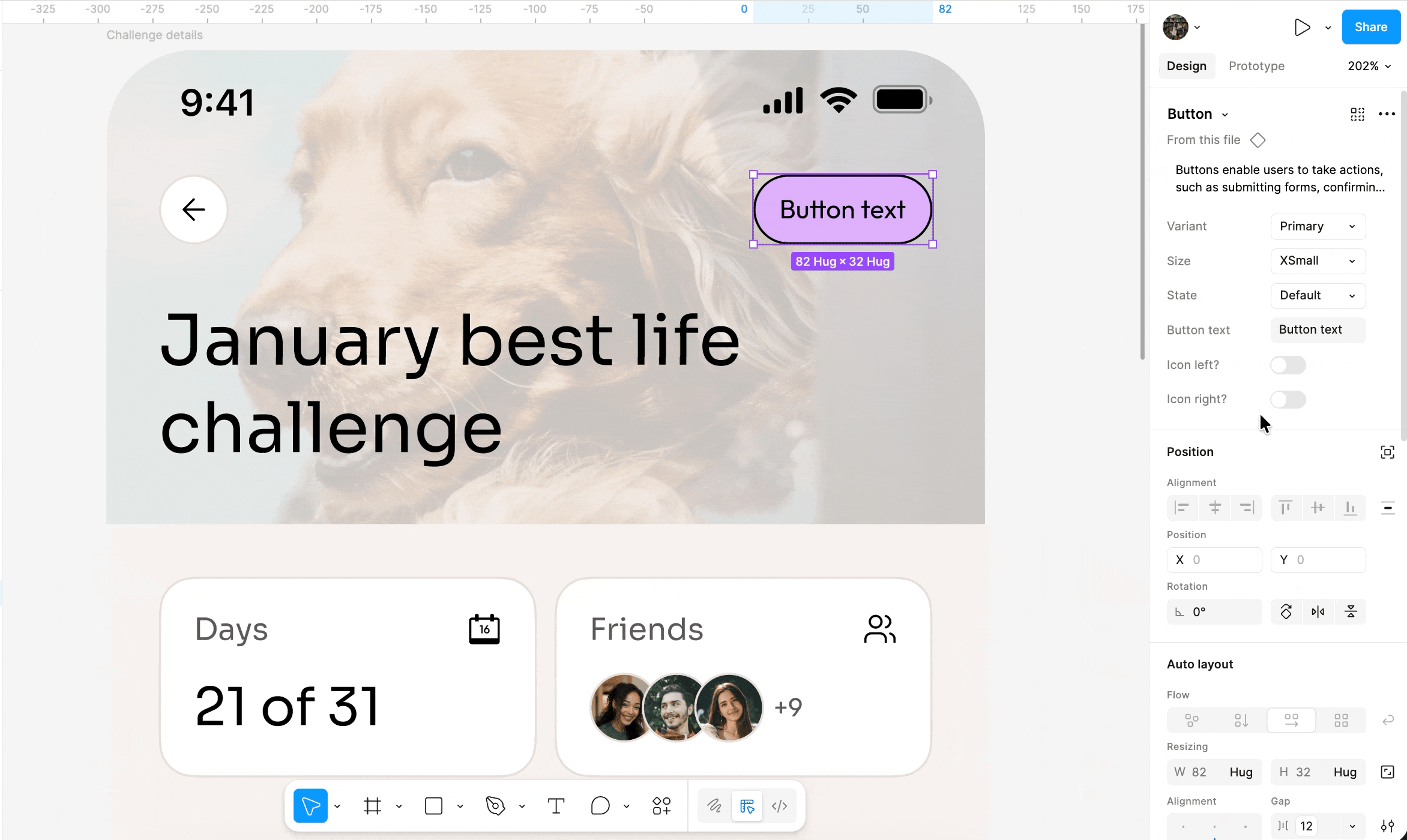

Use component properties to expose the right controls
Component properties and variants let you control how flexible a component should be. When building a component, consider which aspects people will need to change about it and what’s the easiest way to expose those controls.
Use variants to handle visually or structurally distinct states. For example:
- Style: How prominent or interactive a component appears
- Size: How a component scales for different contexts
- State: How a component responds to user interaction
Use component properties to handle changes at the content-level, without multiplying the number of variants needed to capture each unique state. For example:
- Boolean properties: Show or hide an element
- Instance swap properties: Swap nested components for another
- Text: Expose editable text layers directly in the right sidebar
- Slots: Create flexible areas where content can be freely added and organized

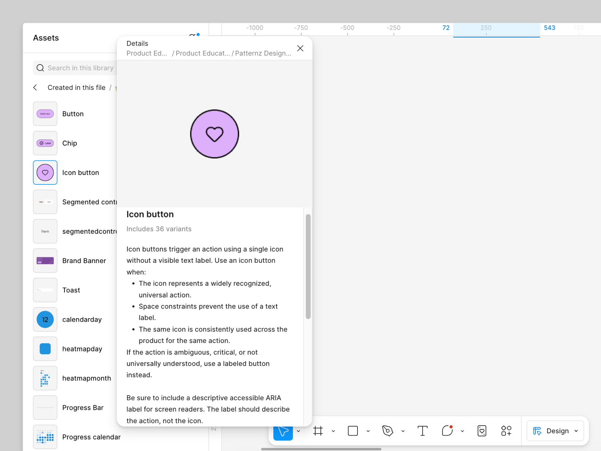

Add context to your components
When creating components, you can use the component settings to add a description. Descriptions don’t need to be long, but a few sentences explaining how the component should be used and any constraints to keep in mind can go a long way. For example, a label-less icon button component may include a description like:
Icon buttons trigger an action using a single icon without a visible text label. Use an icon button when:
- The icon represents a widely recognized, universal action.
- Space constraints prevent the use of a text label.
- The same icon is consistently used across the product for the same action.
If the action is ambiguous, critical, or not universally understood, use a labeled button instead.
Component descriptions appear in the Assets tab when someone selects a component and in the right sidebar when they select an instance. If your team hosts documentation outside of Figma, you can also include a link directly in the description to point people to more information. Learn more about adding descriptions to components.

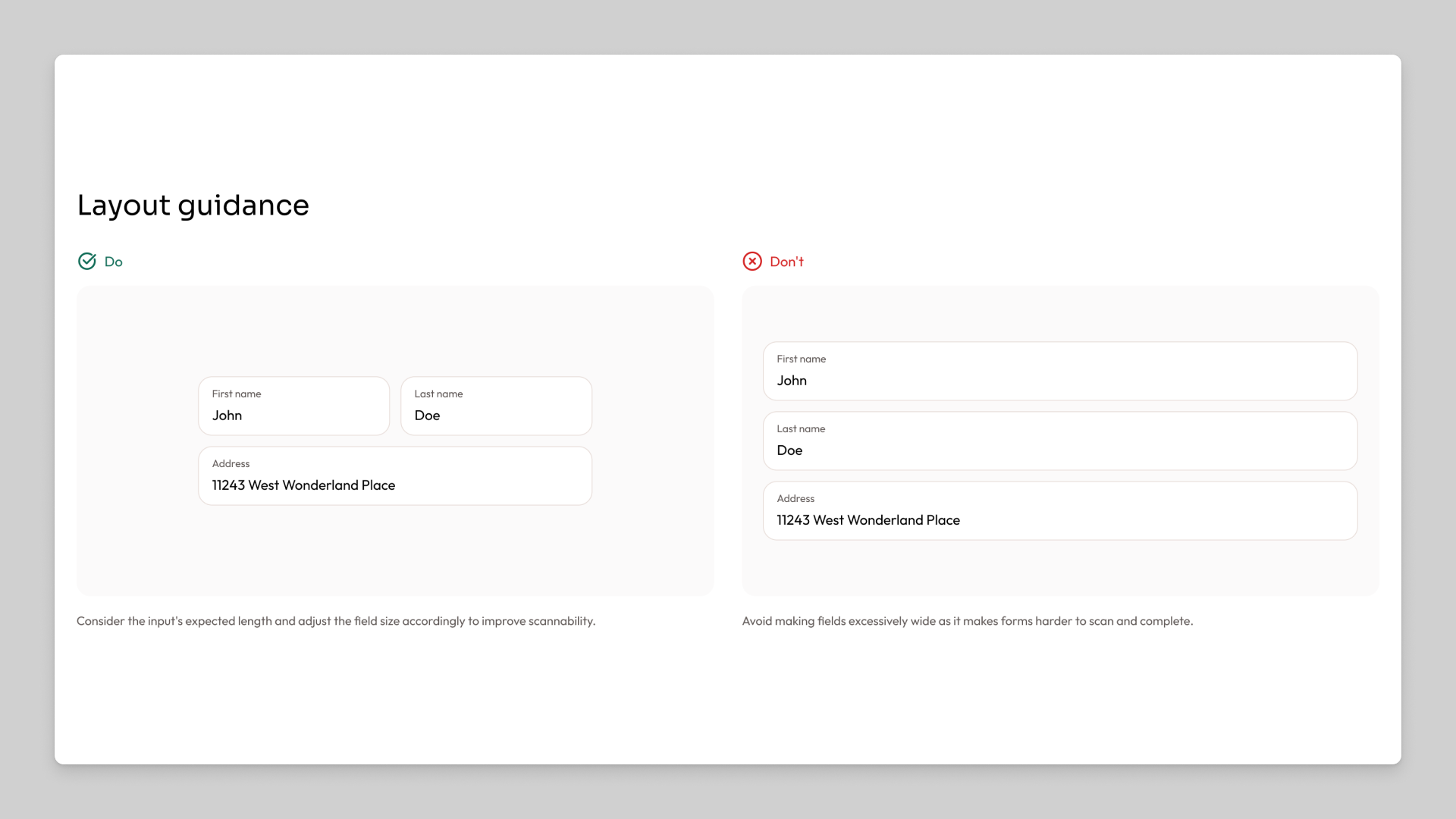

Include do’s and don’ts
For components that are commonly misused or have non-obvious constraints, explicit do/don’t guidance is one of the most effective things you can include in your documentation.
Keep do/don’t usage specific and pair it with a visual example where possible.

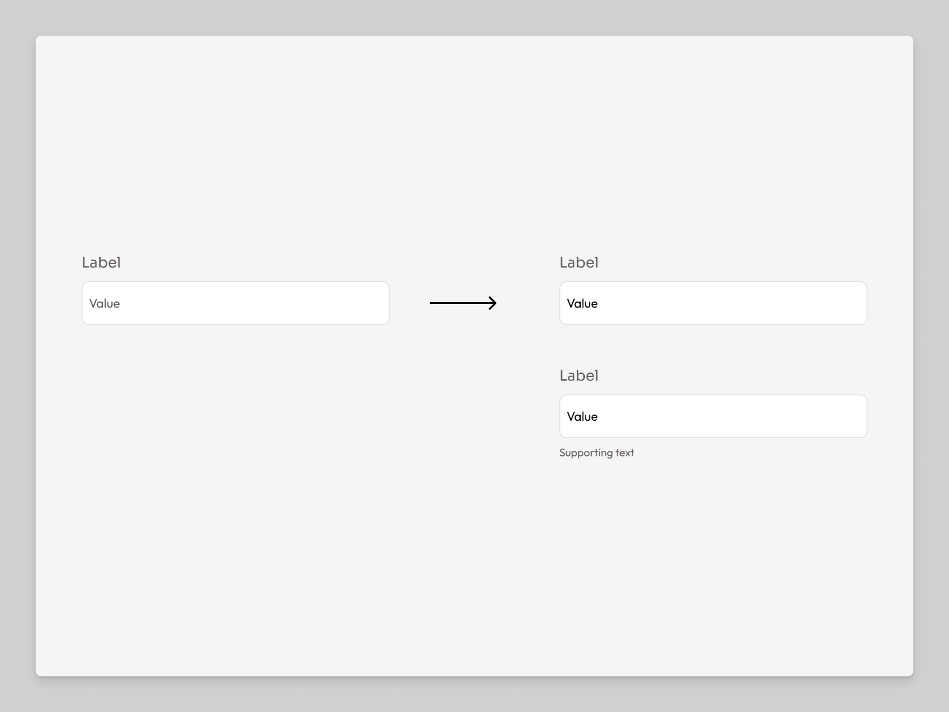

For example, adding a hidden-by-default boolean property for an optional supporting text string is a non-breaking change. The string won’t display unless a designer explicitly enables it, so the change can be published without fear of impacting existing instances.

Using the same example, if that new supporting text string is shown by default instead of hidden, the change becomes breaking. Any existing instances of the component will now display placeholder text in designs, even if the designer doesn’t want it to, requiring them to manually locate every instance and toggle the string’s visibility.

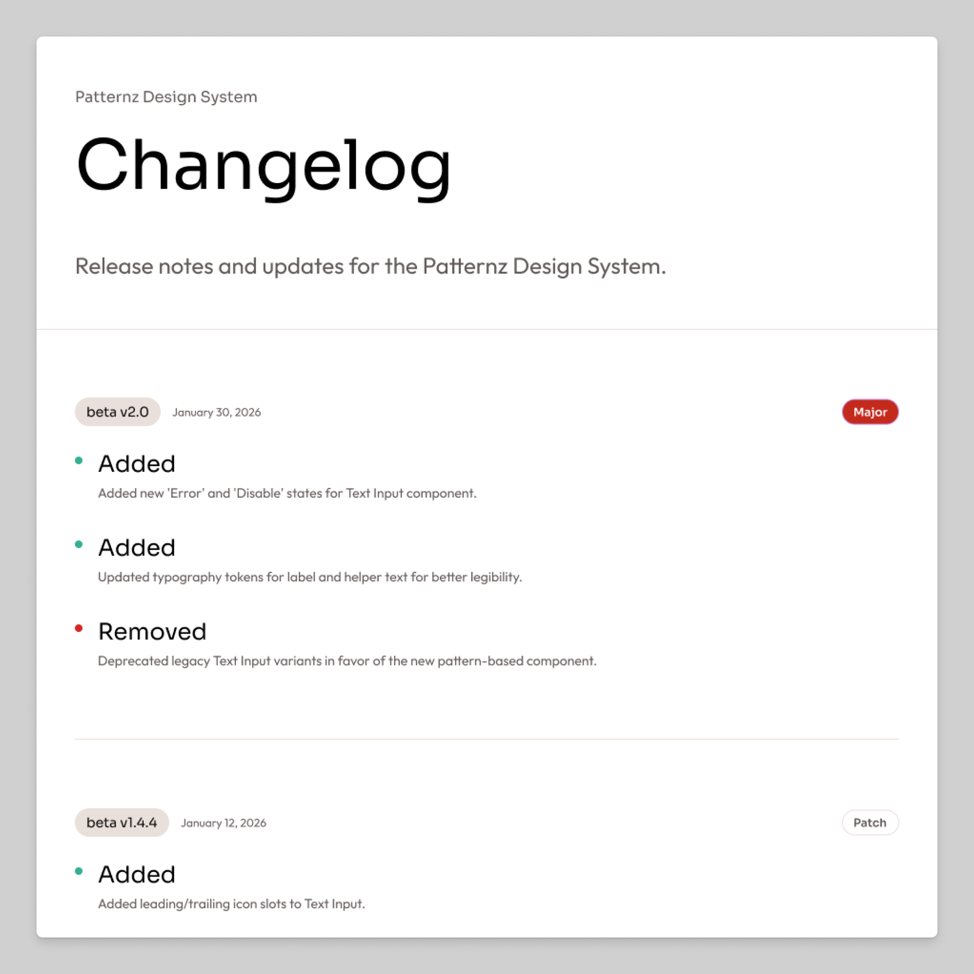

If you work with others using a shared library, a single published component change can potentially affect dozens of open files and impact the work of other designers. This is why communication is as important as the component update itself.
We recommend developing a communication process with your team. Consider creating a changelog that includes a running record of what changed, when, and why. This can live inside a Figma file or wherever your team documents decisions. Including clear labels such as [UPDATE], [BREAKING], or [DEPRECATED] in your changelog can help people quickly assess how much they need to pay attention.
