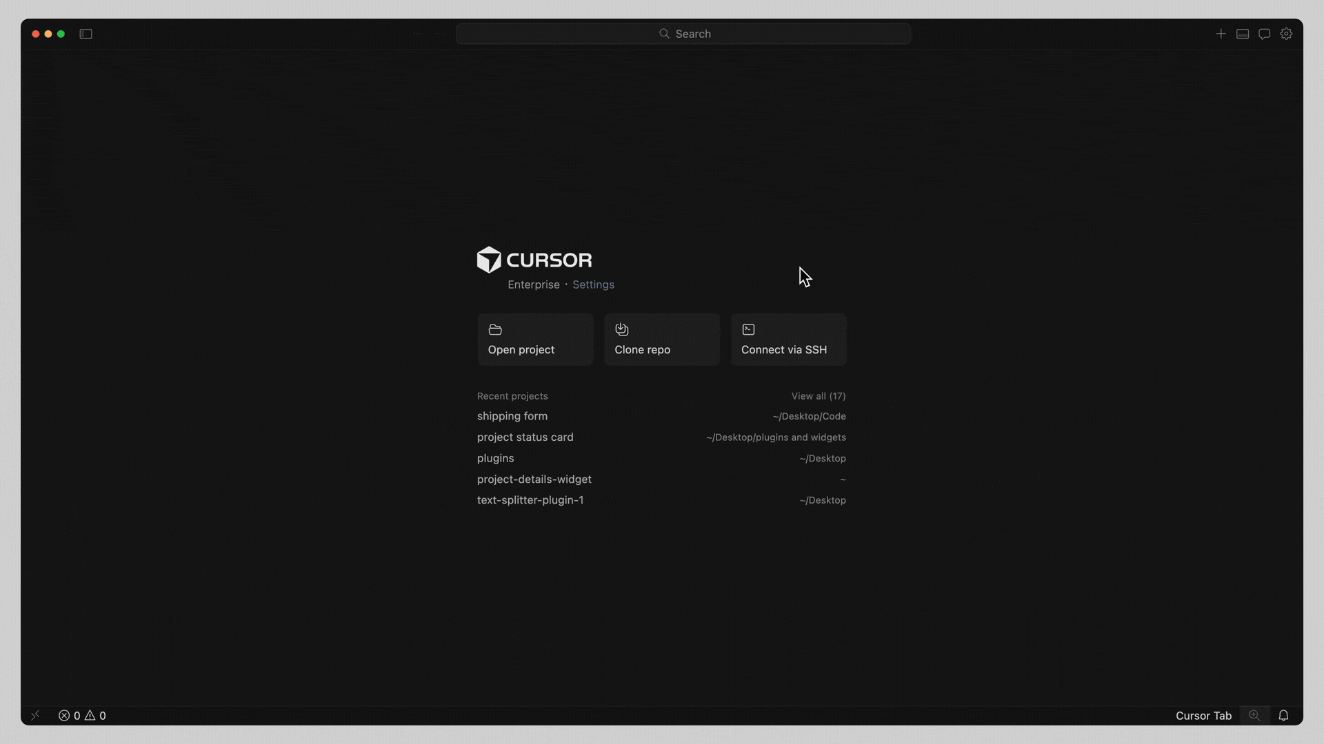

- Open the command palette:
- Mac: Cmd Shift P
- Windows: Ctrl Shift P
- Search for Open chat.
In the chat, enter this command and click Submit:
/add-plugin figma
You can also install the plugin from the Figma plugin page in the Cursor Marketplace.
- Click Add Plugin.
- When the installation finishes, open the command palette again and search for Cursor Settings.
- Select Tools & MCP.
- Under Installed MCP Servers, click Connect next to Figma.
- When prompted, click Allow access to let Cursor access your Figma account.
The Figma MCP server is now on in Cursor, and you're ready to start prompting. To see what you can do, check out Tools and example prompts.
