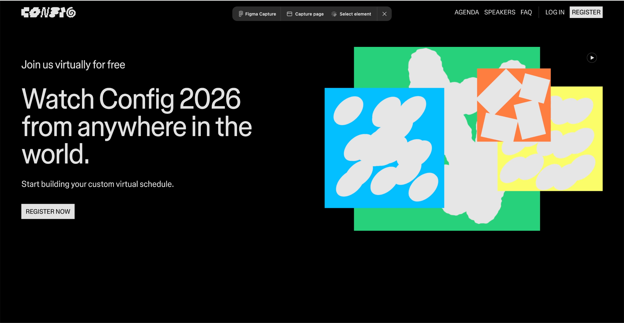

Capture code-backed screens and bring them into Figma Design and FigJam as design layers. Use the editable layers on the canvas in Figma Design to riff on your production websites, pull real-world inspiration into your FigJam files, jump-start a Figma Make prototype, or revive legacy designs on the canvas.
Methods
There are few methods for capturing coded screens and bringing them into Figma as editable design layers:
- Use the Figma Chrome extension in your browser
- Copy design layers from a Figma Make preview
- Use the Code to canvas tool
generate_figma_designvia the Figma MCP server
Click the links above to view step-by-step instructions on how to use each method. Below, we’ll cover common workflows, how to incorporate existing variable libraries into the designs, and troubleshooting tips.

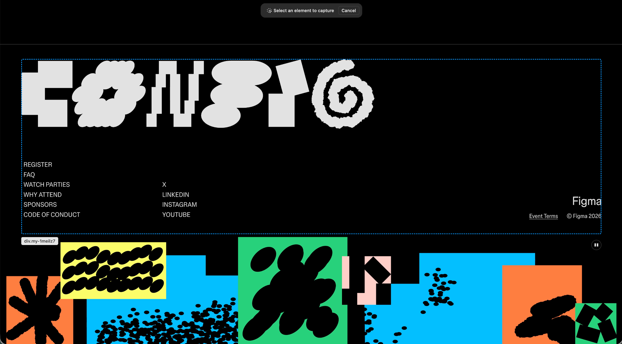

Tips for better captures
- Scroll first on animated pages. For pages with dynamic scrolling effects (like marketing sites with reveal animations), scroll all the way to the bottom of the page before triggering a page capture. This activates the page's interactions so they're included in the capture.
- The most recent capture is on your clipboard. You don't need to click anything in the tray, just go to the canvas in Figma Design or FigJam and paste.
- Define the variable code syntax for exact mapping. Figma prioritizes connecting variables based on matching the variable name from the webpage’s extracted CSS to the code syntax of the variable in Figma. Learn how to define the code syntax.
Use readable CSS variable names. Some site's build process shortens or scrambles variable names (for example,
-font-sizebecomesvar(--Mhs7de)), Figma won't be able to match them to your variable code syntax and names in Figma. - Capture from your dev server URL if variable names don't match. Dev servers typically preserve readable variable names, which allows Figma to match them to your Figma variables.
What's not currently supported
- No component and styles mapping yet. Captures come in as plain Figma layers with variables bound if any are available. They are not automatically mapped to your library components or styles. Further design system support is on the roadmap.
Complex scroll-driven or canvas-rendered sites may capture imperfectly. Pages that use heavy JavaScript animation,
<canvas>rendering, or virtualized lists may not translate cleanly. If a capture looks off, try element capture on the specific section instead of the whole page. -
chrome://and other privileged pages can't be captured. The extension button has no effect on internal Chrome pages.
