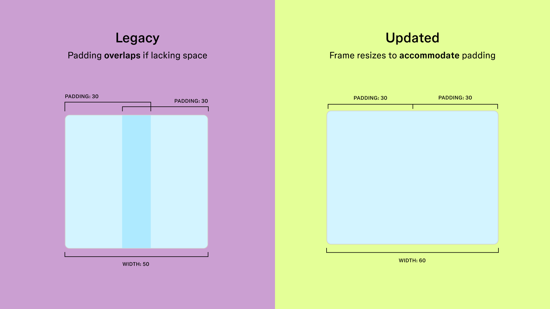

Padding now always gets the room it needs
Previously, you could set a frame's horizontal padding to 30px on each side (60px total) but still set the frame's width to 50px and Figma would render the frame at 50px wide, squeezing 60px worth of padding to fit.
In the new version, that same frame can't be narrower than 60px. Its padding is always fully respected and ignore any max width set for the frame. If the frame has an inside stroke and strokes are included in layout, the stroke width counts toward that minimum too.
Note: This matches how a border-box element works in CSS. An element with width: 50px and padding: 30px is automatically clamped to 60px. If the element also has border: 10px then the width of the element would be 80px. If your frame gets bigger than expected after upgrading, reduce the padding to bring it back to your intended size.

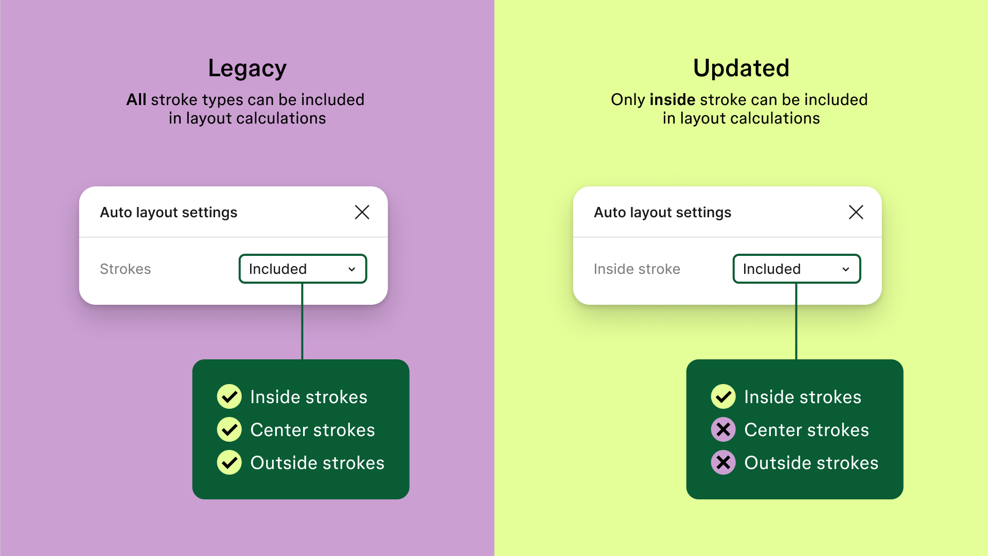

Strokes and layout
Only inside strokes count
Previously, strokes were ignored by default when calculating the size of an object, and thus leaving its parent frame or surrounding siblings unaffected. This didn't always match how CSS renders borders, so Figma offered a stroke setting in auto layout settings to choose to have strokes included in layout or excluded from layout calculations.
In the new version, inside strokes are included in layout by default, This means your designs will be more compatible with CSS out of the box, without needing workarounds like a separate border node or a negative-offset outline.
However, outside and center strokes are no longer counted in layout, even when a frame's stroke setting is set to included in layout. They'll still paint visually on the canvas, they just won't affect spacing, fill calculations, or any other layout math, and are not longer affected by the include/exclude setting for strokes.
Note: This is similar to the distinction between border and outline in CSS. An inside stroke behaves like a border and is included in layout. A center or outside stroke behaves like an outline and is excluded from layout, even when configured on individual edges.

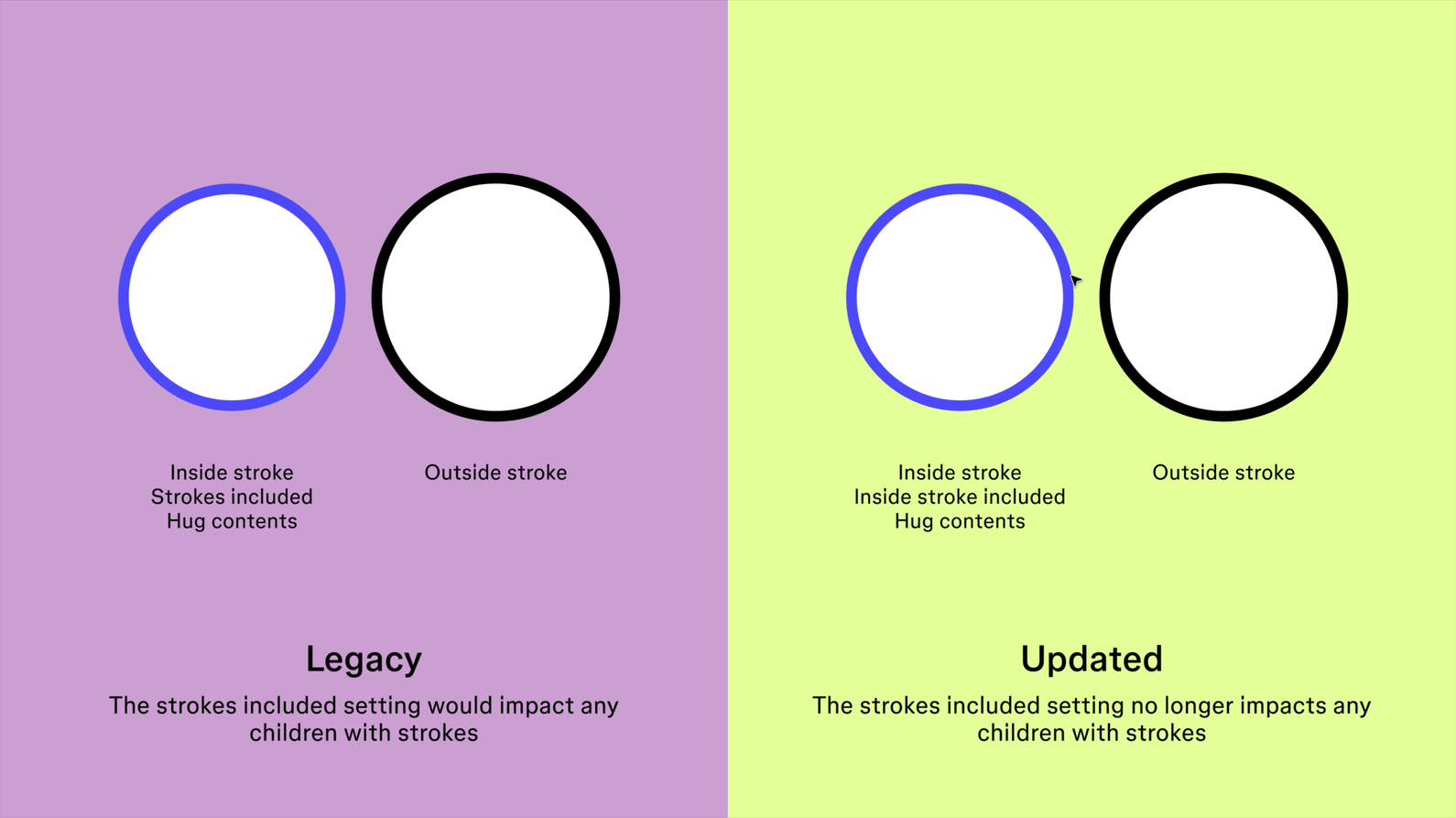

The stroke setting no longer affects child layers
Previously, the strokes included setting on an auto layout parent frame would also impact any children with strokes so they would always be visible, even if the setting was only applied to the parent.
In the new version, this setting only affects the frame it's set on. A parent's stroke setting no longer has any effect on how a child's stroke is calculated. Each frame's strokes now follow its own rules, independent of its parent or children.
Tip: If a nested auto layout frame looks different after upgrading, check the stroke setting on that frame directly as it's no longer inherited or influenced by its parent.

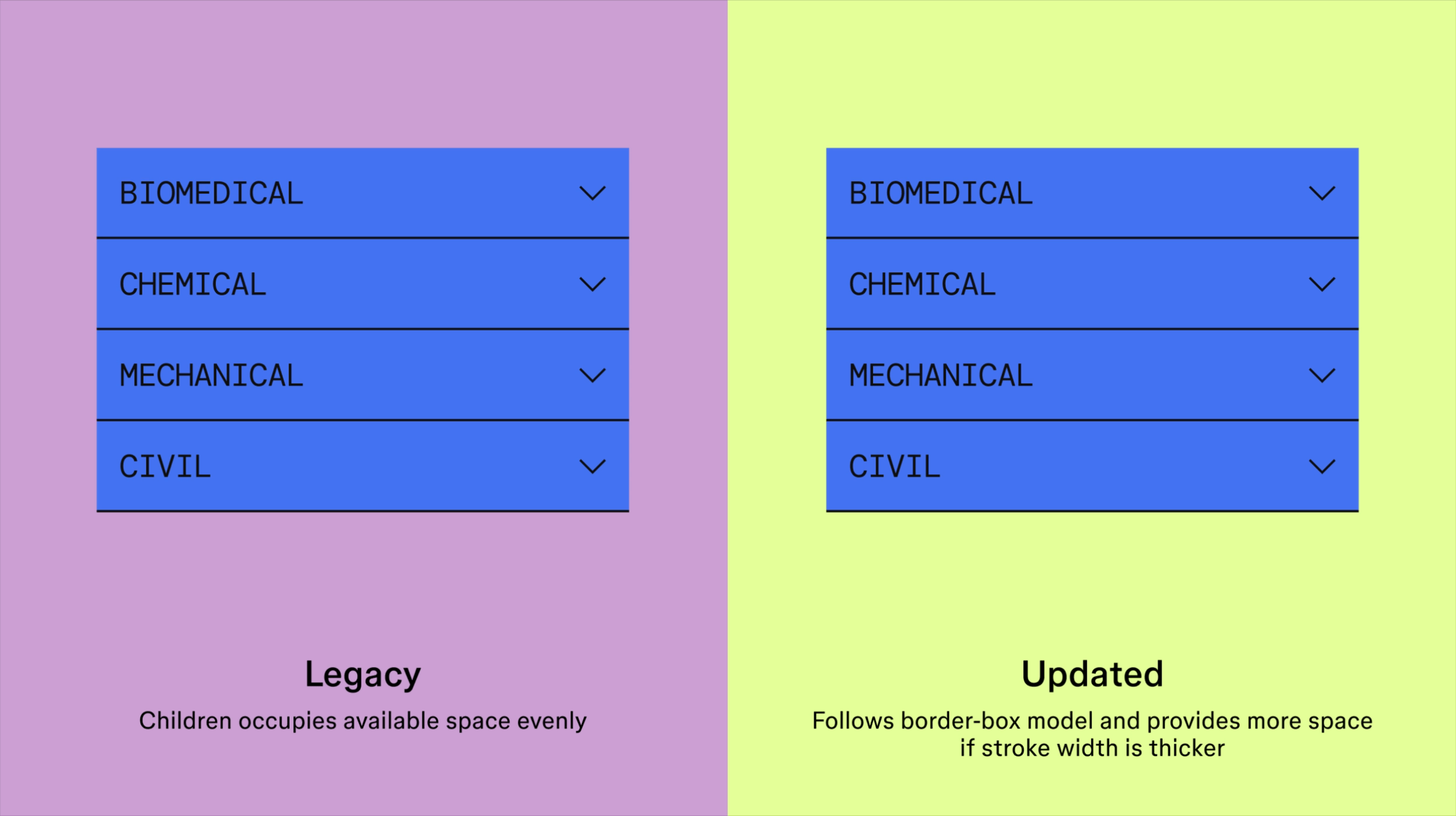

Children set to fill container now use the border-box model
When two or more children in an auto layout frame are set to fill container and have different padding and inside stroke widths, the new version changes how much content area each child gets.
Previously, children set to fill container would evenly occupy the available space—the length of space minus padding, gap, and strokes. This means a layer with a heavier stroke would end up with visibly less content area than a layer with a thinner stroke, even though both layers were technically the same size.
In the new version, Figma distributes space amongst fill container children by the children’s content area instead of by their size, matching the CSS border-box model. A layer with a thicker stroke will take up slightly more of the available width or height, so that its inner content area matches its sibling's. The new behavior for children set to fill container carries into prototyping and reflects how your designs will appear in development.
Note: If you want children to always split space exactly regardless of stroke width, switch the frame to a grid auto layout flow instead, and specify the size of each track using fractional units (fr). Learn how to use the grid layout flow.

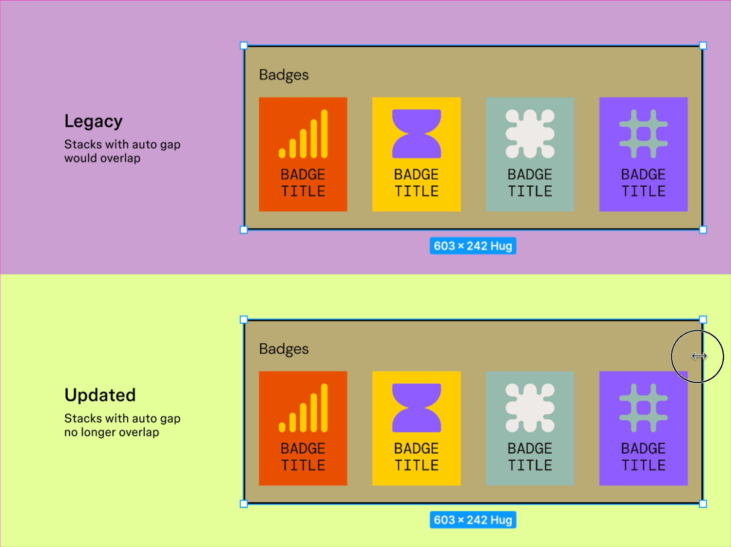

Gap set to auto
An auto layout frame with gap set to Auto, padding and spacing between objects will be distributed automatically depending on which auto spacing option is selected. By default, auto spacing is set to Between.
Stacks with gap set to auto no longer overlap
When an auto layout frame has enough space for its children to fit, auto gap works as expected. However, previously, when the children didn’t fit, auto gap would go negative and cause the children layers to overlap.
In the new version, gap in an auto-gap stack will never go below 0. This is true for all auto spacing options. When children don't fit, they'll collapse to the start of the frame instead of overlapping, matching how space-between behaves in CSS flexbox.
Note: If you want children to intentionally overlap, you can still set a specific negative gap value. This has always been supported and now more clearly expresses that the overlap is intentional, rather than relying on Auto gap to produce it as a side effect.

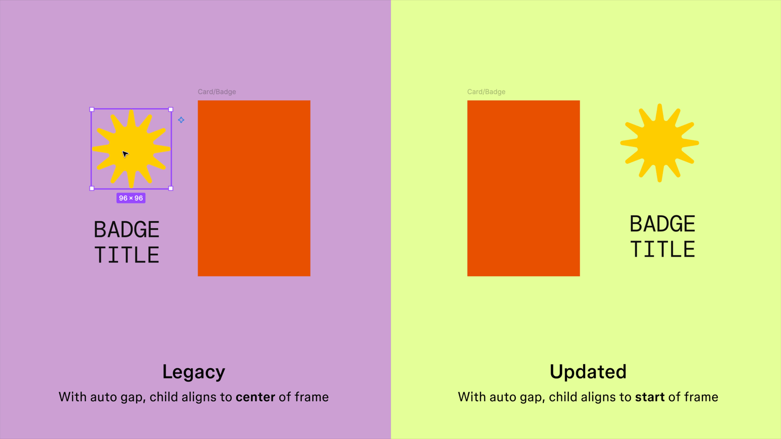

A single child in a Between auto-gap stack aligns to the start
Previously, a single item in an auto layout frame with auto spacing set to Between would be centered by default.
In the new version, a single child aligns to the left in a horizontal flow or the top in a vertical flow.
If auto spacing is set to Around or Evenly, then the single child will remain centered in the frame.

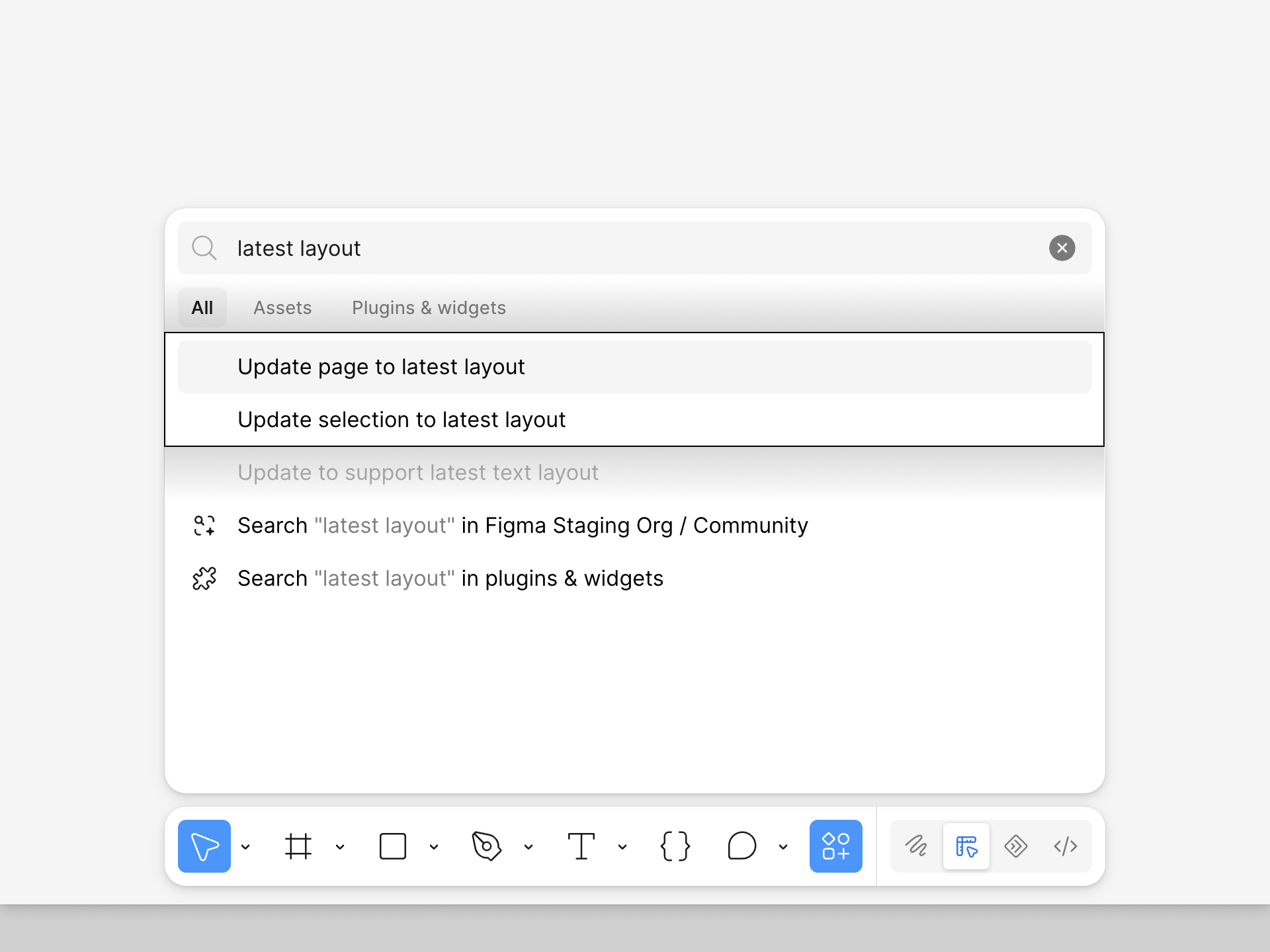

Update a selection or page:
- Select a frame and choose the layout version from the dropdown in auto layout settings
Or, use the Actions menu and search for:
- Update layout version for selection
- Update layout version for page
