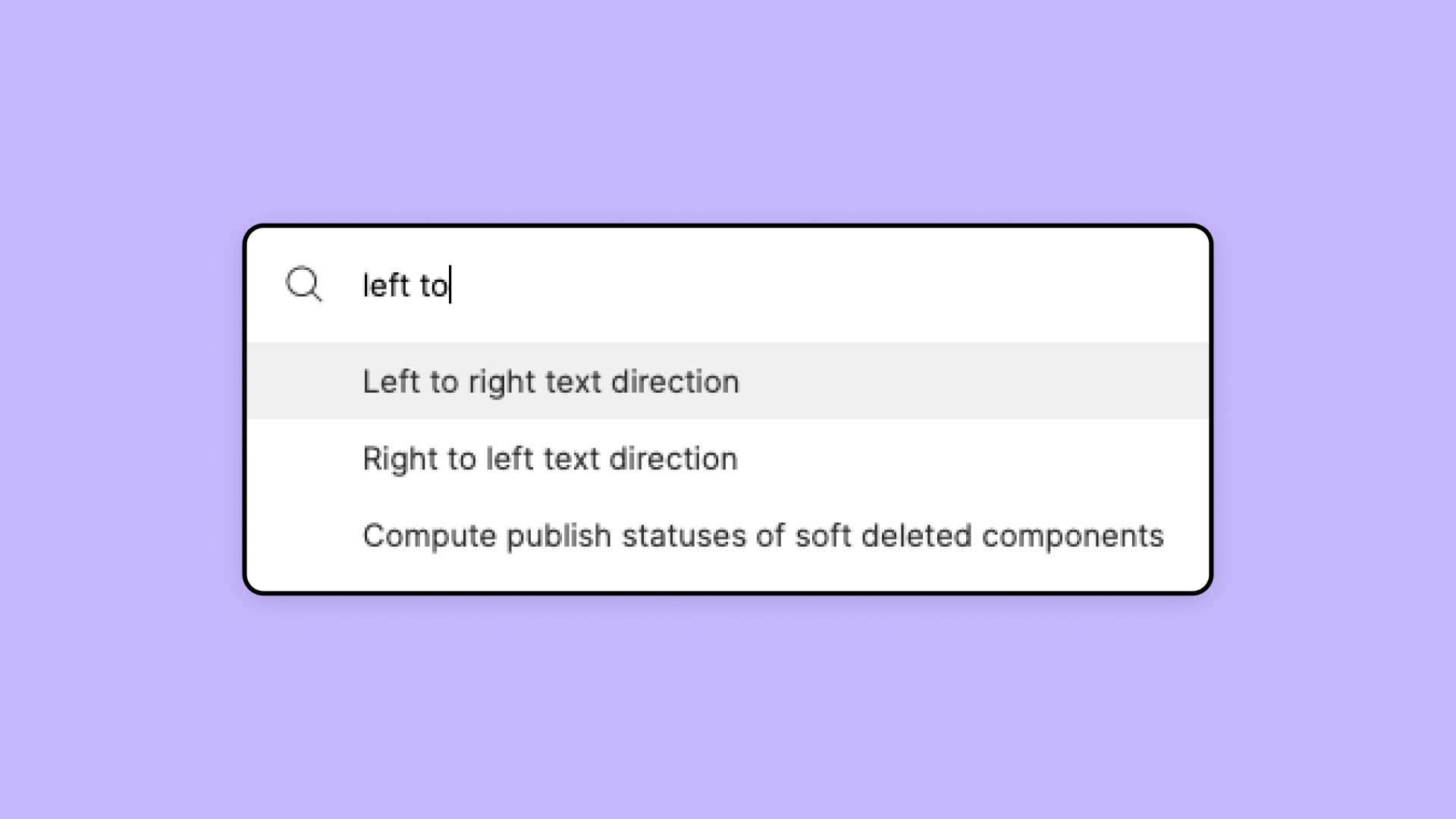

Quick actions:
- Select text layer(s) containing RTL script.
 - Open the quick actions menu.
- Mac:
⌘ Command/ - Windows:
Control/
 - Mac:
 - Use right to left text direction or left to right text direction.

Quick actions:
- Mac:
Control/
 - Mac:
