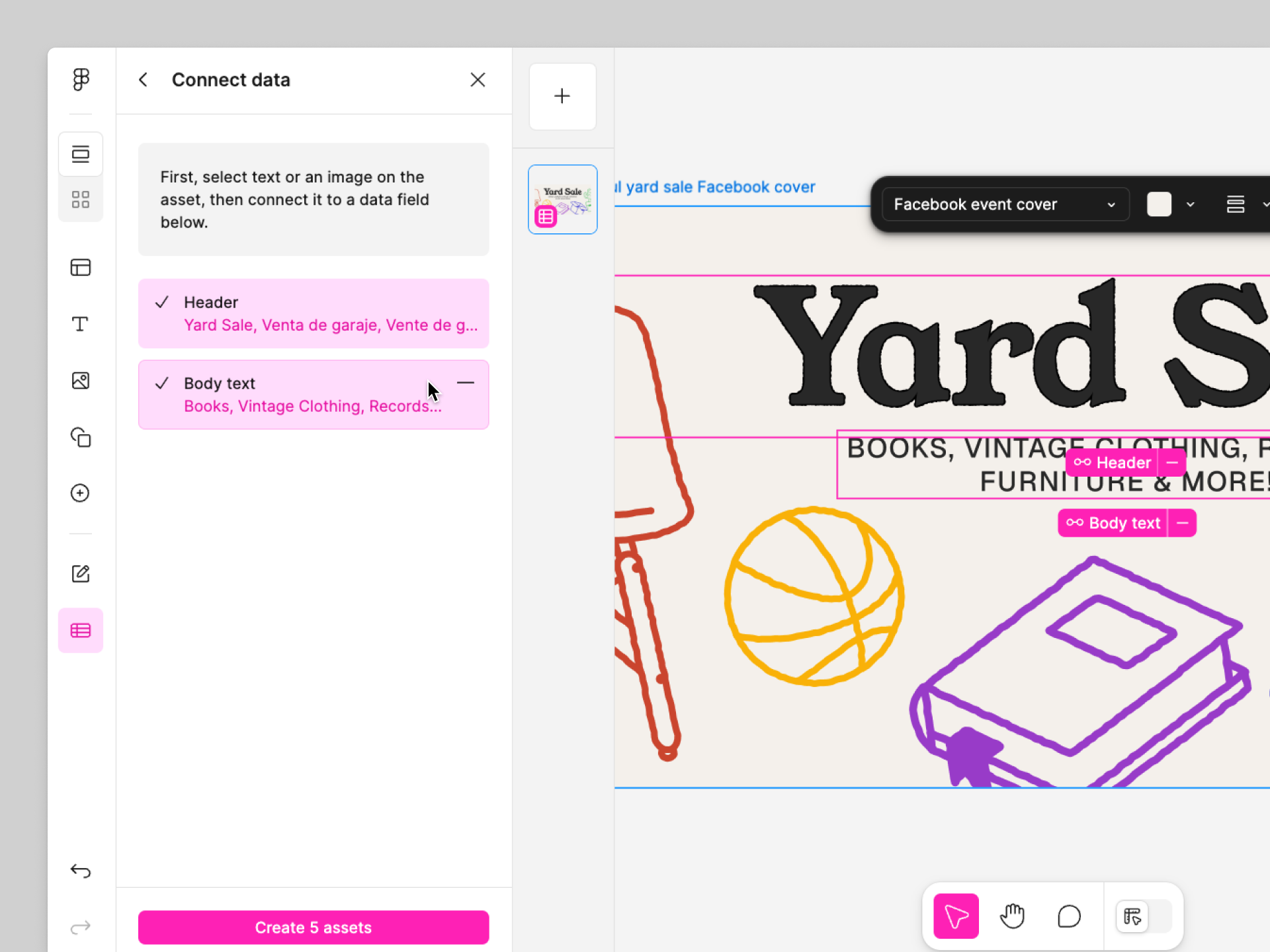

- Select your base asset on the canvas.
- Click Bulk create from the left navigation bar.
- Click Upload, then select your CSV or XLSX file containing the translated content. Once uploaded, you'll see a list of your data fields (column headers) in the left sidebar.
- Map your content fields: For each element in your asset that you want to localize:
- Click on the element in your asset.
- [Optional] If you have multiple assets in different sizes, click More from the selected object’s toolbar and Select matching objects to connect multiple of the same object type across assets.
- Select the corresponding data field from the left sidebar. The data field will be marked with a check and highlighted pink once connected
- Repeat step 4 for each element you want to translate.

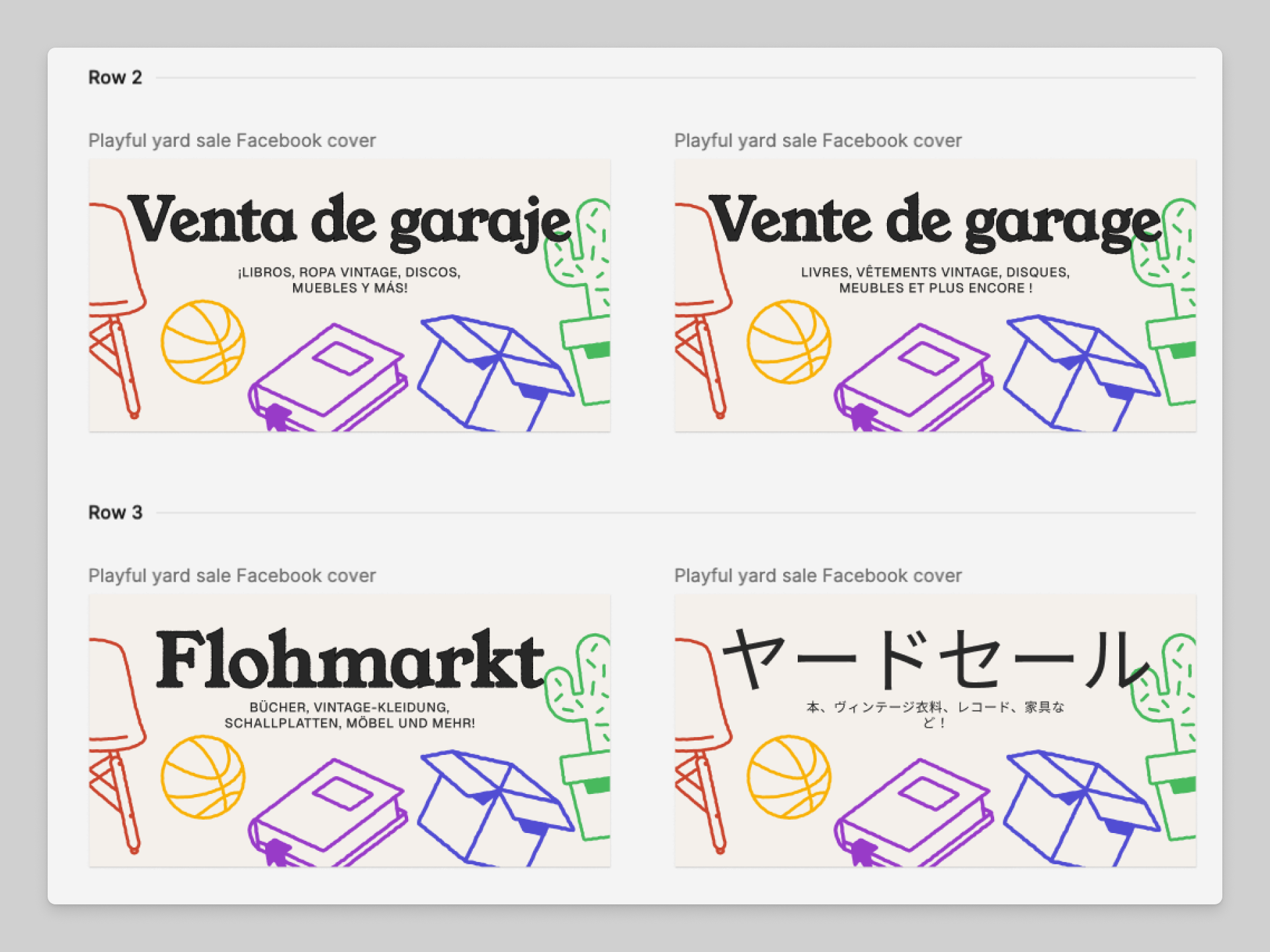

Create your localized assets
Once you've mapped all your content fields, you can create your localized assets.
- Click Create assets.
- Figma Buzz will create a new asset for each row in your data file. Navigate to Grid view to see all your localized versions at once.
Some languages may require formatting adjustments:
- Font sizes: Reduce size for longer translations or increase for shorter ones
- Line spacing: Adjust for languages with different character heights
- Text alignment: Some languages read right-to-left and may need alignment changes
If you’re working from a template with brand guidelines, you may need to remove editing guidelines prior to directly editing the asset.
