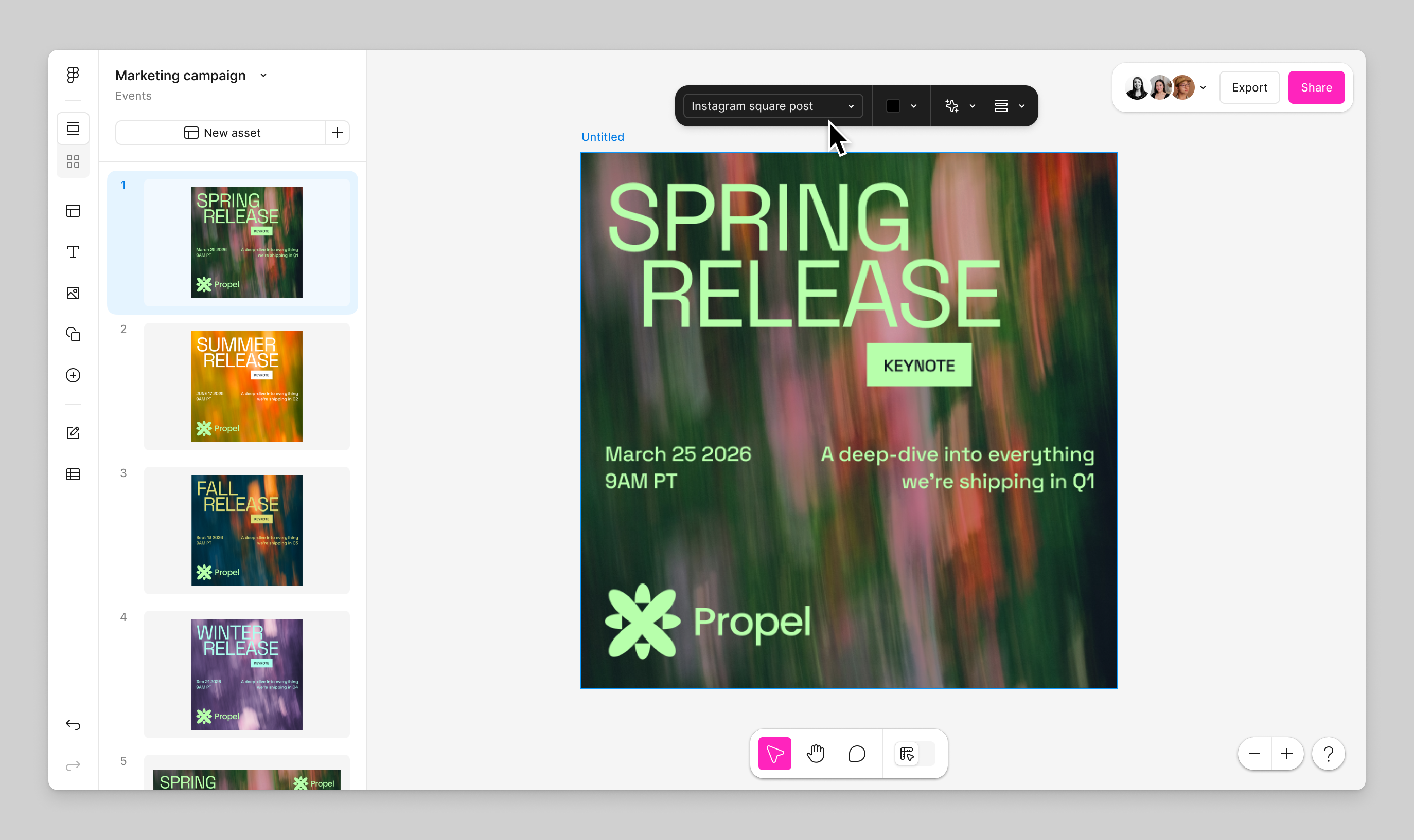

To resize an asset in Figma Buzz:
- Select the asset on your canvas.
- In the toolbar, open the Size dropdown menu.
- Choose a preset size (like "Instagram Post" or "YouTube thumbnail") or enter your own custom dimensions.
Note: If you’re using a branded template, you won’t be able to resize it unless you remove editing restrictions.

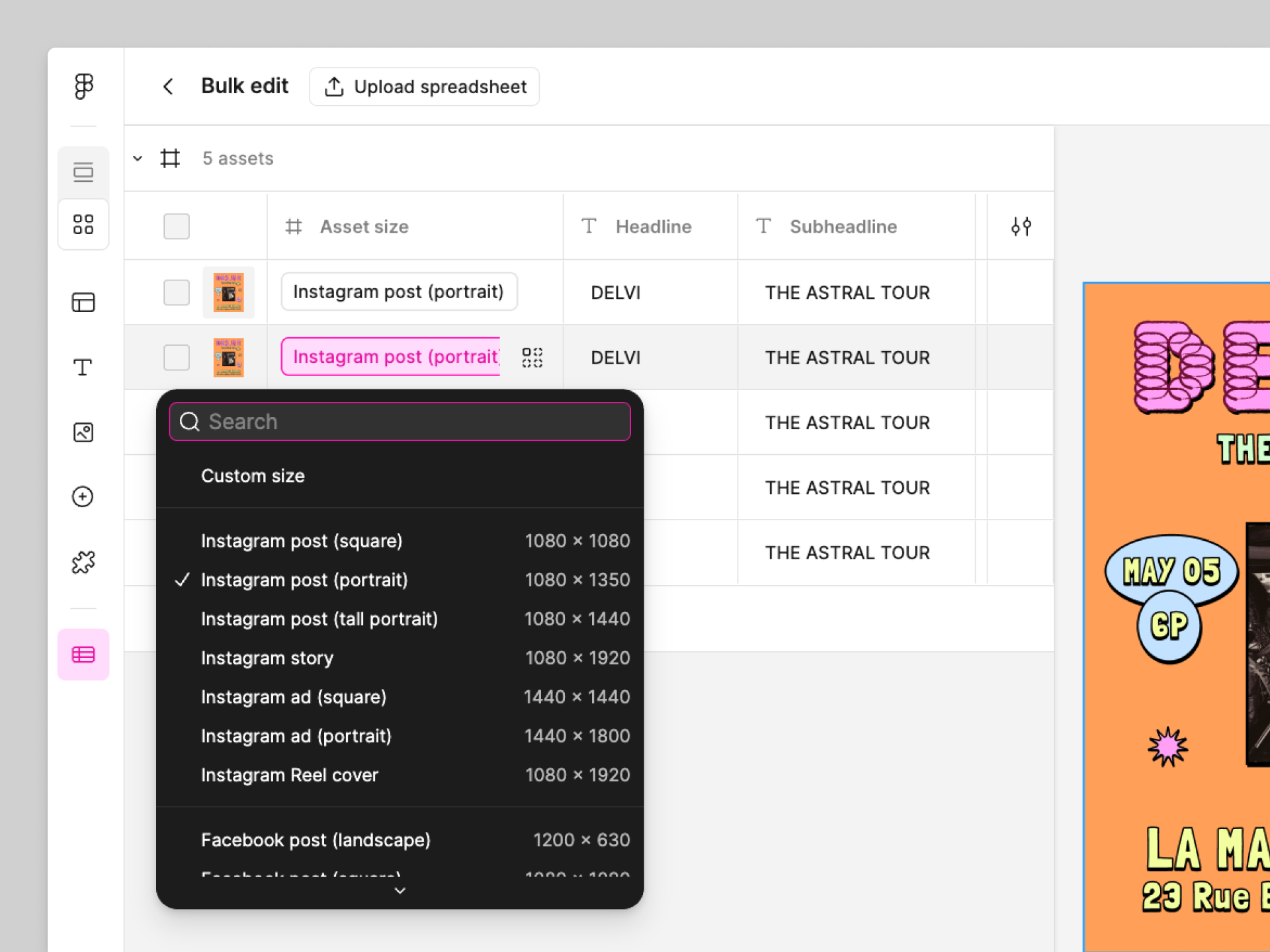

To resize multiple assets quickly:
- Click Bulk create from the left navigation bar.
- In Asset size column, select the size dropdown for each asset to resize.

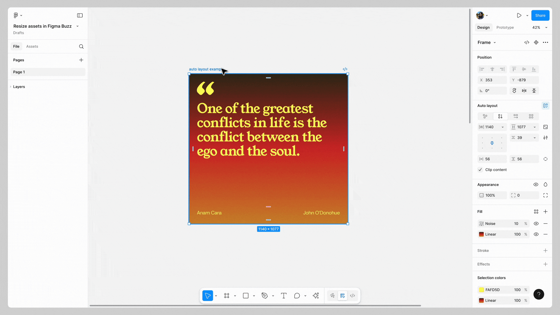

Use auto layout
Auto layout is an essential tool for creating responsive, adaptable designs in Figma.
Elements in an auto layout frame are automatically arranged based on direction, spacing, padding, alignment, and other auto layout properties. When the content changes or the frame is resized, the layout adjusts without manual repositioning.
You can apply auto layout to parent frames and child objects within a frame.
To apply auto layout in Figma Design:
- Select one or more layers.
- Press Shift A, or click Use auto layout from the Layers section of the right sidebar.
Then, adjust the auto layout properties from the Auto layout section of the right sidebar.
How you use auto layout will depend on the specifics of your design, but here are a few key concepts to help you get started:
- Use padding and gap values to maintain spacing between and around objects.
- If you want a child object to stretch to fill all available space in their parent frame while still respecting any spacing values, apply Fill container resizing to the child objects.
- If you want to ensure that objects don’t collapse too small or expand too large when resized, set minimum and maximum width and height values for those objects. You can use minimum and maximum values in combination with Fill container.

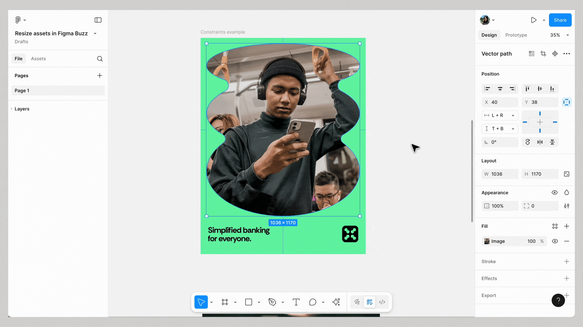

Apply constraints
Constraints define how layers behave when their parent frame is resized. This allows you to build assets that adapt to different sizes without misaligning or overlapping content.
Note: It's not possible to apply constraints to layers in an auto layout frame. Play around with auto layout and constraints separately, to see which strategy works best for your design.
You can apply constraints in Figma Design, or in design mode in Figma Buzz.
- Select a layer.
- Click Constraints from the Position section of the right sidebar.
How you use constraints will depend on the specifics of your design, but here are a few key concepts to help you get started.
You can apply constraints in both the horizontal (x) and vertical (y) directions:
- Left or Top: Keeps the layer pinned to the top or left side of the frame.
- Right or Bottom: Pins the layer to the opposite edge.
- Left and Right (or Top and Bottom): Stretches the layer between both sides, so it expands/contracts when resized.
- Center: Keeps the layer centered as the frame resizes.
- Scale: Maintains the layer’s position and size as a percentage of the frame dimensions.

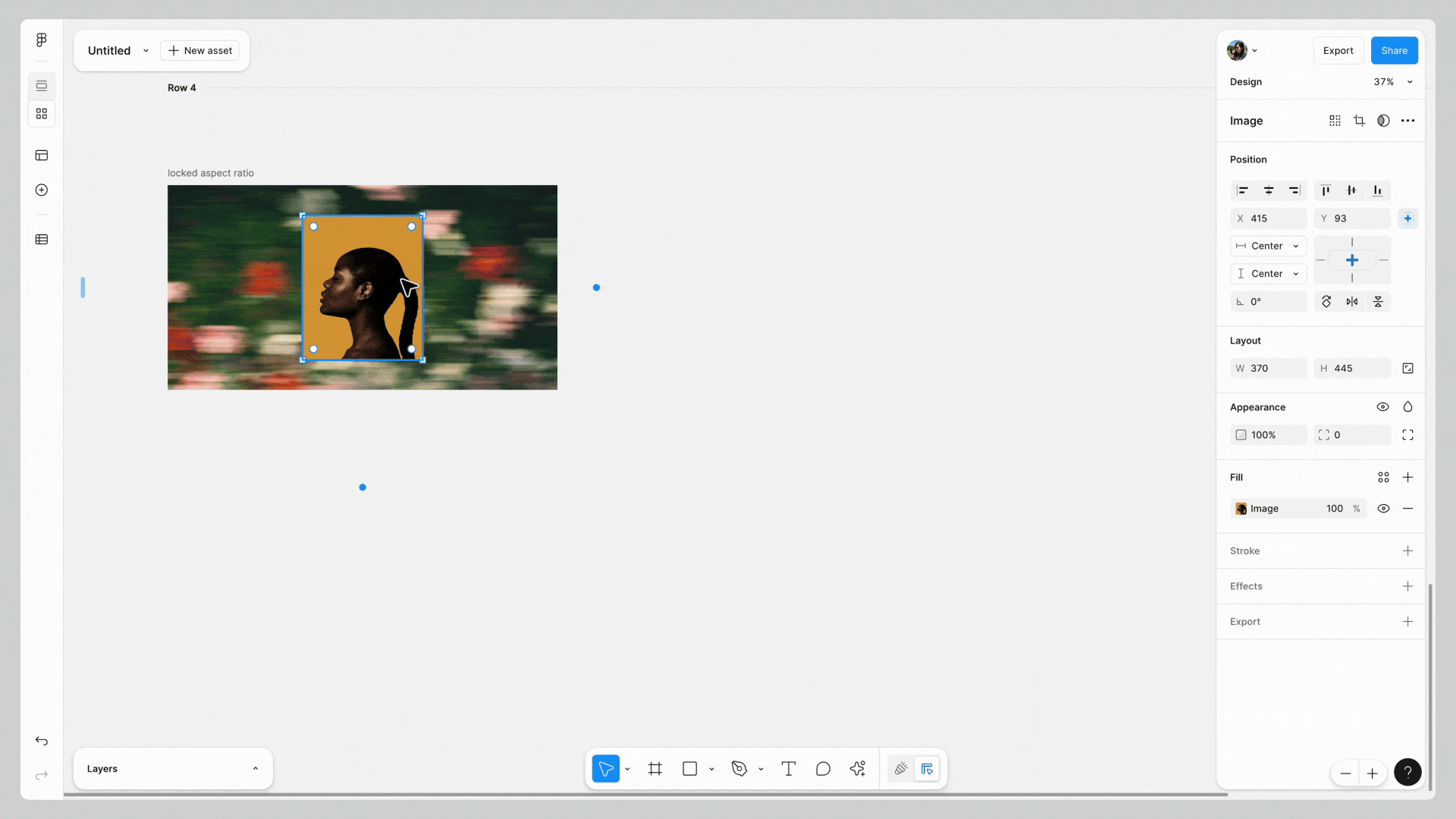

Lock aspect ratio
Locking a layer’s aspect ratio ensures it retains the same width-to-height proportions when resized. This is especially helpful for logos, product images, vector objects, or illustrations that must maintain visual consistency at any size.
You can apply lock aspect ratio in Figma Design, or in design mode in Figma Buzz.
- Select the layer.
- In the right sidebar under the Layout or Auto layout section, click Lock aspect ratio.
Tip: If you’re new to lock aspect ratio, check out these resources:
- Watch and read: Aspect ratio lock on Figma's YouTube channel
- Read: Lock aspect ratio.
