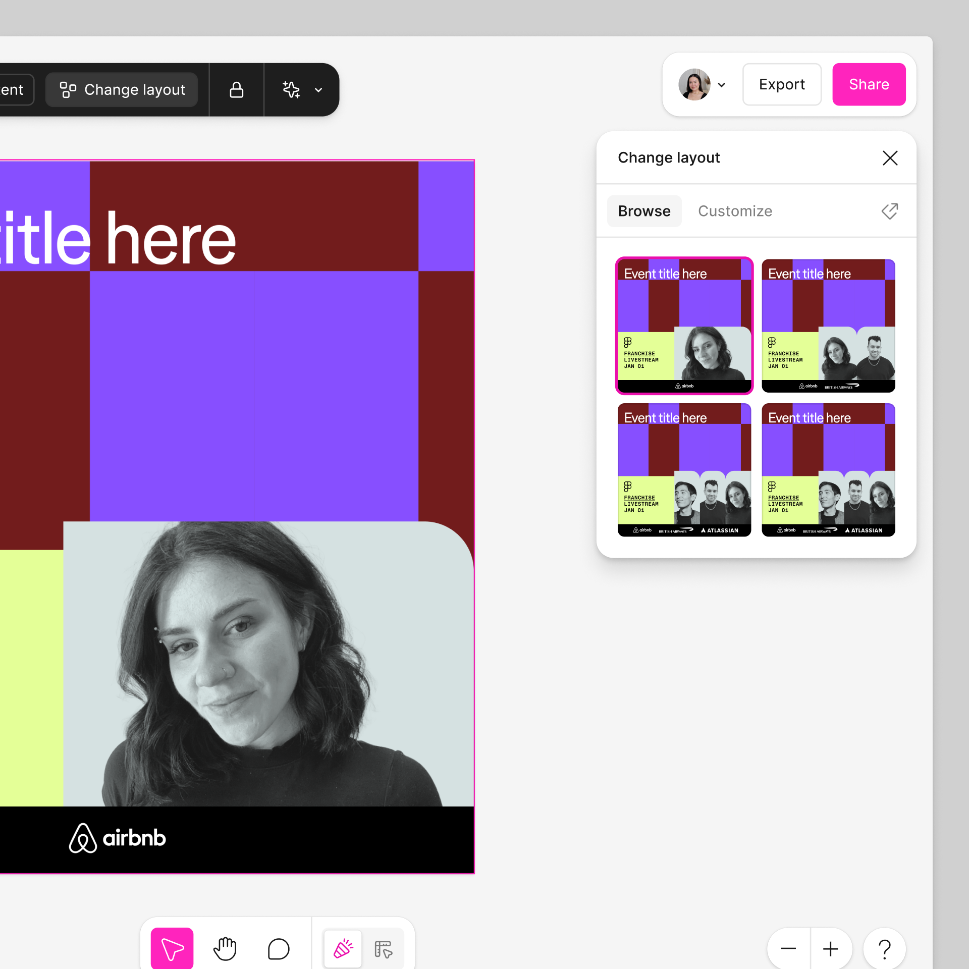

Template users see each variant as layout options for their template.
- Select the asset.
- Click Change layout from the toolbar.
- In the Change layout modal, use the Browse tab to preview and select layout variations, or switch to the Customize tab to select a variant from a dropdown.

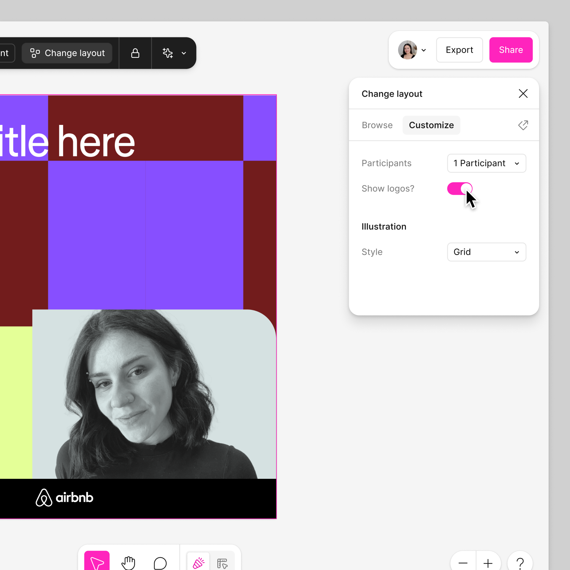

Template users see boolean properties as toggle controls when customizing a layout.
For a template user to see boolean properties:
- Select the asset.
- In the Change layout modal, select the Customize tab.
- Use the toggle switches to turn boolean properties on or off.

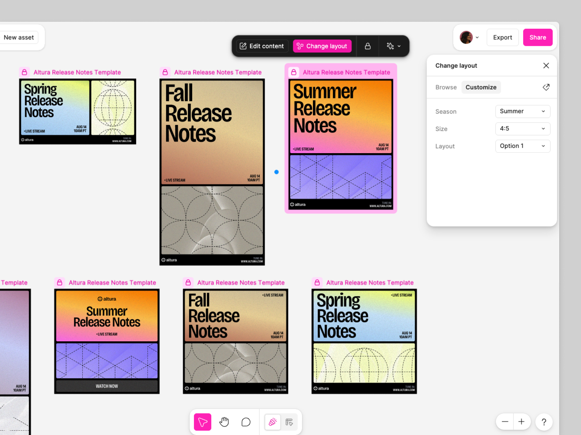

Template users see instance swap properties as dropdowns when customizing a layout.
- Select the asset.
- Select instance swaps from a dropdown menu.

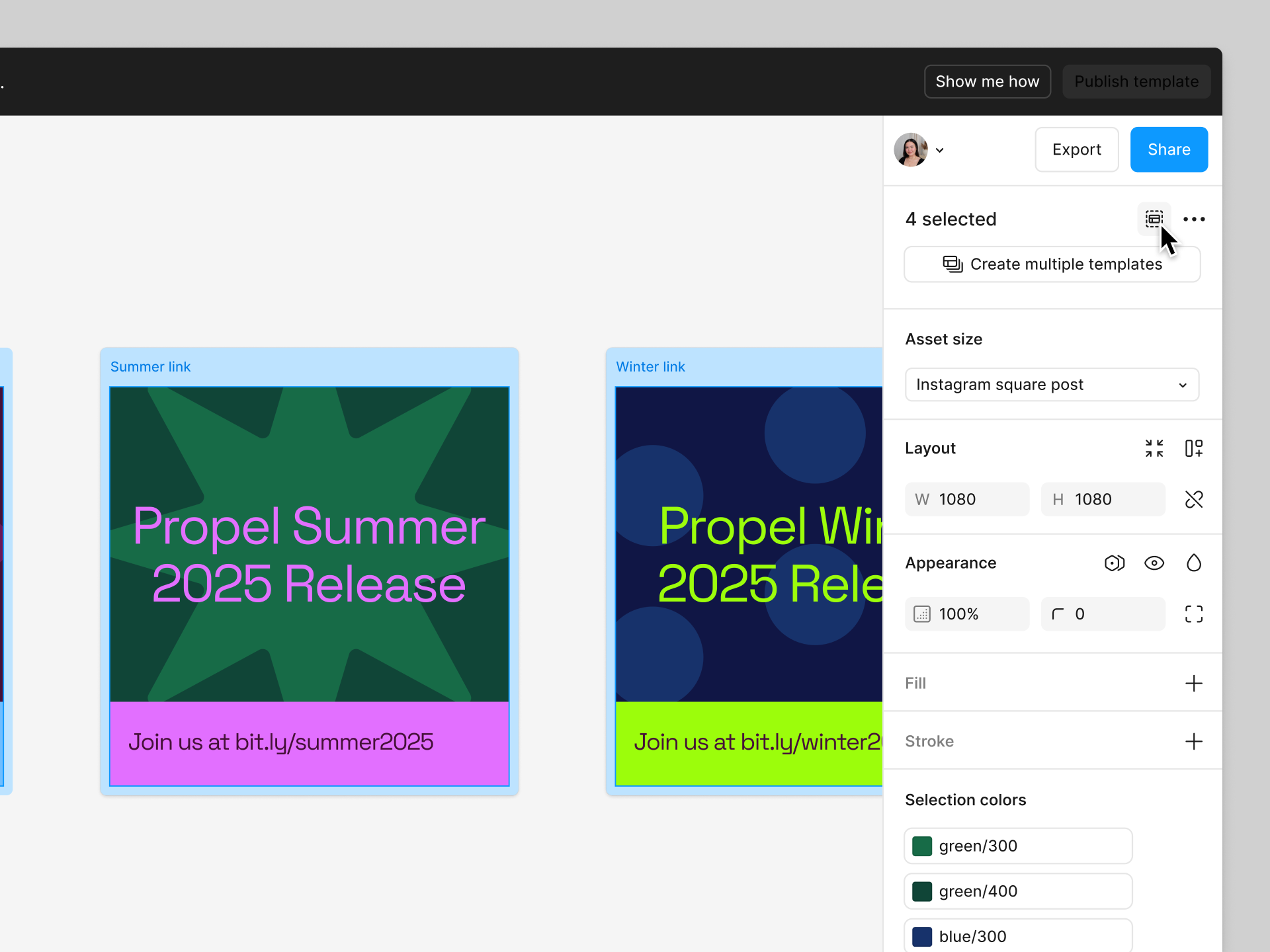

To create a template set:
- Switch to Design mode by selecting the Design toggle from the bottom toolbar.
- Select multiple assets.
- From the right sidebar, click Create template set.

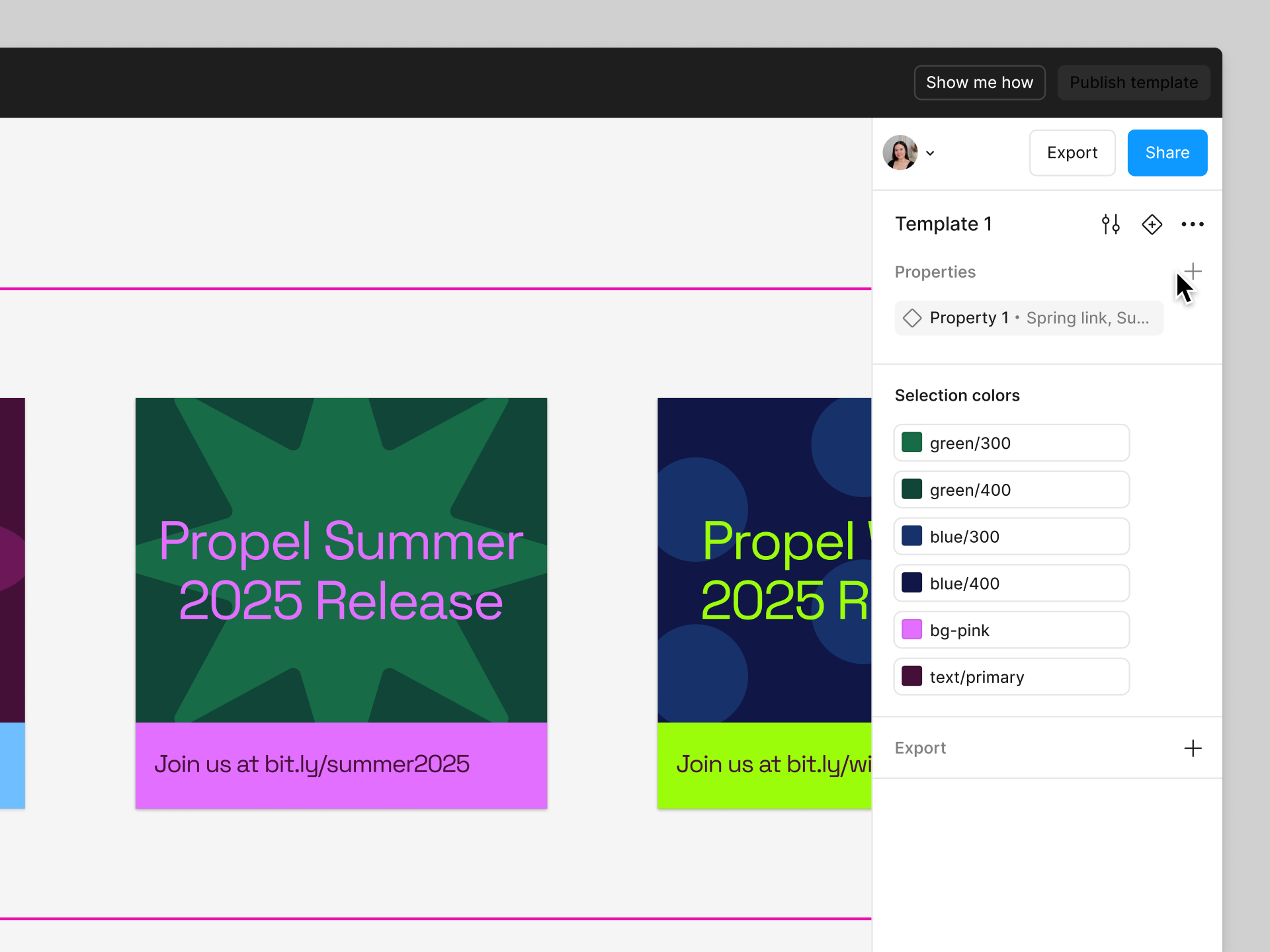

Once you’ve created the template set:
- Use the right sidebar to create or edit properties and variants
- Define property names and default values for each property you add
