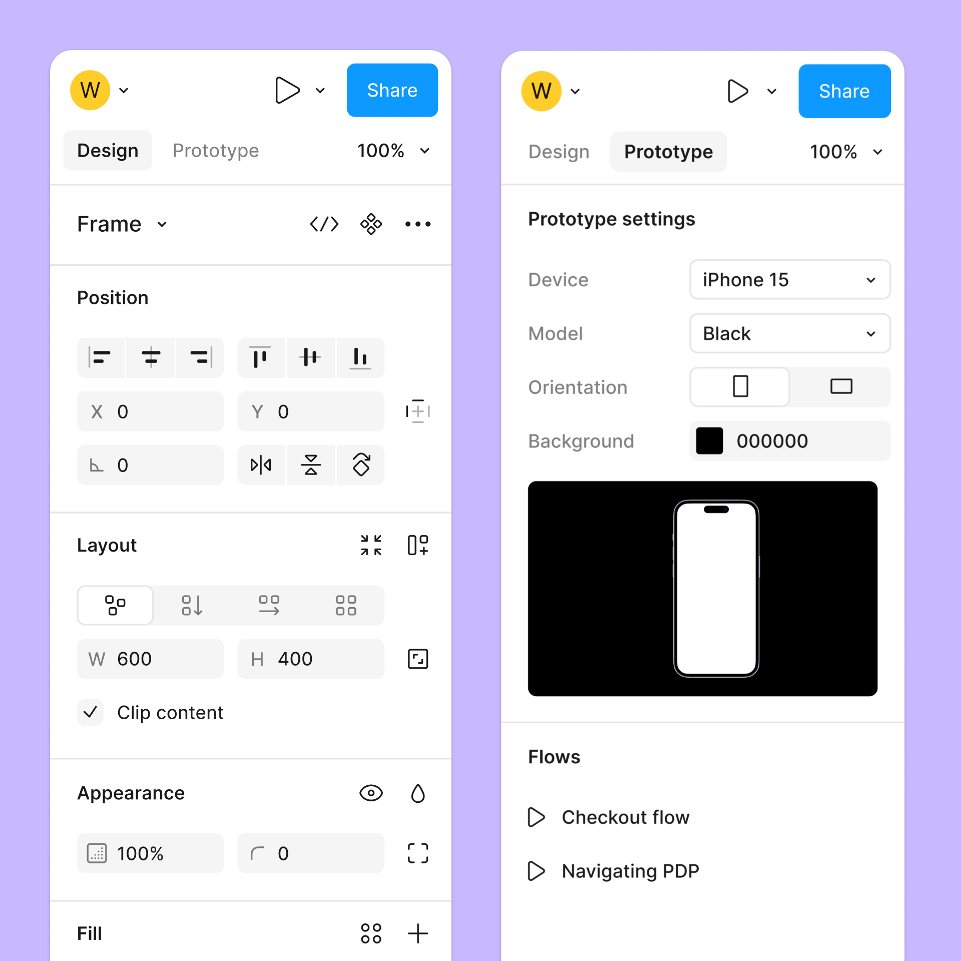

There are two tabs available in the properties panel when you have edit access to a file: Design and Prototype.
Tip: You can add labels to the properties panel to make it clearer what each property does. To turn on labels, click the dropdown menu next to the 100% zoom percentage in the properties panel and select Property labels.
Design
The Design tab lets you view, add, remove or change the properties of objects within your design.

Prototype
Use the Prototype tab to start building prototypes. Select any object to begin, then:
- Add a flow starting point: A flow is a path users take through the network of connected frames that make up your prototype. Add a starting point to choose the first frame of the journey.
- Add an interaction: Open up the Interaction Details modal, where you can define the trigger, action, and any animations for the interaction.
- Define scroll behavior: Select how the prototype responds to scrolling.
- Show prototype settings: Allows you to adjust the device and background of your prototype.
Tip: You can also add interactions directly on the canvas by selecting the Prototype tab, then clicking and dragging connections between objects.

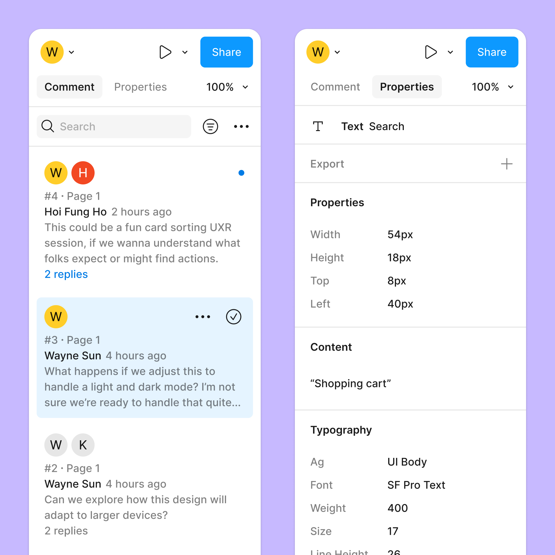

People with can view access to a file, or who have a View seat on a paid plan, have two tabs in the properties panel: Comment and Properties.
View-only access is great for people who don't need to edit designs or for developers who need to access designs, but don't need the full suite of Dev Mode features. People with this access to a file can collaborate on designs, view design properties, copy basic code, and export assets.
Comment
Select Comment in the right sidebar to add new comments or view existing ones. You can use comments to add or respond to feedback, collaborate, and iterate faster—all from the original design file.
From the Comment tab, you can see all the existing comments in a file. Or, find a particular comment or set of comments within a file:
- Type a keyword in the Search field to find a particular comment.
- Use the Filter to view comments by when they were posted or see only the ones you haven’t read yet. Here, you can filter to only view a certain set of comments.
Learn more about adding comments to a Figma Design file or viewing and manage comments.
Properties
The Properties tab of the right sidebar lets you inspect particular layers on the canvas, as well as export designs.
To begin, select a layer on the canvas. You can do this by either selecting the element on the canvas itself or by selecting it from the Layers panel on the left sidebar. You can select any type of layer, such as a shape, text, group, or frame.
Under Properties, you’ll see the name of the selected layer and details about it, such as its layout and colors.
