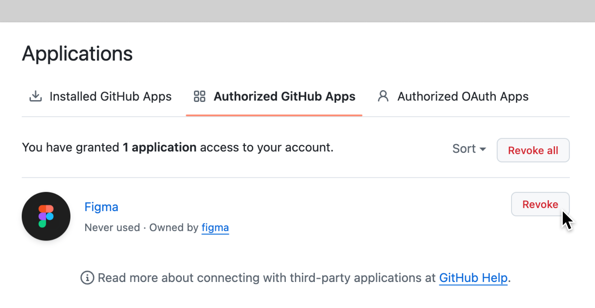

As a team or organization admin, you can disconnect the Figma GitHub app, which removes the ability to push from Figma Make to GitHub and connect Code Connect UI to your code components. If desired, you can connect the Figma GitHub app again later.
- From the file browser, click All projects.
- Click the next to the team name, and then select View settings.
- Under Figma GitHub app, click Manage.
- Click Remove from Figma.
- Open your team or organization in Figma.
- Select Admin from the sidebar.
- Select the Settings tab.
- In the Resources section, click Figma GitHub app.
