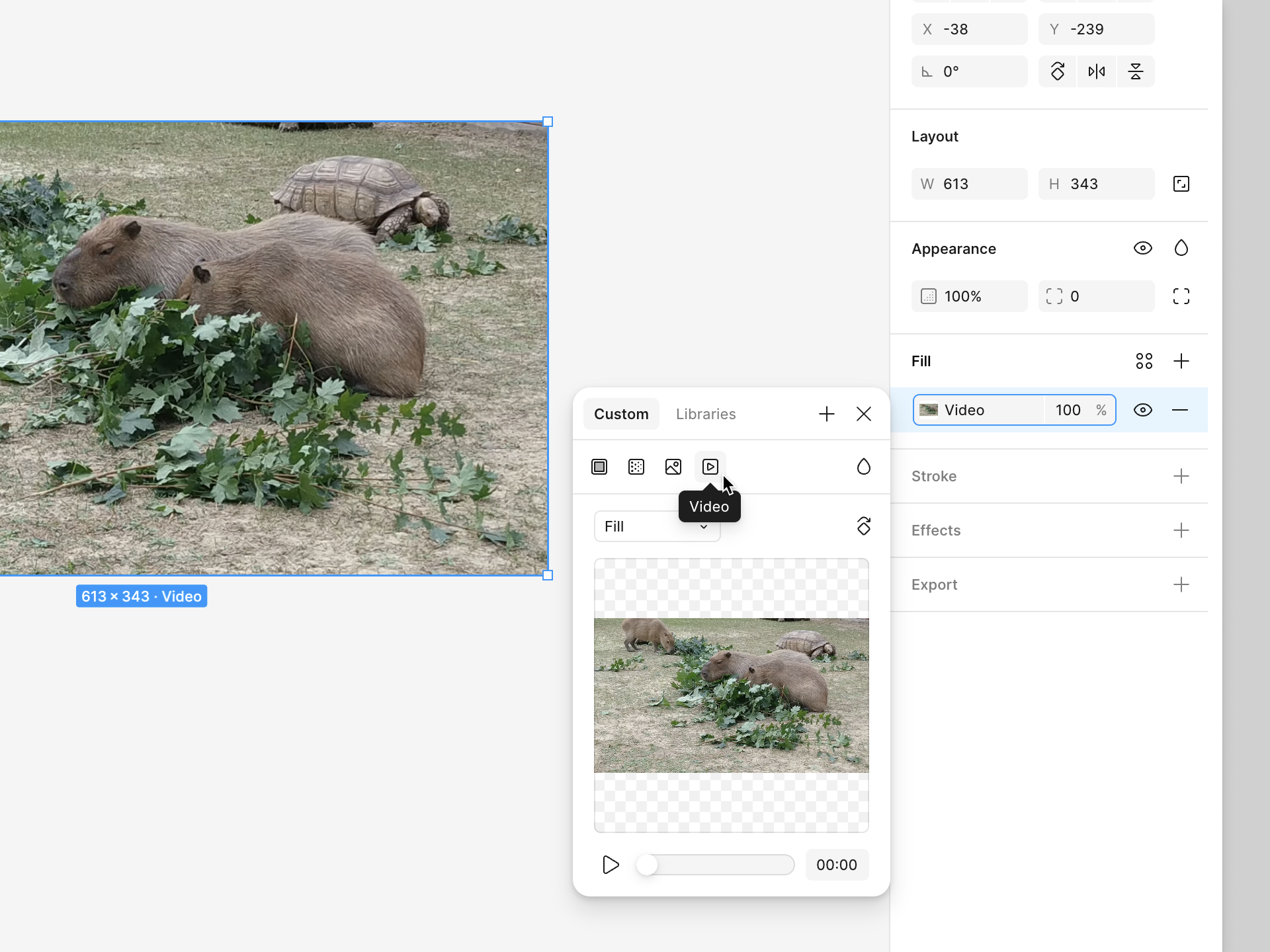

B Use the video importer from the fill color picker. Learn more about how to upload fills →

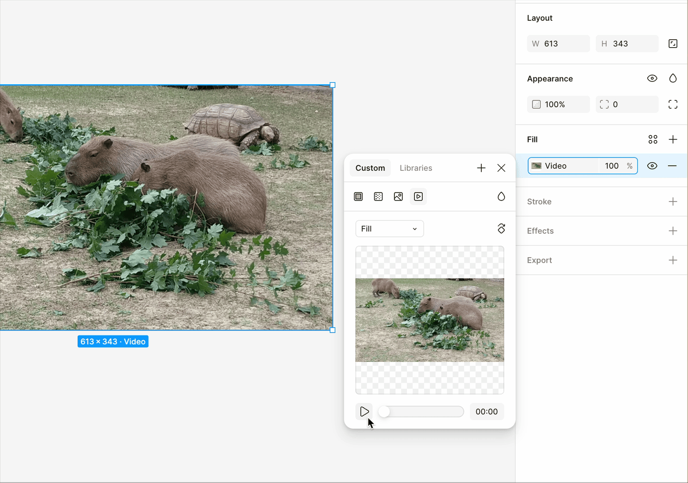

View and update video fills in the Fill section of the right sidebar. From the Fill section, you can play and preview your video fill, jump to a specific timestamp, or scrub through the video.

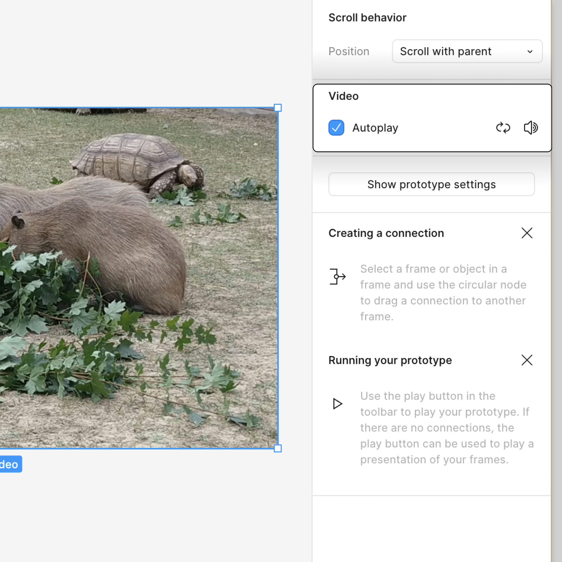

When you select a video, there is a Video section available on the Prototype tab. This section lets you set a video’s behavior when navigating to its frame in a prototype.
- Check the box to autoplay video
- Click the Loop icon to loop video
- Click the Sound icon to turn the video’s default sound setting on or off

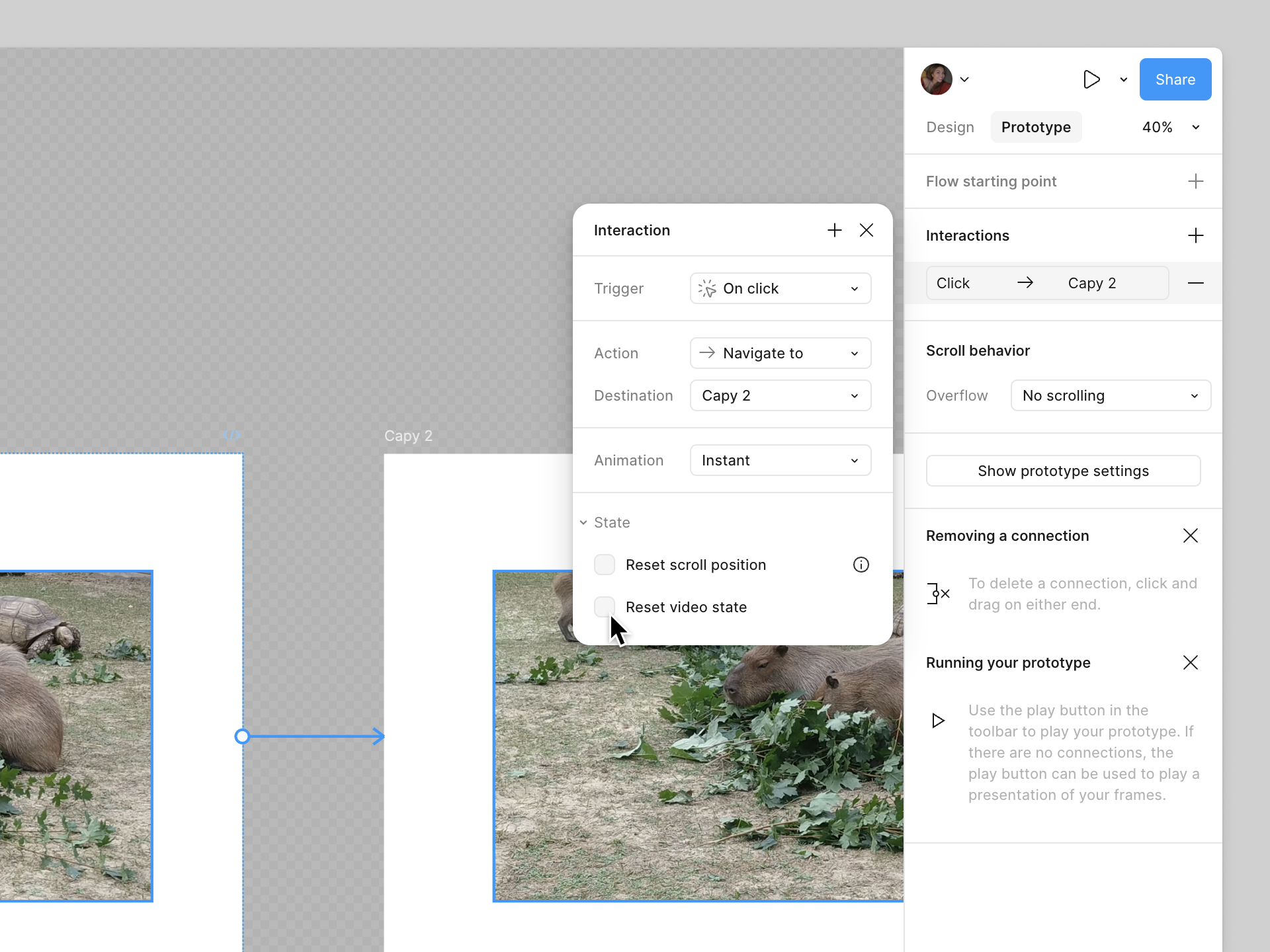

When you create an interaction between two frames that have the same video, there is a Reset video state toggle in the Interaction details panel. When toggled on, the video will restart from its beginning between frames. Learn more about video state management →

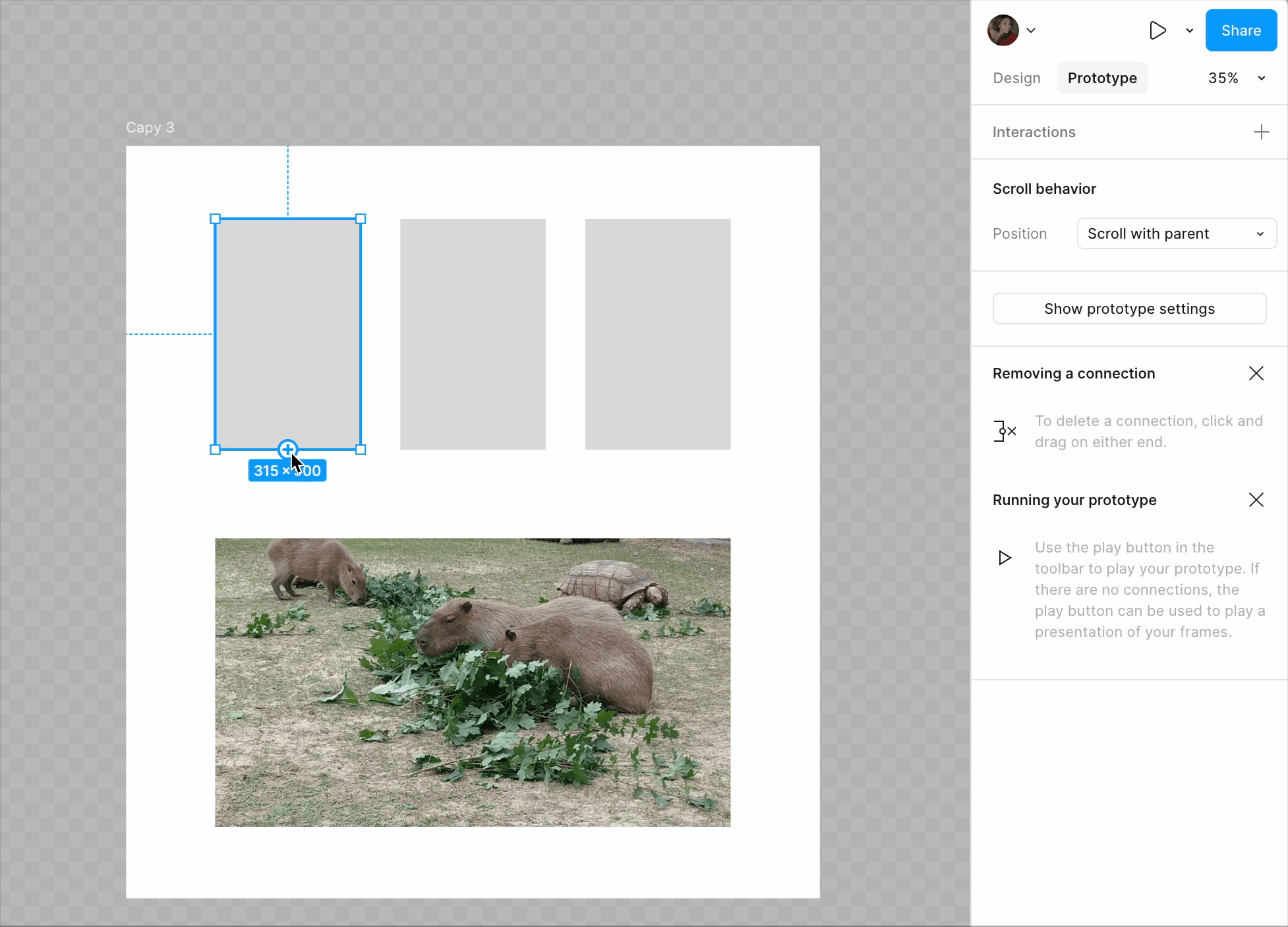

Video interactions within the same frame
You can interact and prototype with videos based on triggers made within the same frame. This can be helpful when trying to build an interactive video player experience.
- Create a connection from your starting object to the video file.
- Set your desired starting action (for example, On click).
- Set your desired action for the video (for example, Mute/unmute video).

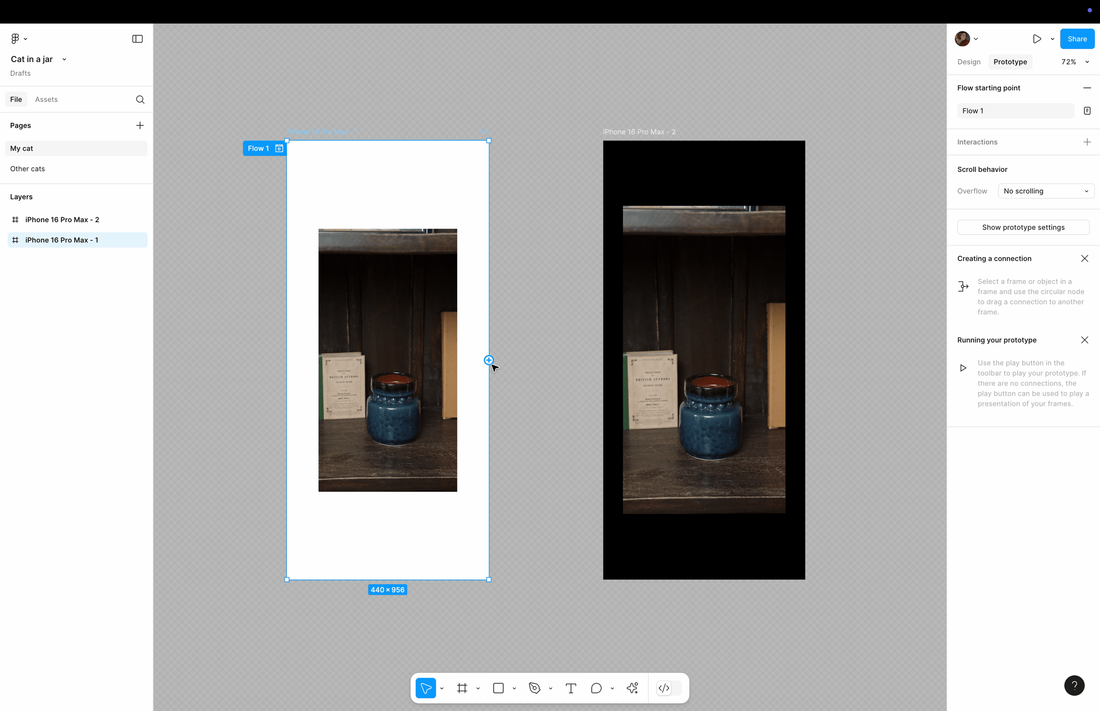

Video and smart animate
You can use smart animate to preserve a video’s progress when navigating between frames. Let’s say you want to create a prototype where entering a frame begins playback, then clicking on the video navigates to a new frame with a larger view.
- Create a connection between the two frames with the same video name. Make sure the video layer names match as well.
- Set the animation setting to Smart animate.
- In the Interaction details panel, uncheck Reset video states.

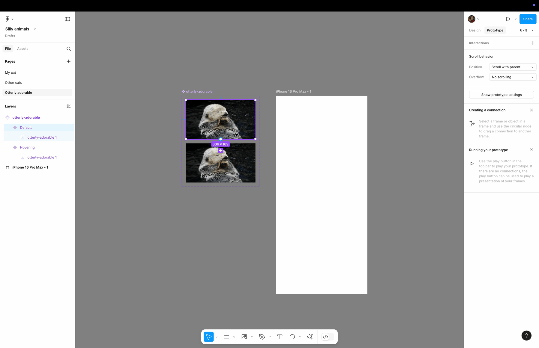

Video and interactive components
Use interactive components to prototype video interactions in a single frame, like previewing playback on hover.
- Create a component with variants for a default and hover state.
- The default state should have autoplay off, and the hover state should be set to autoplay.
- Create a connection from the default variant to change to the hover variant and uncheck Reset video states.
- Create a frame with a couple instances of the component and replace video to reuse the component.
