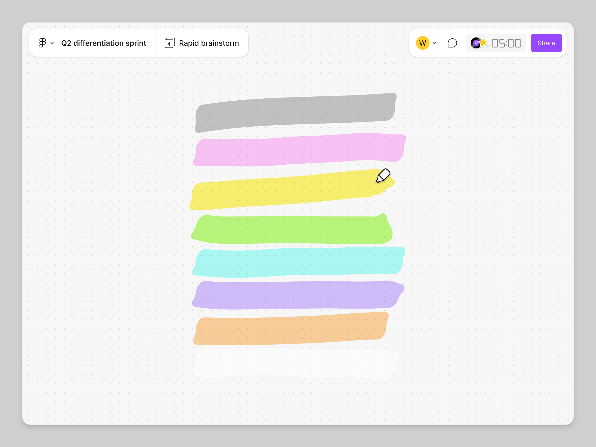

Highlighter
The highlighter tool’s palette includes:
- Gray #D9D9D9
- Pink #FFBDF2
- Orange #FCD19C
- Yellow #FFFAA3
- Green #AFF4C6
- Blue #B6ECF7
- Violet #E4CCFF
- White #FFFFFF

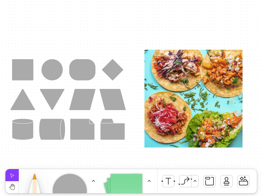

Shapes, sections, marker doodles, and connectors have their own color palette.
- White #FFFFFF
- Black #1E1E1E/ Dark gray#757575
- Gray #B3B3B3/ Light gray#D9D9D9
- Green #66D575/ Light green#CDF4D3
- Teal #5AD8CC/ Light teal#C6FAF6
- Blue #3DADFF/ Light blue#C2E5FF
- Violet #9747FF/ Light violet#E4CCFF
- Pink #F849C1/ Light pink#FFC2EC
- Red #FF7556/ Light red#FFCDC2
- Orange #FF9E42/ Light orange#FFE0C2
- Yellow #FFC943/ Light yellow#FFECBD
- Custom color using the eyedropper tool ↓ or a hex code.

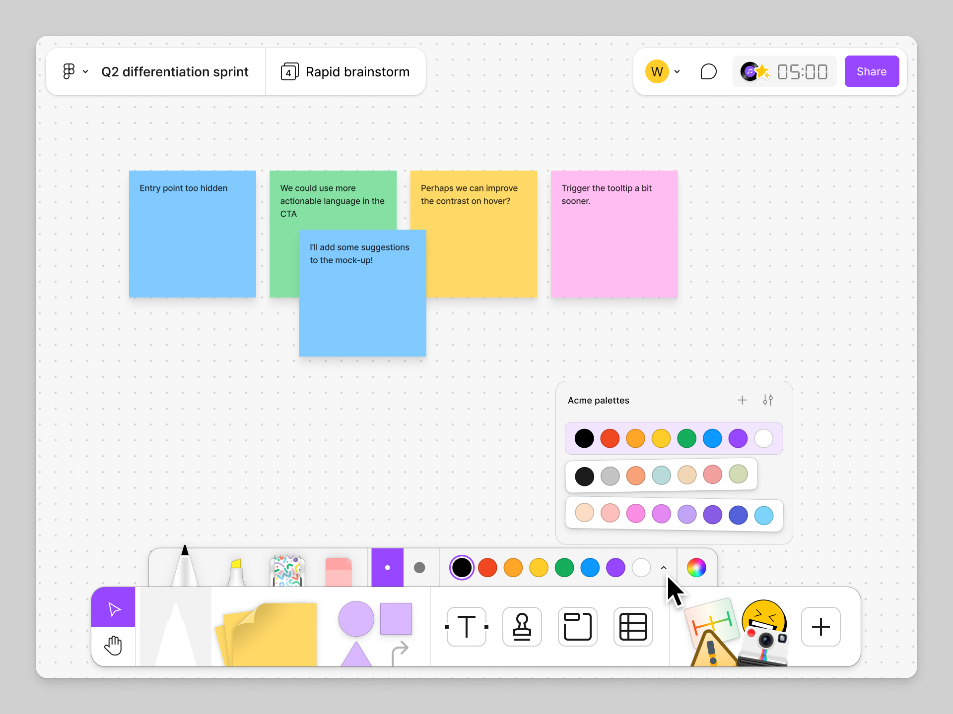

Custom color palettes
Members of an Organization or Enterprise plan with can edit access to the team or project can create custom color palettes for their FigJam files. You can create a palette with up to nine colors and set it as the default for all new team files, or swap between palettes in an existing file.
Custom color palettes can only be used in files that are in a team or project, not in drafts. Learn how to move files to a team or project →

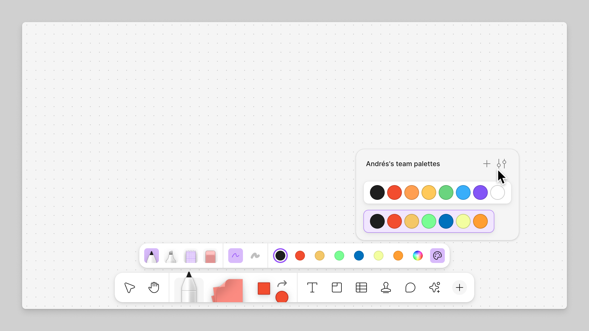

Create a custom palette
To create a custom color palette in FigJam:
- Select the Marker, Sticky, or Shape tool.
- Click next to the current color palette.
- Click to create a new palette.
- Enter a name for the new palette.
- Select a color tile, then use the eyedropper tool or hex code field to select a new color. You can create up to nine colors per palette.
FigJam may lighten palette colors on stickies and highlights for better legibility and accessibility. This could result in different palette colors (such as black and dark gray) having the same variation for stickies (light gray). When this happens, FigJam will consolidate colors of the same variation into one, so it’s possible the number of colors you see in the color menu differs from the custom palette you created.

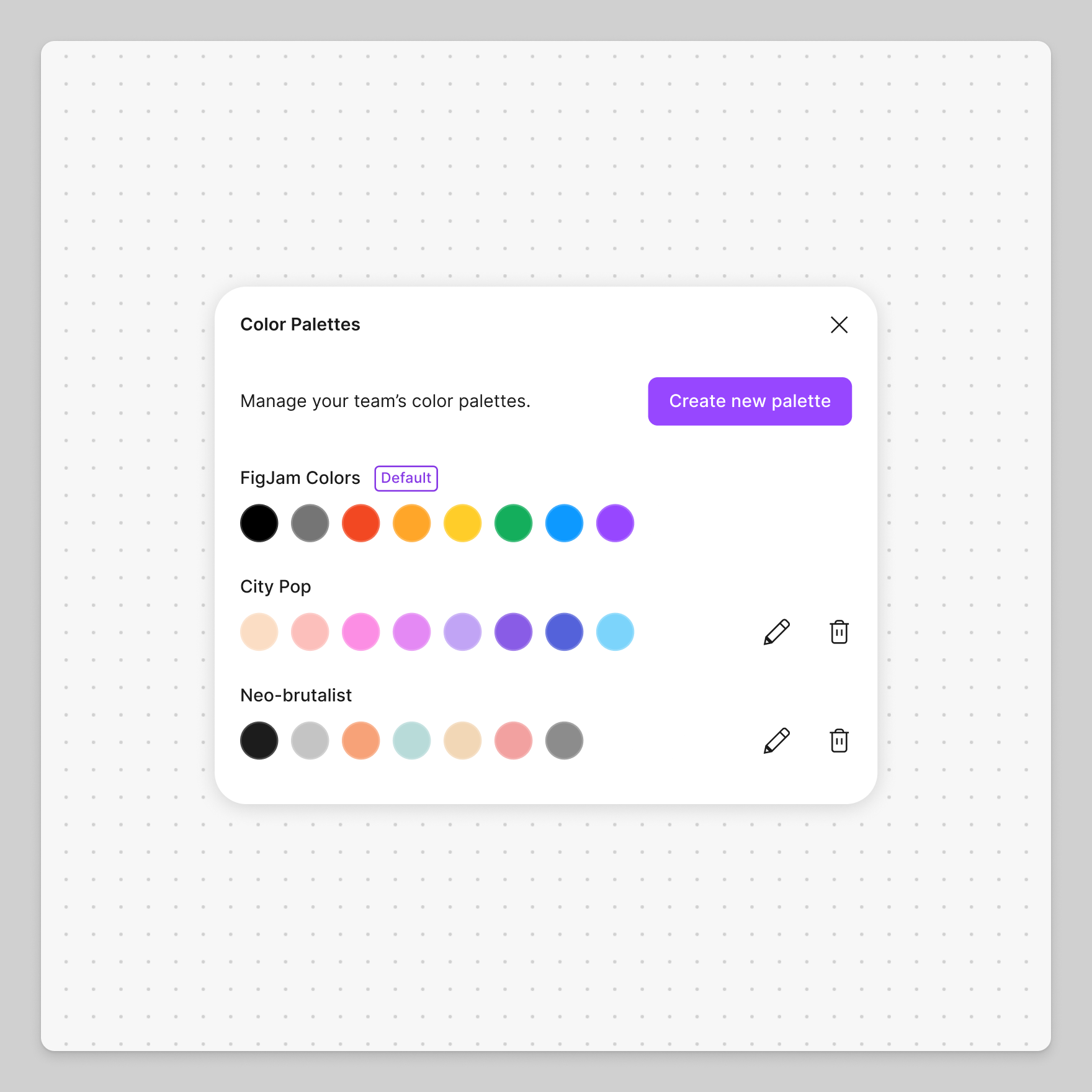

Set custom palette as default
Once you create a custom palette, you can set it as the default color palette for your team from the team settings page.
- If you're on the Starter or Professional plan, click All projects. If you're on the Organization or Enterprise plan, navigate to the team where you'd like to set a custom palette as default.
- Click the down arrow icon next to the team name and select View settings.
- Under the Shared section, click View team’s FigJam palettes.
- Click Set as default next to the palette you want to use.
The palette will be used as the default for new files in the team. For existing files, you’ll need to swap to a new custom palette ↓
Learn more about managing team settings →
Swap between palettes
When you’re in a FigJam file, you can swap between palettes at any time.
- Click the custom palette you want to use from the picker.
When you select a new palette, any existing objects on the board will retain their original colors. You can edit their color at any time.
Edit custom palette
To edit a custom palette:
- Click from the Marker, Sticky, or Shape tool.
- Click in the custom palette picker.
- Click next to the palette you want to edit.
- Select the color you want to edit or hover over the color and click to remove it from your palette.
Delete custom palette
To delete a custom palette:
- Click next to the palette you want to delete.

Shapes
You can change the color and opacity of shapes in FigJam.
To set the color of a shape before placing it:
- From the toolbar, click shape tool > color picker from the menu.
- Select a color from the default color palette.
- Click anywhere on the board to place the shape.
Once the shape is on the board, select it to open the toolbar. From the color picker in the toolbar, you can:
- Set the shape fill to Fill, No Fill, or Transparent
- Select the Custom option to set a custom color and opacity level
- Select or remove the line style and color for the shape's border
Modifying the color of a shape on the board changes the default color of the Shape tool in the toolbar. It does not affect the color of shapes already on the board.
Just like sticky notes, the new default color will be applied to all future shapes until the color is changed again.
Learn more about creating and editing shapes →

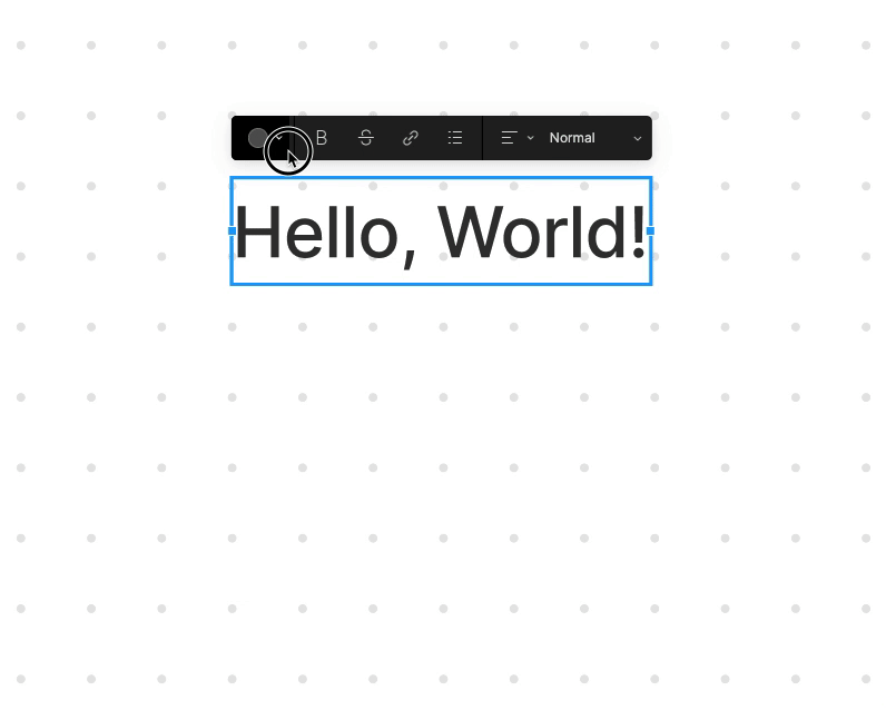

Text
Unlike the text in shapes, stickies and connectors, text created with the Text tool can take on different colors. However, changing the color of one text object will not apply the same styling to future text objects.
Attempting to change the color of a substring within a text object will modify all text color in the same object. The default color for a new text object is always Charcoal.
Learn more about the Text tool in FigJam →
