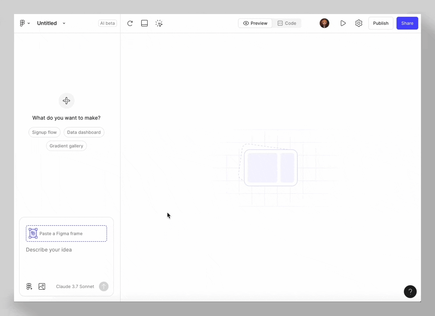

To create a functional prototype, web app or interactive UI with Figma Make:
Create a Figma Make file. In the file browser, navigate to your drafts. Then, in the upper-right corner, click Make.
Tip: You can also use Figma Make templates that are available to you to get started.
- In the AI chat, tell the model what you’d like to build by typing in the text field or pressing to dictate your prompt. You can do one or more of the following to guide the AI:
- Attach Figma designs.
- Bring style context from one of your Figma Design libraries. (Paid plans only)
- Add a backend to securely store and manage data and secrets.
- Paste frames from Figma designs and images directly into the chat.
- Get context from external tools using MCP connectors.
- Enter your ideas and instructions in the prompt box or press to dictate your prompt.
- Search the web or fetch content from a URL to bring live, external information into your prototype.
- Click Send.
After you send your prompt, Figma Make starts generating the code for your functional prototype or web app. Depending on how complex the end result is, it may take a few minutes for Figma Make to finish generating the code. As it works, a to-do list may appear in the chat, tracking the steps Figma Make is working through in real time.
When the process is complete, Figma Make will respond with a summary of the changes, and an interactive preview appears.

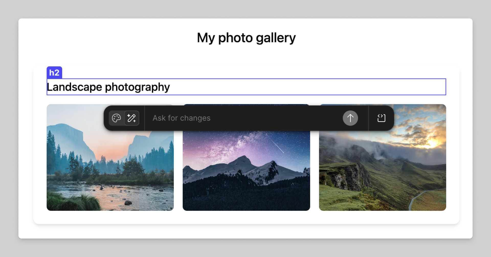

Point and edit tool
The Point and edit tool lets you point to elements in your functional prototype or web app. Depending on the type of element and the way it was generated, you can modify different properties, such as colors, padding, margins, text styling, and more. You can also prompt the model to make changes directly to that element.
To use the Point and edit tool:
- At the bottom of the prompt box, click Point and edit.
- In the preview, click the element that you want to modify.
- Make changes using the toolbar.
- Optionally, click and prompt the model to make changes to the element you selected.
The exact set of properties you can edit depends on the type of element you’ve selected. Some elements may have a mix of the properties described below.

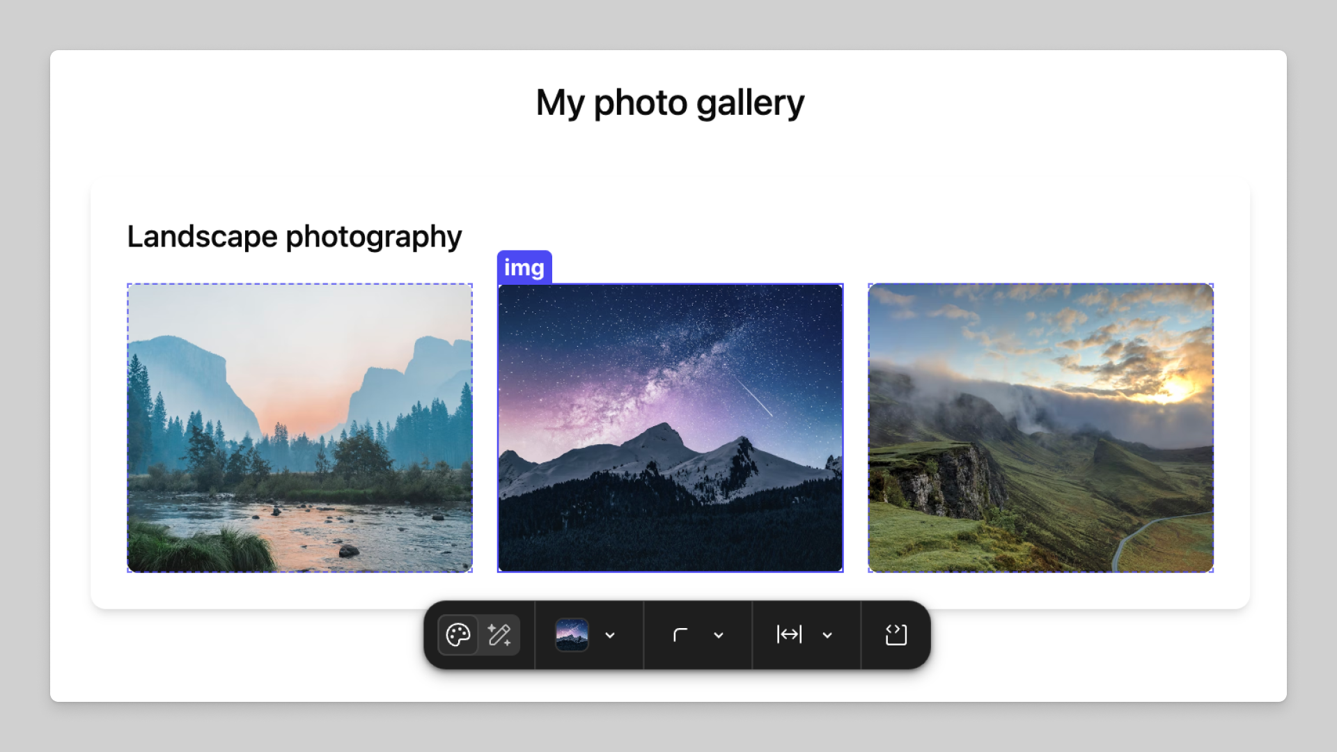

Edit images
When you edit an image, you can:
- Upload a new image to replace the existing one
- Change the border radius
- Change the spacing around the image (the margins and padding)
- Go to the source code
- Delete the selected image

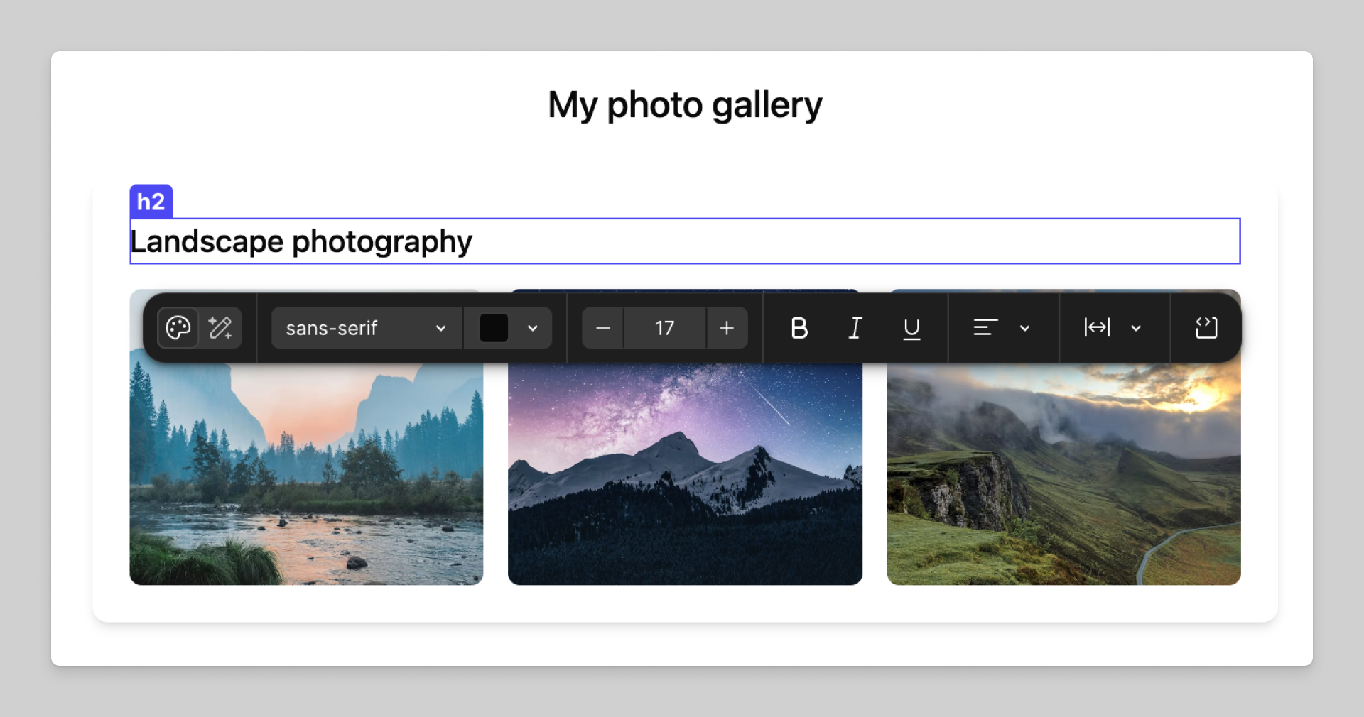

Edit text
When you edit an element that contains text, such as a paragraph or heading, you can:
- Edit the text by double-clicking it
- Switch between open source Google fonts
- Change the text color
- Adjust the size of the text
- Make the text bold
- Italicize the text
- Underline the text
- Adjust the alignment of the text
- Change the spacing around the text (the margins and padding)
- Delete the selected text element
Note: Custom fonts aren't supported in Figma Make.

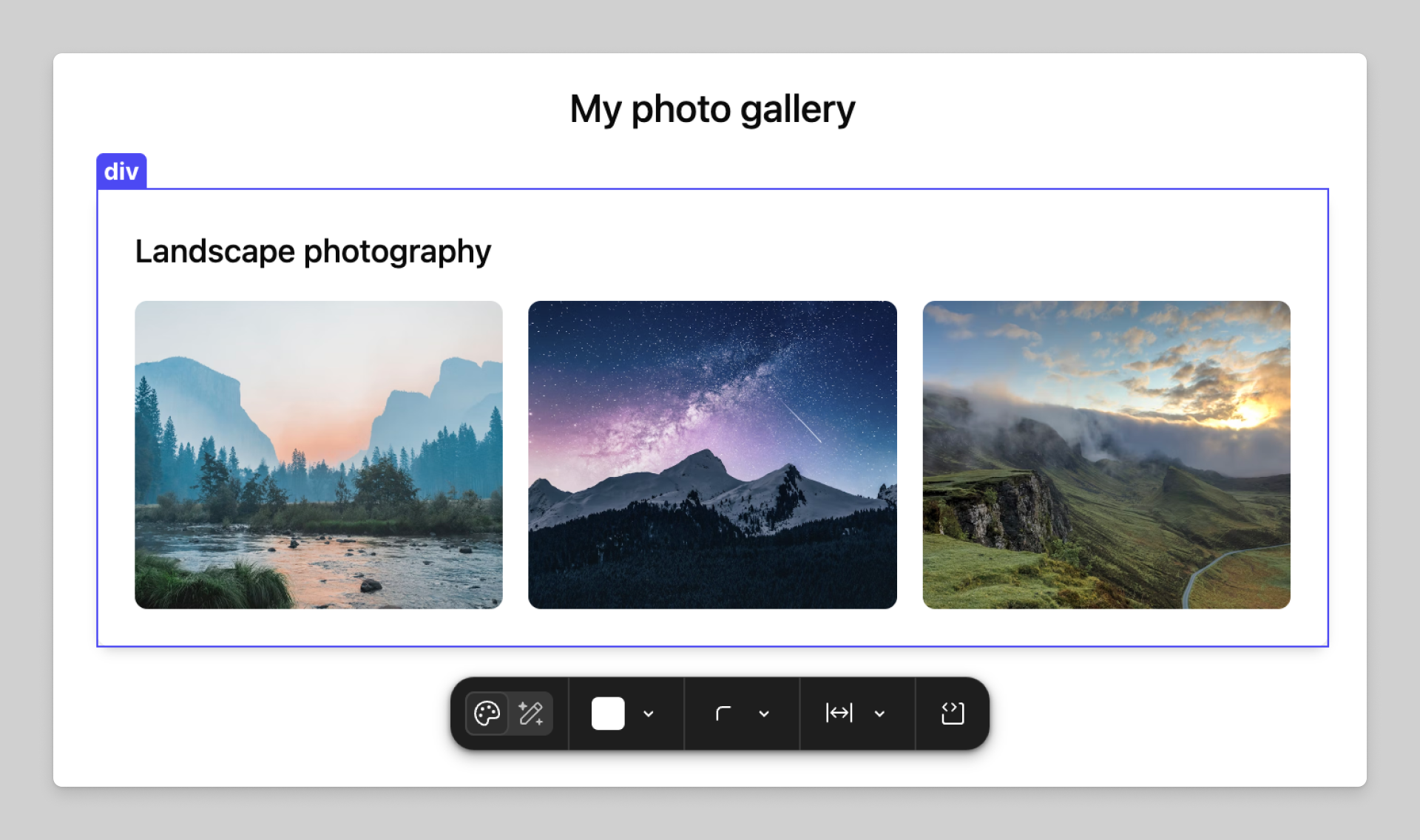

Edit containers
When you edit a container element, such as a div or section, you can:
- Change the background color
- Change the spacing of the container (the margins and padding)
- Delete the selected container

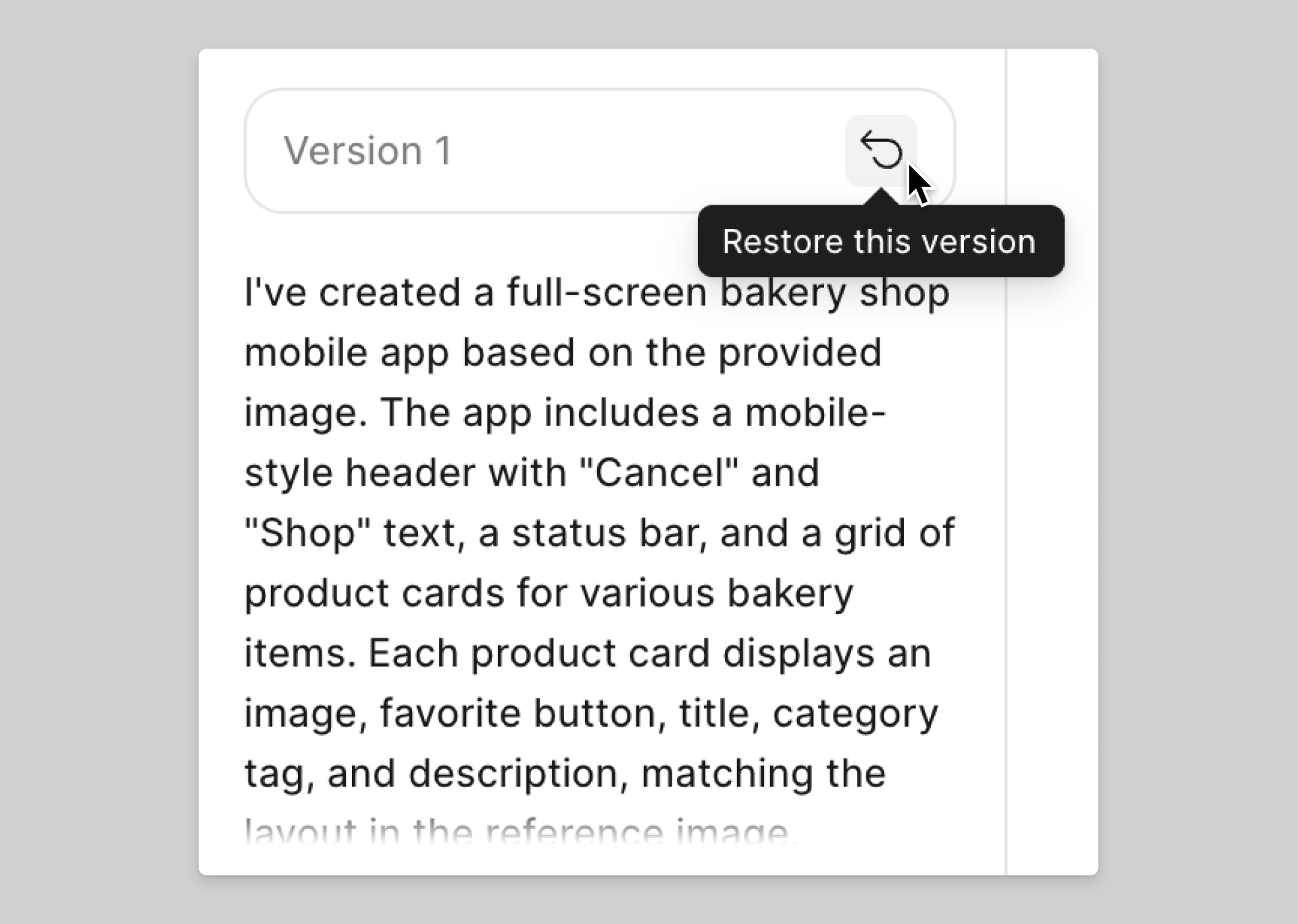

Interact with the file's version history
Figma automatically creates a new version when either you or Figma AI edits the file. Each version has a number and auto-generated name.
Click More options next to any version to:
- Preview version: Interact with that version of the file. Previewing doesn't create a new version and doesn't affect your current work.
- Favorite: Pin the version to the top of the version history list, which you can access by clicking the current version number at the top of the screen.
- Name this version: Give the version a custom name to make it easier to find later.
- Restore this version: Return your file to a previous version. Restoring a version doesn't delete any work—all versions, including those that came after the one you restored, remain available and you can switch between them at any time.
