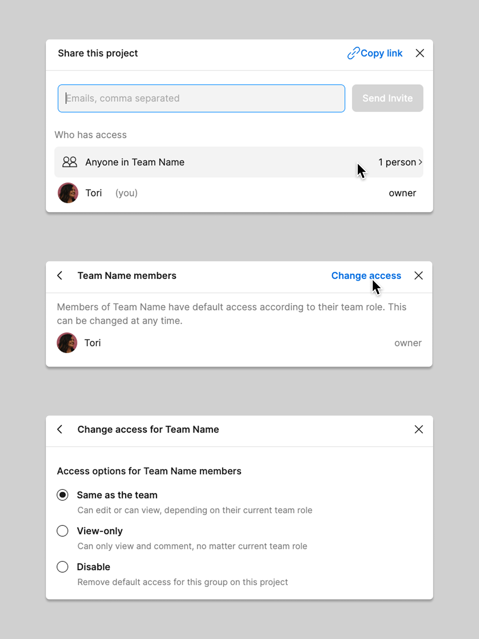

To change inherited folder permissions on the Organization or Enterprise plans:
- Open the folder share modal.
- Under Who has access, click the row showing the parent access (e.g. "People from…"). For nested folders, this will be the name of the parent folder. For top-level folders, this will be the name of the team or plan.
- Click Change permissions.
Select an option:
- Anyone in [NAME] inherits access: Users on this folder inherit their permissions from the parent folder, team, or plan.
- Only people added to [Folder name] can access: Limits access to directly invited people only
- Click Save.
