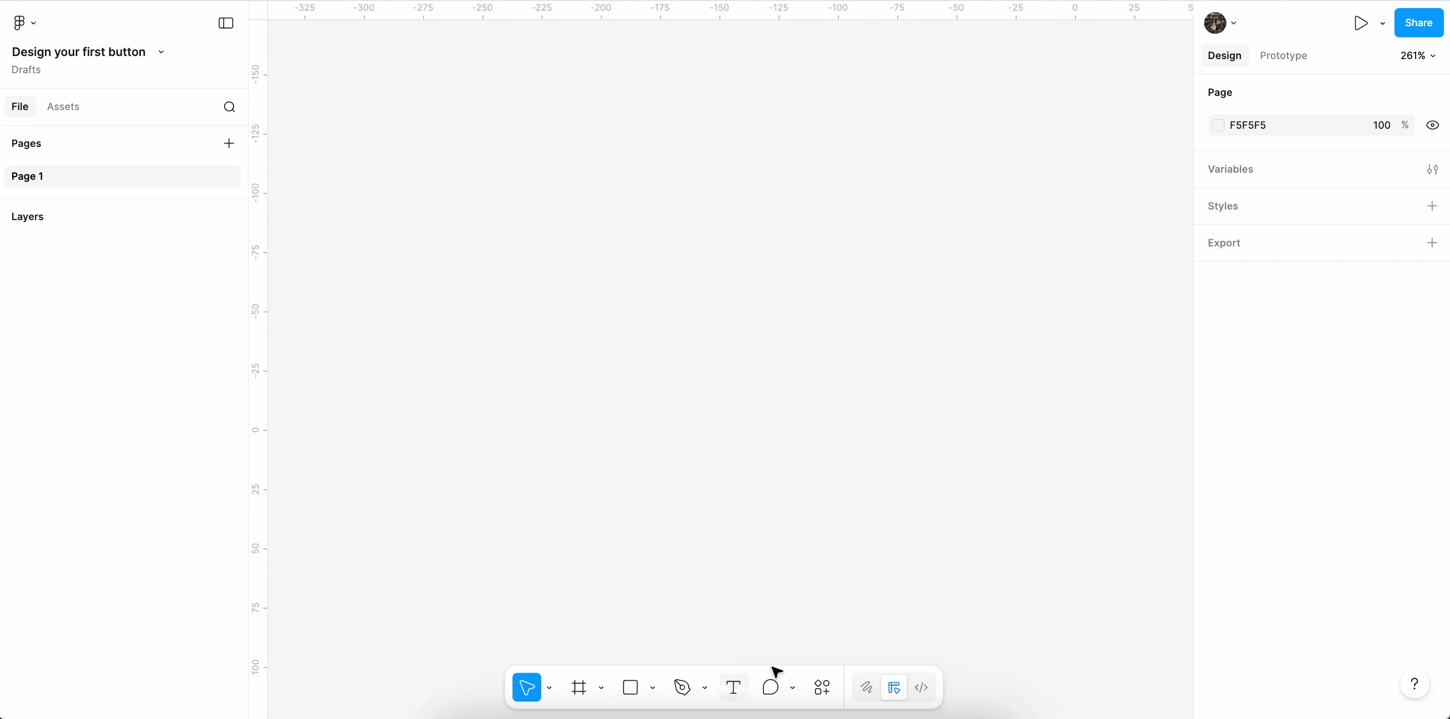

- Enable the Text tool from the toolbar or press T on your keyboard.
- Click anywhere on the canvas and type
Buttonto create a new text layer.
In the left sidebar, you’ll notice the Layers panel now has a new text layer called Button. Double-click on the layer and rename it to Label.

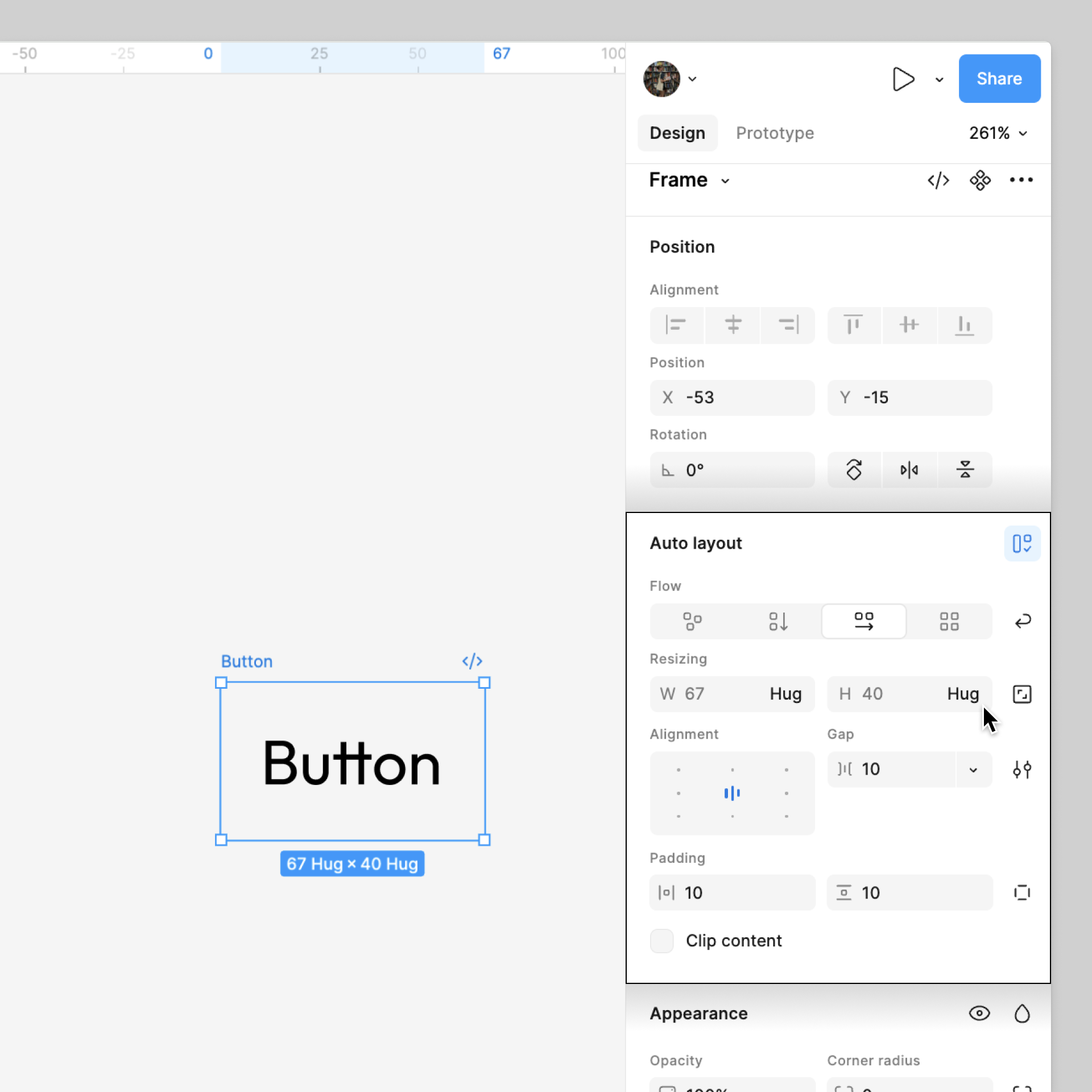

Apply auto layout
Our button isn’t looking too button-like yet, but we’re about to change that using auto layout!
Auto layout helps you organize, arrange, and space out design elements so that they adjust automatically as you make changes, saving you time and making your designs responsive and adaptable.
To apply auto layout:
- Select the
Labellayer. - Right-click on it and select Add auto layout or use the shortcut Shift A. This will add the text layer to a frame with auto layout applied.
- In the Auto layout section of the right sidebar, make sure the Horizontal resizing and Vertical resizing settings are both set to Hug contents. Setting the resizing to Hug contents ensures that the button frame will automatically grow or shrink when the label changes.
- Double-click on the new frame in the left sidebar and rename it to
Button.

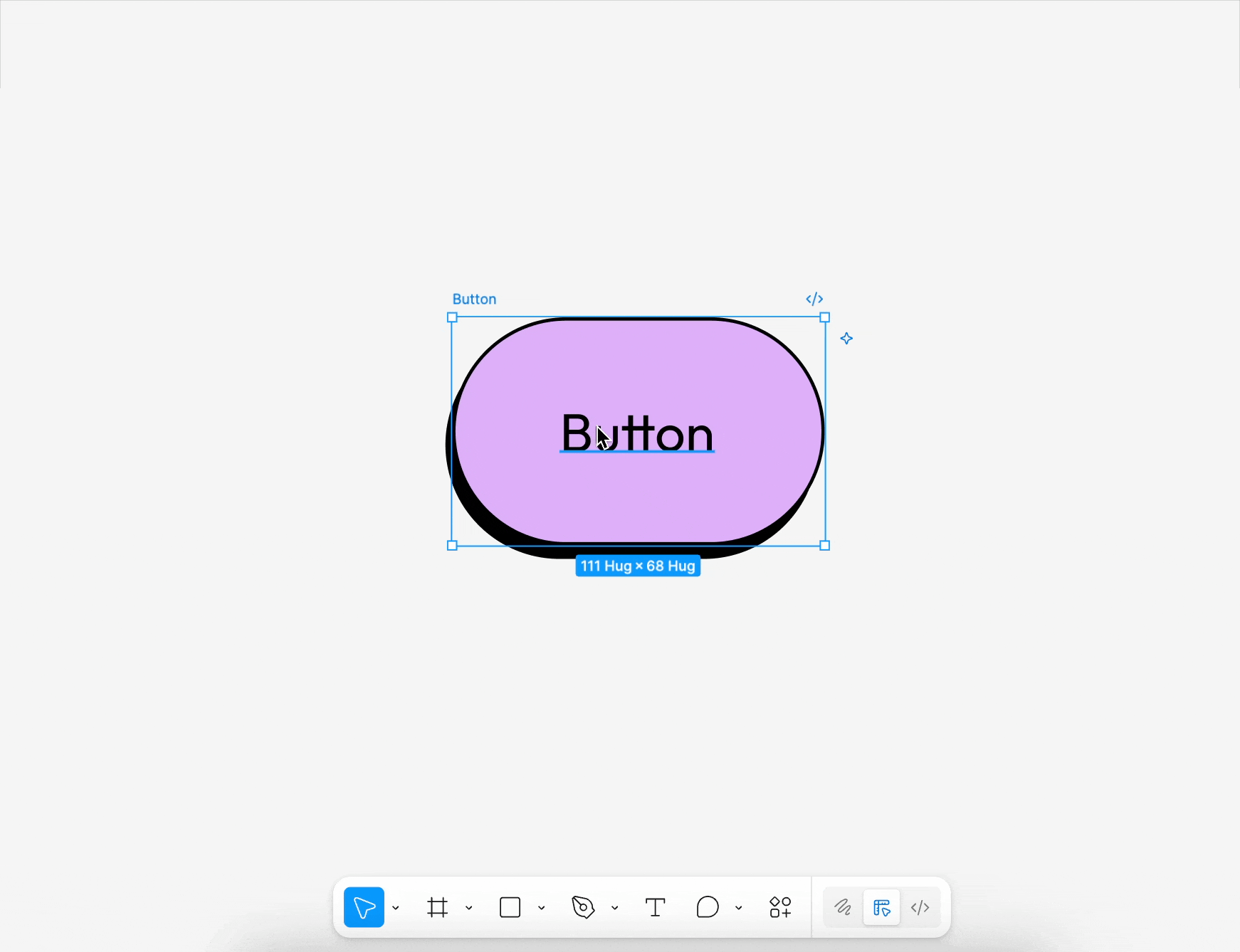

Style the button
When we applied auto layout, the existing text layer was added to a frame. This allows us to add visual properties like color, strokes, and effects to give our button some style.

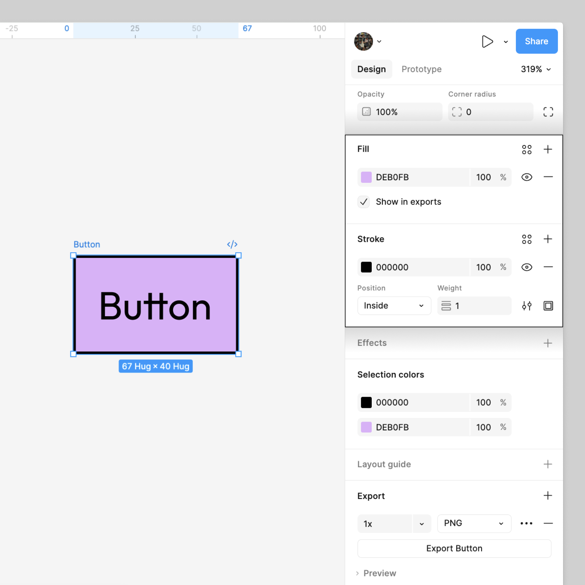

Add a fill and a stroke
- Select the
Buttonframe and click the plus in the Fill section of the right sidebar to add a fill. - Use the color picker to change the color to
#DEB0FB. - Click the plus in the Stroke section of the right sidebar to add a stroke.
- Use the settings to configure the stroke:
- Fill:
#000000 - Position:
Inside - Weight:
1
- Fill:

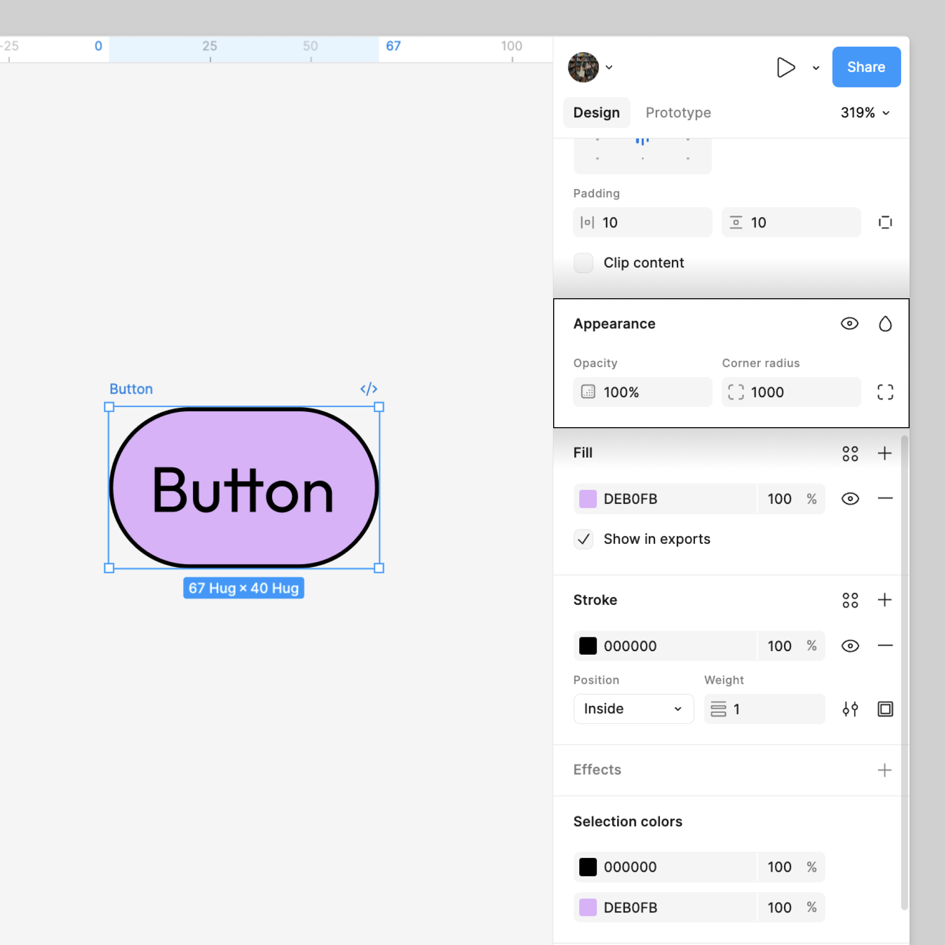

Round the corners
- Select the
Buttonframe. - In the right sidebar, set the Corner radius to
1000px.
Why round button corners?
Rounded corners may seem like a small thing, but it can have a large impact on the look and feel of your final designs. Rounded corners soften the aesthetics of your design, making it feel friendlier and more approachable than objects with sharp edges.
Beyond aesthetics, it’s common for interactive elements in modern digital interfaces to have rounded corners. This means that your users are more likely to understand that they can click your button if its design matches other interfaces they use.
To full round a frame’s corners, the corner radius value must be at least half the height of the frame. For example, if our frame was 40 px high, we’d need to set the corner radius to a minimum of 20 px to achieve fully rounded corners.
You may be wondering why we set the button’s corner radius to 1000 px when a lower value would produce the same effect. Using a higher corner radius value helps future-proof components and ensures that the corners stay fully rounded, even if the height of the frame changes later.

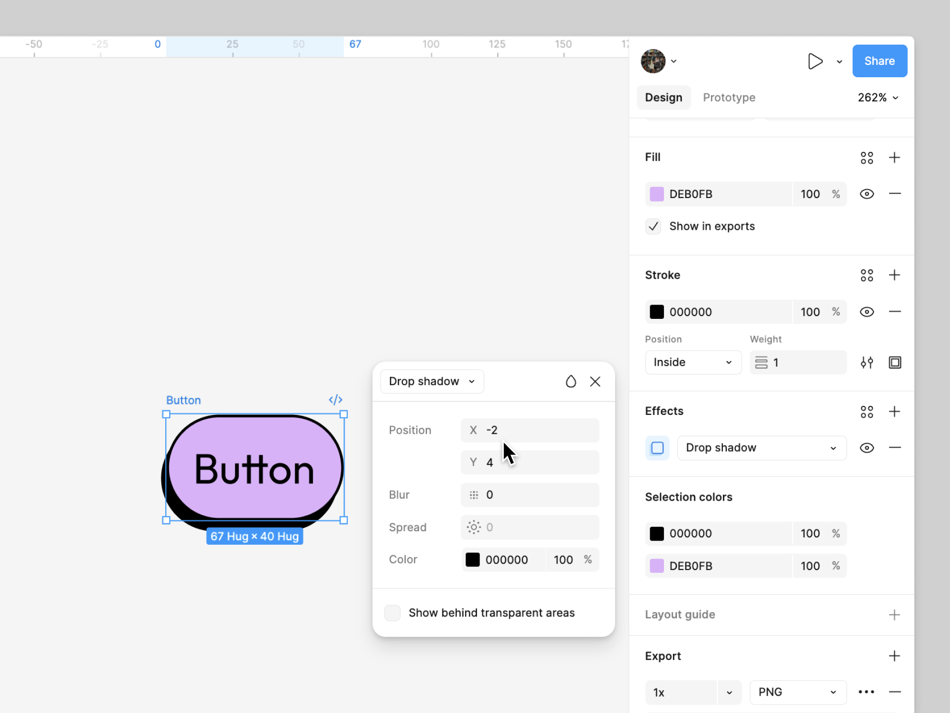

Apply a drop shadow
Applying drop shadows to buttons is an optional design choice, but one that can help enhance the clickable feel of a digital button.
To add a drop shadow:
- Select the
Buttonframe. - Click the plus in the Effects section of the right sidebar and choose Drop shadow from the dropdown menu.
- Use the settings to configure the drop shadow:
- X-position:
-2 - Y-position:
4 - Blur:
0 - Color:
#000000at100%opacity
- X-position:

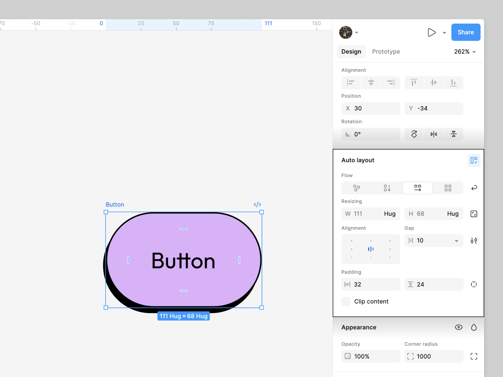

Refine the padding
When we applied auto layout, it automatically added padding between the frame’s boundary and the text layer inside. Right now, the padding is equal on all sides. Let’s update those values to create a chunkier button that will be easier to tap once we add it to our designs.
- Select the
Buttonframe. - In the Auto layout section of the right sidebar, change the Horizontal padding to
32and the Vertical padding to24.

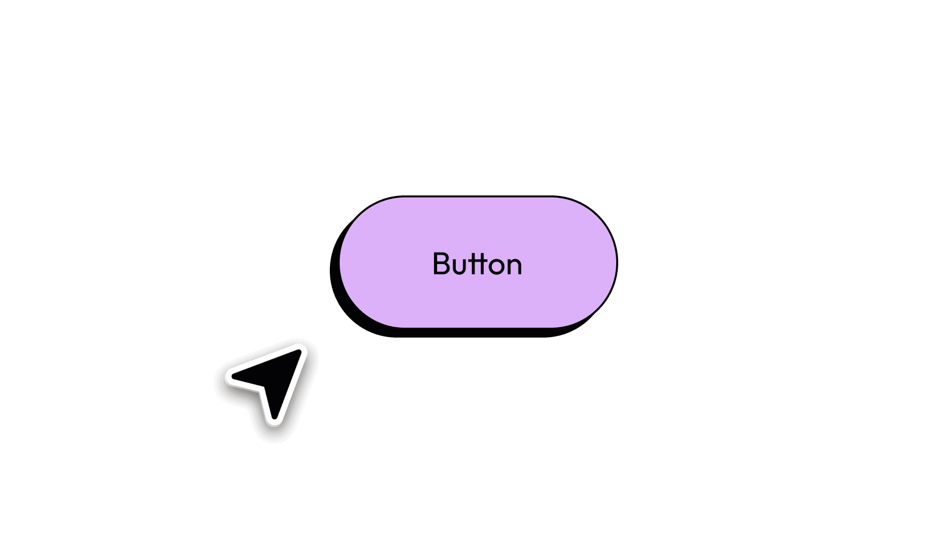

Test out your button
The button looks great! Best of all, because we used auto layout, the button will resize based on the length of the label inside it. Test this for yourself by double-clicking on the text layer and typing Sign up or Continue.
