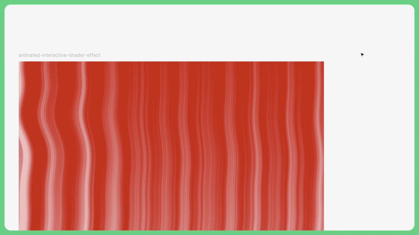

Run an animated or interactive shader
If the shader fill or effect is animated or has interactive capabilities, select the layer and click [icon play] Play above the top-right corner of the layer to run it. Only one animated or interactive shader can run on a page at a time.
