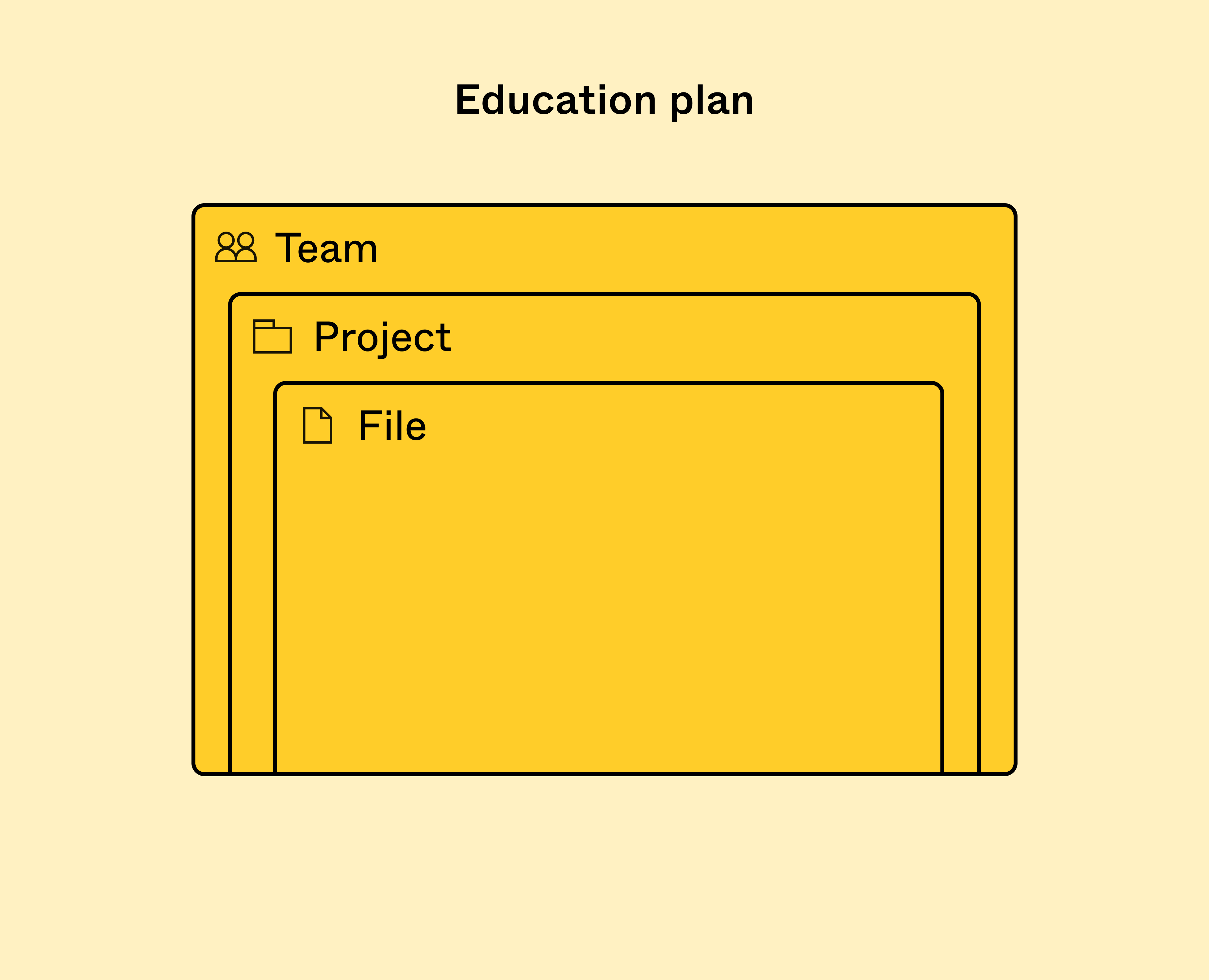

On the Education plan, you can share assets at three different levels: team, projects, and files. Read our Guide to sharing and permissions for more information on how sharing works in Figma.
